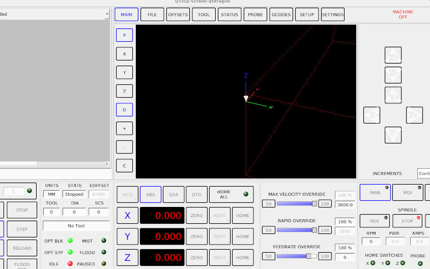

Hello,
I did a fresh install of LinuxCNC 2.8.2 Debian 10 Buster PREEMPT-RT ISO from here:
linuxcnc.org/downloads/
then I run the install script from this thread
forum.linuxcnc.org/qtvcp/38414-installing-qtvcp?start=0
then I configured it to use QTdragon as described here:
linuxcnc.org/docs/2.8/html/gui/qtdragon.html
an, of course, I configured the ini file for my cnc mill.
Everything works fine, milling using Linux CNC is a dream:-)
My question is about the display style. I can see in qtdragon pictures this very nice gray shaded 3D style.
But my screen looks just flat:
what am I missing to get this nice 3d stylish display ?
I tried a fresh installation on two different PCs but the result ist the same.
Thanks, Harry

27 Oct 2021 08:21 #224513
Replied by andypugh on topic QTdragon Style
It is probably the "theme" that you have selected.
www.linuxcnc.org/docs/devel/html/gui/qtdragon.html#_styles

27 Oct 2021 13:39 #224530
by persei8
Replied by persei8 on topic QTdragon Style
Press F12 and a style dialog should pop up. Then Open a qss file and Apply. Qtvcp comes with some predefined stylesheets that you can copy to your config folder if you want to further customize them.

28 Oct 2021 05:12 #224559
by harry4516
Replied by harry4516 on topic QTdragon Style
thanks,
I read about F12 in the link shown by andypugh.
Nothing happens if I press F12,
but the question is:
I did a fresh install of the iso image on the Linux CNC website and followed the description above.
So, everyone doing that, should get the same result? Or does it depend on the hardware, I don't think so.
Is something missing in the ISO file or in the description, if yes, what is it?

28 Oct 2021 19:48 #224620
Replied by cmorley on topic QTdragon Style
try pressing f12 after pressing other buttons - you need to have focus on the screen for it to work.
The style you have is the default style. You must set what ever style you wish to use after it starts with the dialog that shows with f12.

30 Oct 2021 12:43 #224722
by harry4516
thanks a lot for the hints.
Pressing F12 did the trick.
The problem was, my wireless keyboard has an F12 key, but nothing happend. After connecting a normal USB keyboard, F12 worked.
