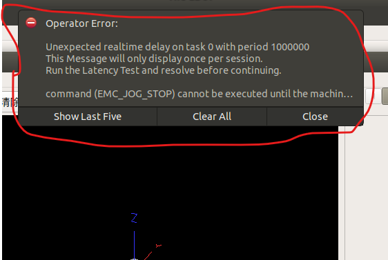

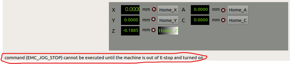

How to output things in the statusBar bar

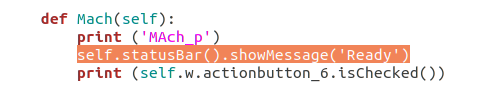

05 Nov 2021 12:25 #225415
Replied by cmorley on topic How to output things in the statusBar bar
Depends what it's called in designer, but roughly this for the status bar:
self.w.statusbar.showMessage(message, timeout * 1000)
STATUS.emit('error', linuxcnc.OPERATOR_ERROR, 'message')
in master also:
ACTION.SET_DISPLAY_MESSAGE('MESSAGE')
ACTION.SET_ERROR_MESSAGE('MESSAGE')
in master also:

I didn't add a status bar in my designer, and I don't know its name, but when I started it, the status bar existed. I don't know how to use the status bar, because I also want to output something in the status bar. I hope you can help me solve it. Thank you for your help
it you start with a mainWindow, statusbar is added automatically and is called stausbar
try:
self.w.statusbar.showMessage('My message', 8000)
try:

OK, thank you very much. I tried your method. Now I can output something on the status bar.
