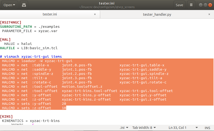

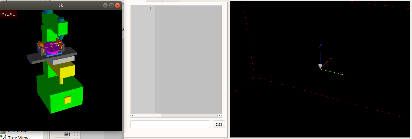

Hello, I want to use five axis motion now. I use the five axis configuration of linuxcnc to configure my program. I only modified the called Python program, but after the modification, its track is not displayed in my program, but in another program interface. I don't know why. I hope someone can help me. This is my INI file. I refer to the / configurations / SIM / axis / vismach / 5axis / table rotary tiling / xyzac-trt.ini file

Home is no different. It can still be home, but the value and track of the axis are not displayed in the track interface, but the data position of the axis is displayed in the drolabel. It should be the INI file, but I don't know much about it. Do you have a 5-axis ini configuration example for me to refer to? Thank you

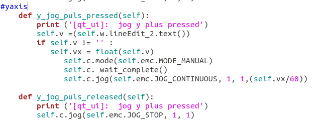

10 Nov 2021 21:09 #226057
Replied by cmorley on topic On the wrong configuration of five axis motion
homed jogging is different from unhomed jogging.
I would suggest you use the ACTION library's jog or do_jog for jogging.
Or look at that code for guidance.

17 Nov 2021 02:35 #226711
by yi2580
Replied by yi2580 on topic On the wrong configuration of five axis motion
Yes, I now know that only after all axes are home can I run my jog motion correctly. Before I had all my homes, I felt that my jog movement was very abnormal. Now I use ptvcp action.
