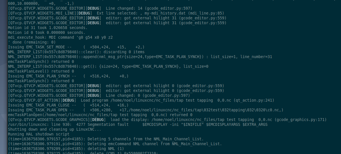

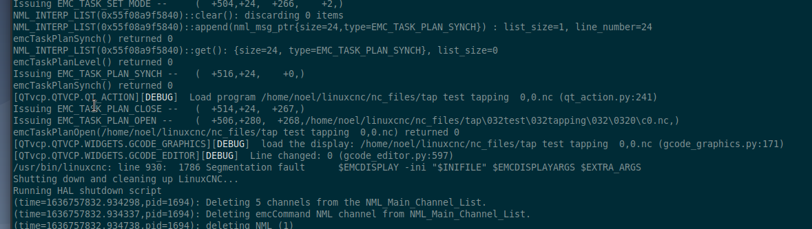

I'm working on using qtdragon. slightly modified to fit my screen, and added a few hal pin displays. nothing to wild.
well, using it today. CRASH, twice. same thing.
Segmentation faults.
see the pics.
Loaded a simple, short file. Edited it an external editor (pluma). Touched the 'reload' button, and wam. crash.
did this twice.
not sure what's up...........
any clues.??????
see the pics.
did this twice.
any clues.??????

I wonder if it's because your filename uses spaces?
Or try a different external editor ( adds bad line endings?)
Otherwise there is not enough info to draw any more troubleshooting idea.

cmorley,
thanks for the quick look over.
what additional info is needed?
also, a seg fault has always been pretty serious to me.... usually causes a BSD.
and seriously, spaces in a file name as a cause? thought that went away back in the '90s.
I've been using pluma for a couple of years and never had an issue with axis. before that it was gedit, which is unfortunately pretty much gone.
I think i'll try the linux install of notepad++ (yeah, it exists)
by the way, my velocity and ferror display works fine.....thanks.

Replied by cmorley on topic Dragon crash......
you could run qtvcp with the -d or -v switches for more degug detail.
Toy could try to find someway to make the error consistant and repeatable.
ie a particular program loaded does it - then upload that program.
You could try my suggestion about spaces in the file because it's easy to test.
You could see if it crashes on the sim config too.
If you have been using pluma for a while then it's probably not that.
If the problem is intermittent then it's the hardest type to fix.
Chris
