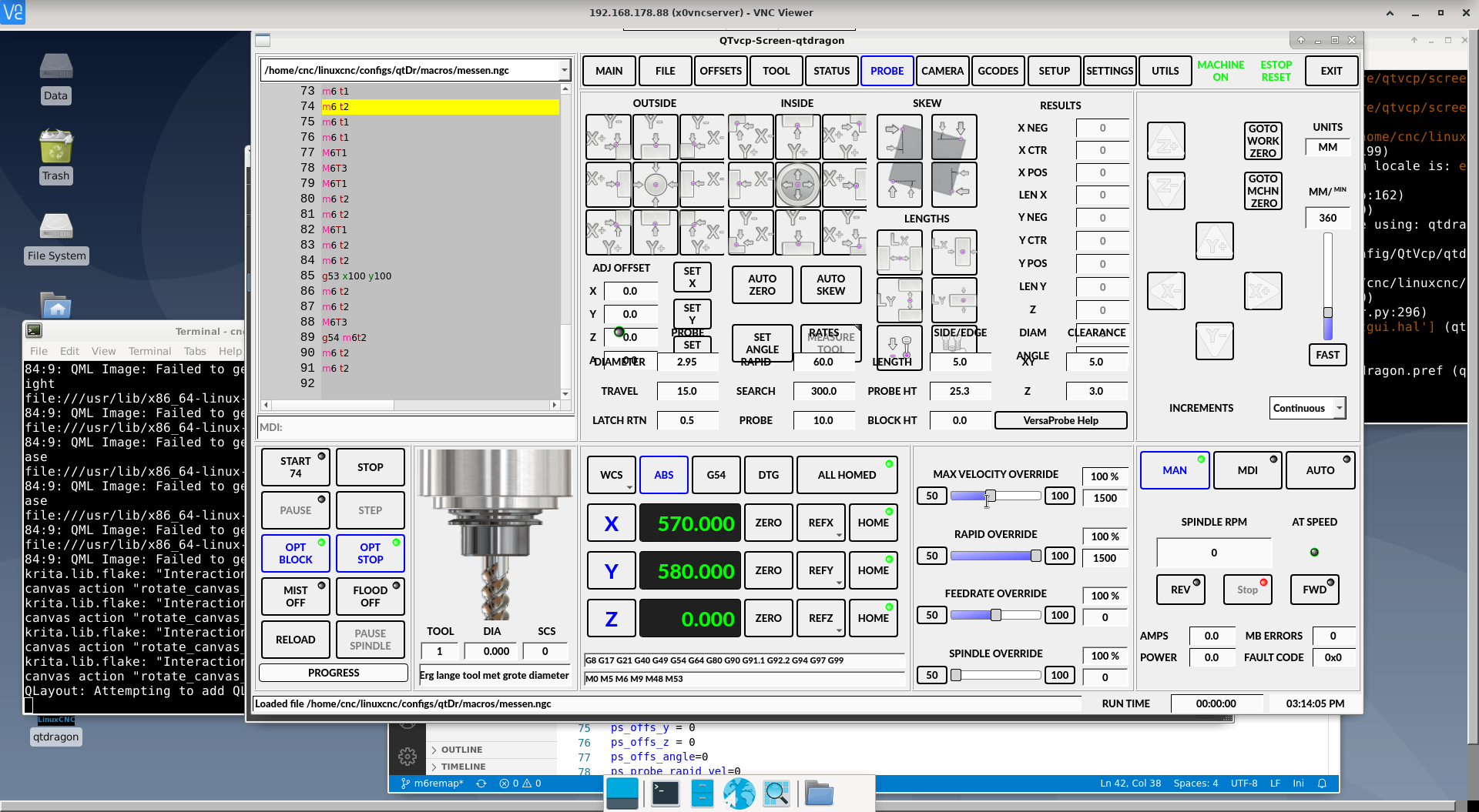

[fixed] qtDragon font is to big for VersaProbe dialog

The font is OK, it's the window that is too small. What is the size of your VNC window? The non HD version needs to be 1440 x 900 minimum.

17 Nov 2021 12:41 - 17 Nov 2021 12:41 #226772
by ikkuh
Replied by ikkuh on topic qtDragon font is to big for VersaProbe dialog
As you can see by the scroll bars on the VNC window the resolution is fine, I normaly run qtDragon_hd. 1920*1080. So the resolution part is not the problem. And it's only the VersProbe tab that acts weird. I tried all the stylesheets using F12, nothing makes it look right.The font is OK, it's the window that is too small. What is the size of your VNC window? The non HD version needs to be 1440 x 900 minimum.

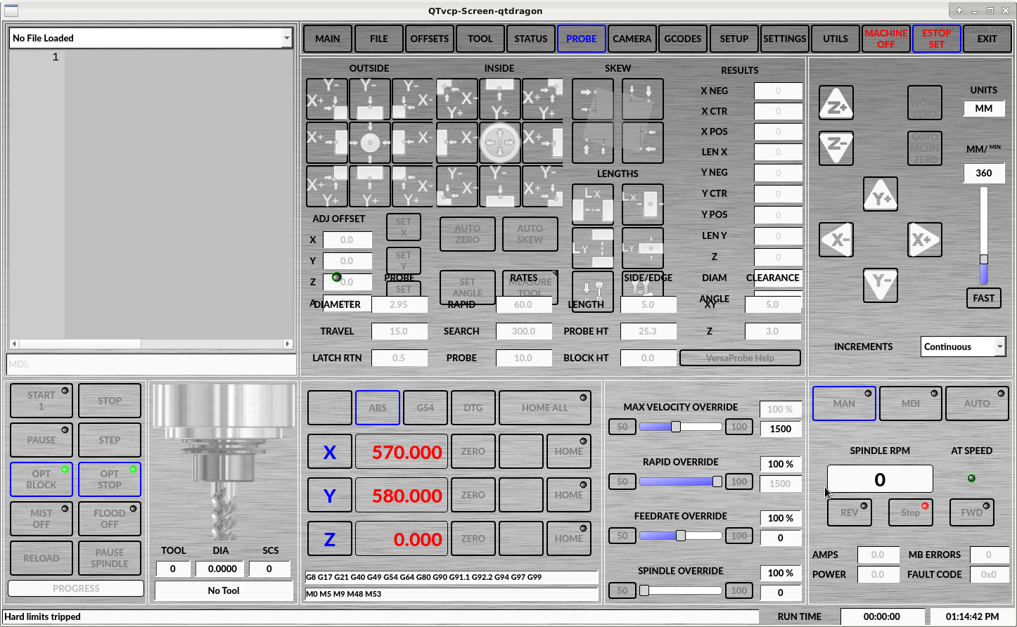

17 Nov 2021 13:19 #226774
by persei8
Replied by persei8 on topic qtDragon font is to big for VersaProbe dialog
"the characters do not fit into the buttons"
What I see is that the button text fits in the buttons, but the layout area for the probe screen is too small to fit all the widgets without overlapping. Do you get the same behavior when viewing directly on a monitor?

17 Nov 2021 19:20 #226816
Replied by cmorley on topic qtDragon font is to big for VersaProbe dialog
Adjusted versa probe widget in master to adapt more.
Try it out now.
Try it out now.

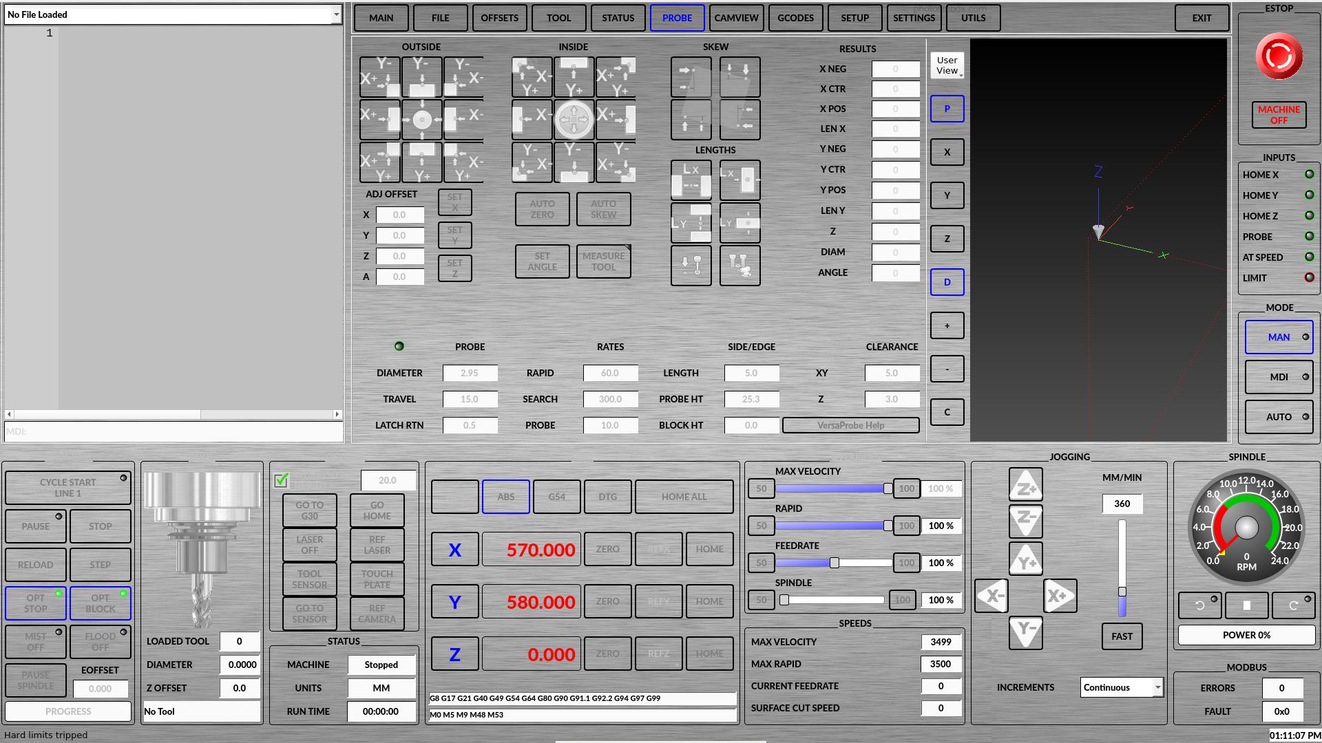

18 Nov 2021 06:23 #226858
by ikkuh
Great it is ok now. Thanks!Adjusted versa probe widget in master to adapt more.
Try it out now.
Time to create page: 0.390 seconds
