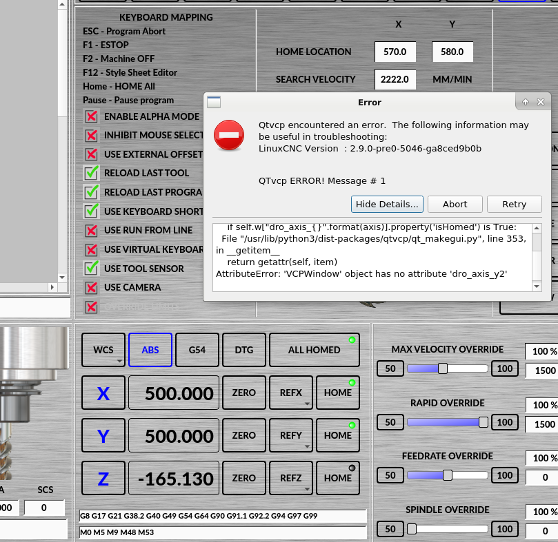

I have a gantry type cnc, 2 joints for the Y axes. If I try to re-home the Y axis then I get the following error:
File "/usr/share/qtvcp/screens/qtdragon/qtdragon_handler.py", line 598, in btn_home_clicked
if self.w["dro_axis_{}".format(axis)].property('isHomed') is True:
File "/usr/lib/python3/dist-packages/qtvcp/qt_makegui.py", line 353, in __getitem__
return getattr(self, item)
AttributeError: 'VCPWindow' object has no attribute 'dro_axis_y2'

I have 2 y axis and get the same error. I can home all with no issue. If I home just x I cant move anything but x until I home all again. Homing y or z crashes with the above error.

I updated the dragon code to fix this error in master branch.
Did you update lately?
Switching to a XYZY config rather then a XYYZ config would fix it too.

I haven't back ported the fixes to 2.8 so no not so easy.
changing to XYZY requires INI and a HAL file change.
