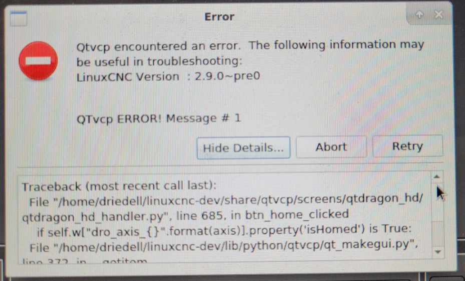

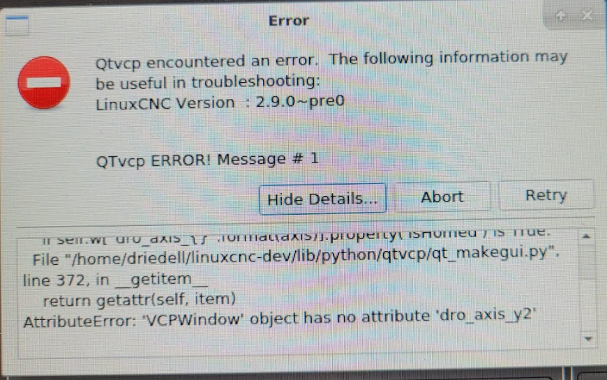

Digging into this, it looks like the offending code is originating here in qtdragon_hd_handler.py:
def btn_home_clicked(self):
joint = self.w.sender().property('joint')
axis = INFO.GET_NAME_FROM_JOINT.get(joint).lower()
if self.w["dro_axis_{}".format(axis)].property('isHomed') is True:
ACTION.SET_MACHINE_UNHOMED(joint)
else:
ACTION.SET_MACHINE_HOMING(joint)
I'm not sure where it's getting 'y2' from. In the qtdragon_hd.ui file I see references to dro_axis_x, dro_axis_y, dro_axis_z and dro_axis_a.
My machine is a dual-Y gantry, but in my .ini file they're just listed as AXIS_X, AXIS_Y, and AXIS_Z, and JOINT_1 through JOINT_3.

try changing the code to this
if STATUS.is_joint_homed(joint) == True:
else:
