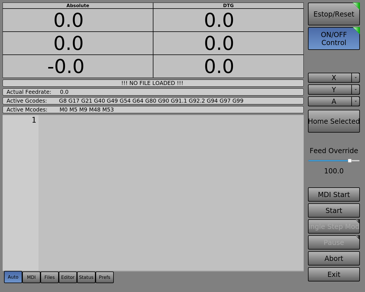

Why I have to reload *.ngc program every time I home axis? I use modificated QtTouchy and everytime I home single axis (I have to home X axis on every piece) I need to reload .ngc file otherwise start button is inactive. Any solutions?

Mostly because it's not expected that you would need to home every time you need to run the program. Should probably fix that.
I'll look into the button logic when I'm free to see if I can make that better.
What did you modify in qttouchy?

Ahh looks good.
Are you using linuxcnc 2.8 or 2.9?

When you say start button, you mean an on screen (actionbutton) start button?
Is the button greyed out (disabled) or just doesn't start the program running.

Hi, yes I mean actionbutton "start". It is shaded and inactive.
I use 2.9.0 + Mesa 7i97 (ethernet+analog)
