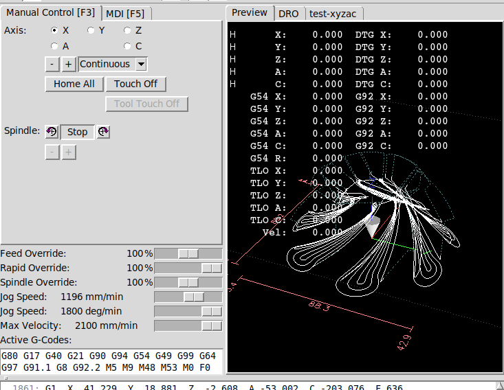

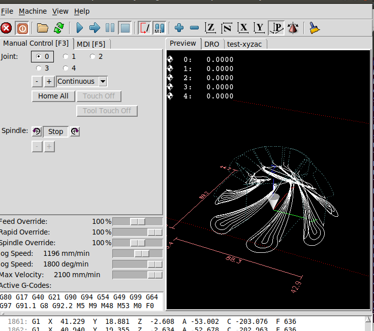

First of all, thank you for your answer, but I want to go from xyzac displaying axis to joint 01234

Replied by tommylight on topic How can I disable the remote operation mode and switch the interface
Oh, just noticed, those are both homed machines !
Besides not being the same version, i have no idea.
Are they the same version ?

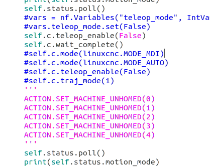

I use Linux CNC2 9. Now I am using qtvcp in qtpy to edit the UI interface, but now I want to switch the remote operation mode. After switching, my track interface has not changed. I want to know how to correctly close and open the remote operation interface and change its track interface

You are not using Qtaxis ? You have built a custom screen?
Not sure what you mean: 'remote operation mode'
You seem to imply that you want to switch from joints to axis mode?
Can you explain your use case?
'track interface' : do you mean the graphics screen DRO?:

Yes, I have established a custom screen. I really want to switch from axis mode to joint mode. His 5axis linkage algorithm, but sometimes I don't want to use the 5axis linkage algorithm. I just want to move with single axis jog, but now when I move with single axis jog, other axes will follow the linkage, so I want to switch to disable remote operation mode, Thus, only one shaft is moved and other shafts are not linked.
This is the function I use to switch remote mode

Replied by cmorley on topic How can I disable the remote operation mode and switch the interface
Ok I pushed some work to master to help with this.
If your INI has this:
[KINS]
# Note: coordinates must agree with [TRAJ]COORDINATES
KINEMATICS = kinstype=BOTH
Then joint mode should display untill homed.
I haven't got the switching part working in my test config - but you are on the right track.
[KINS]
