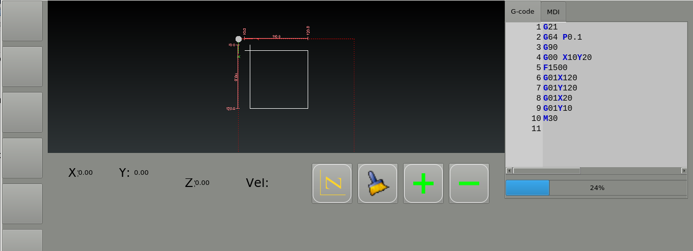

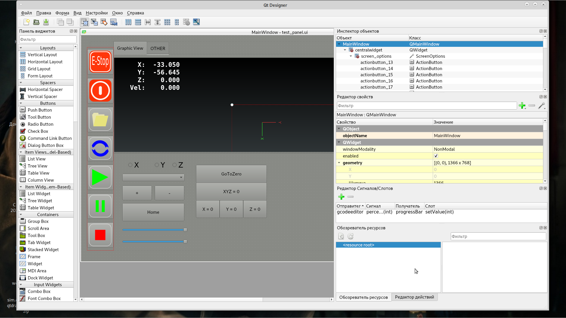

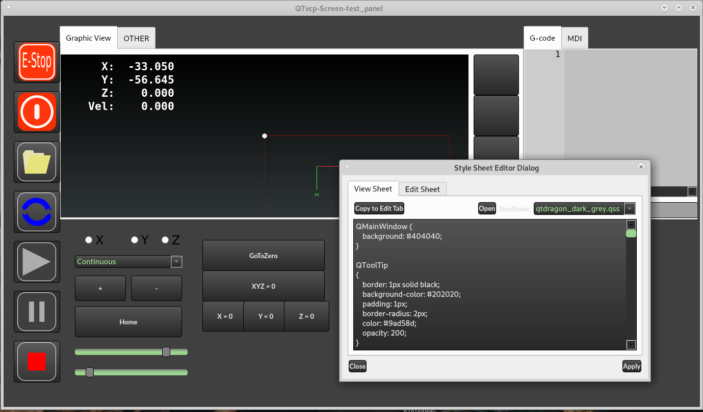

Hello. I cannot figure out the problem of displaying pictures attached to ActionButtons. These pictures are displayed or not. how to do it correctly so that the pictures are guaranteed to be displayed?
This is what the interface looks like in QtDesigner:
This is what it looks like after loading the configuration

is this
../../../Рабочий Ñтол/test/img/zoomplus.png
really the path name?
<normaloff>../../../Рабочий Ñтол/test/img/zoomplus.png</normaloff>../../../Рабочий Ñтол/test/img/zoomplus.png</iconset>

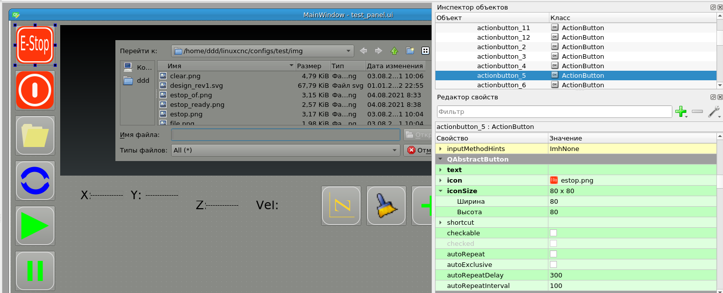

Greetings. relative path to image files: ./img. Full path to image files: /home/ddd/linuxcnc/configs/test/img/

Well it looks like something went wrong as thats a pretty odd looking path.
Try editing the file to the right path and see what happens.
Make a back up though

Open any file with F12. qss or create your resource and style files. Take a close look at how this is done in qt_axis.

Именно на примере qt_axis и пытаюсь разбираться. Скопировал кнопки которые не теряют картинки и переназначил на них действия и картинки. Вроде все запускается и не теряется
