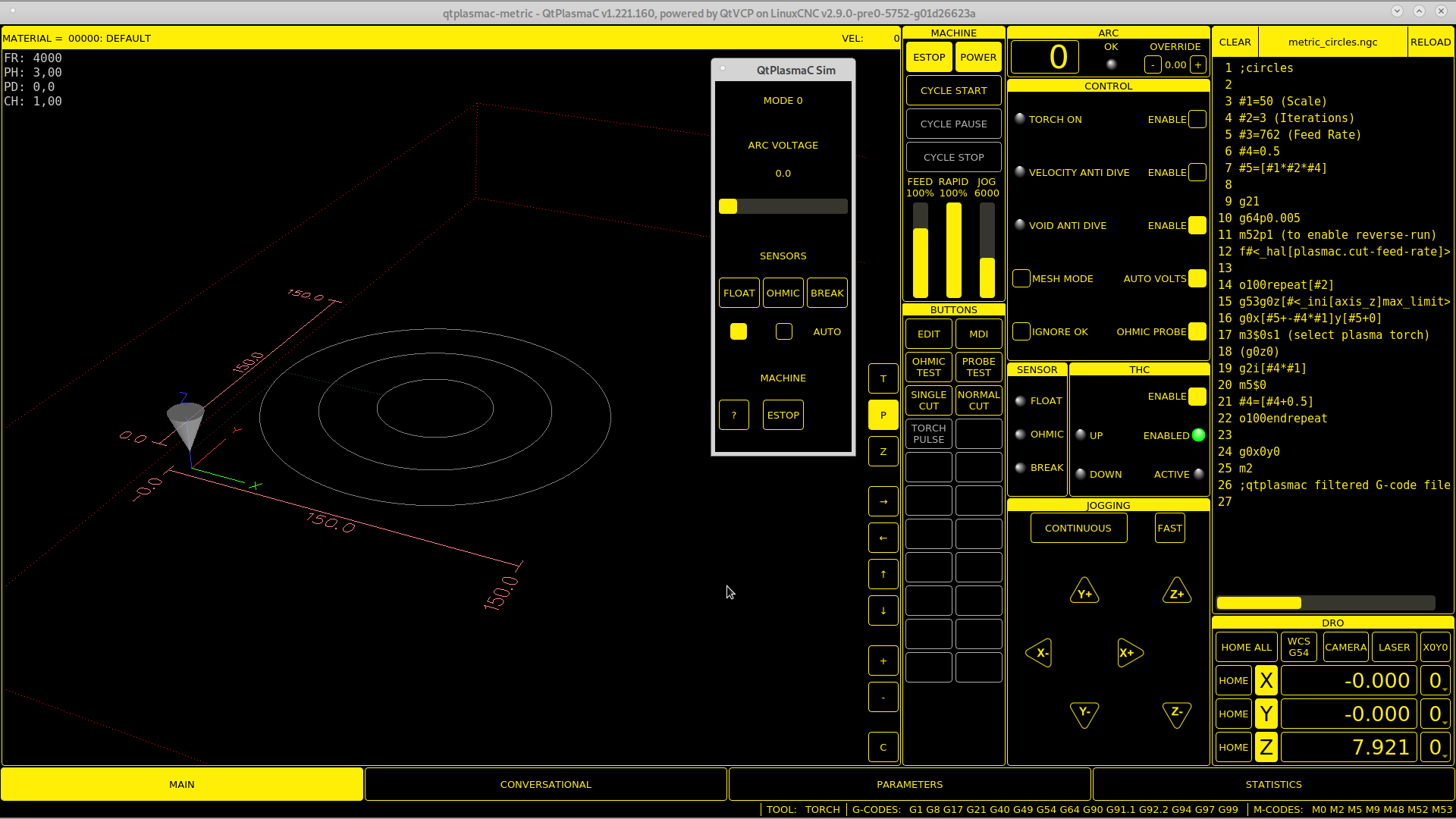

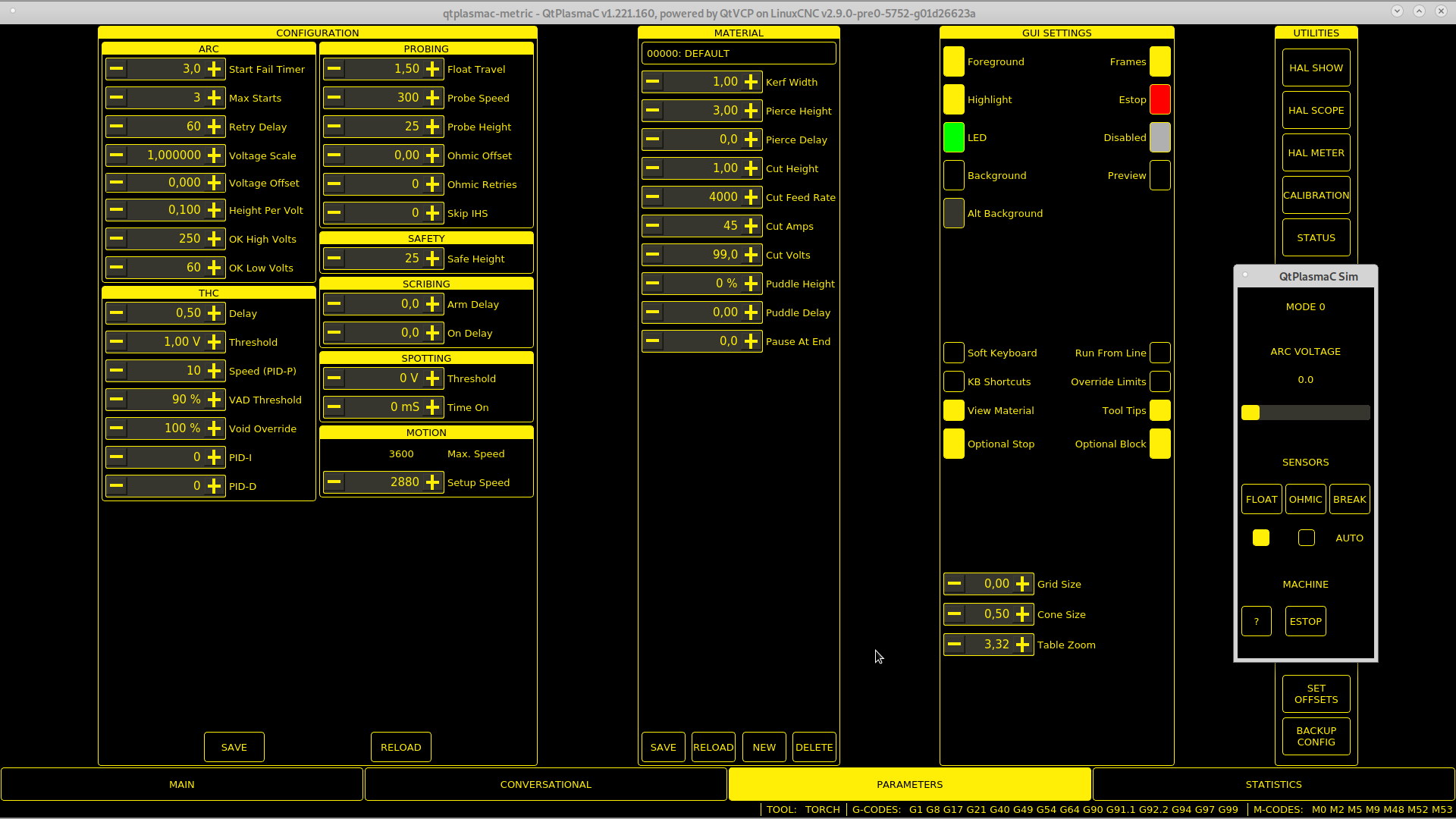

Corrected the sizes of buttons for touch screens. Maybe someone will fit.

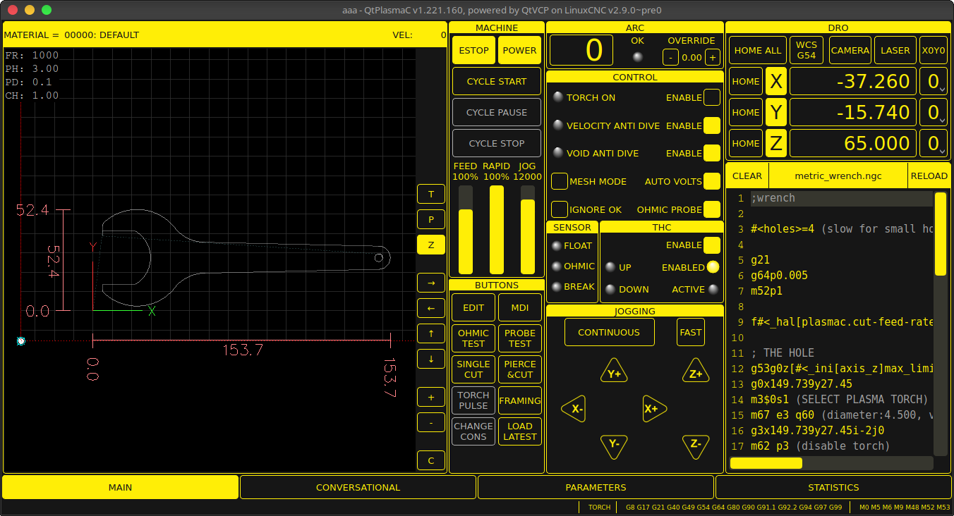

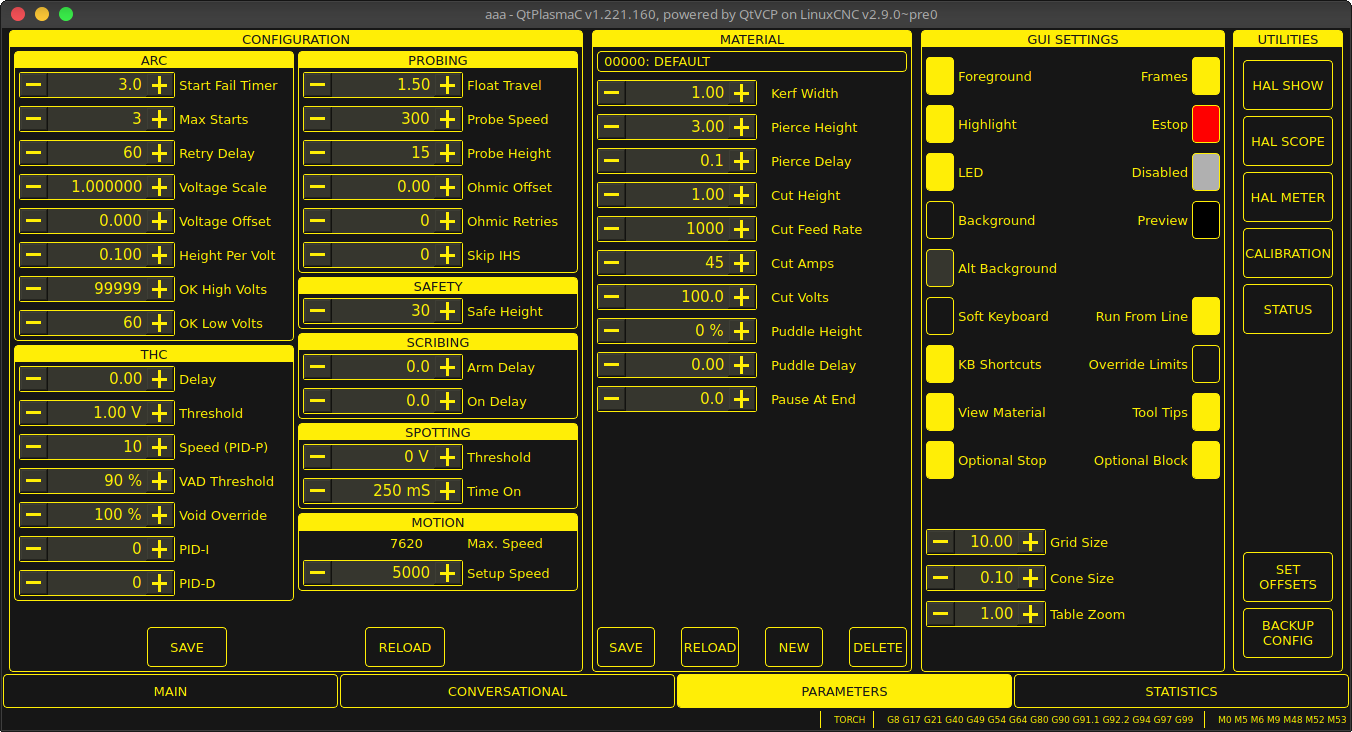

You can achieve similar results with custom styles:
linuxcnc.org/docs/devel/html/plasma/qtpl...#_add_a_custom_style
The attached were done with a file in the config directory named qtplasmac_custom.qss with the following contents:
Warning: Spoiler!
#file_clear, #file_open, #file_reload,
#material_label, #velocity_label, #velocity_show {
min-height: 36;
max-height: 36;
height: 36 }
#color_foregrnd, #color_foregalt,
#color_led, #color_backgrnd,
#color_backgalt, #color_frams,
#color_estop, #color_disabled,
#color_preview, #opt_stp, #opt_blk {
height: 36px }
QCheckBox::indicator {
height: 36px }
QTabBar::tab {
height: 30 }Attachments:
Last edit: 07 Feb 2022 00:43 by phillc54. Reason: I forgot the #material_label

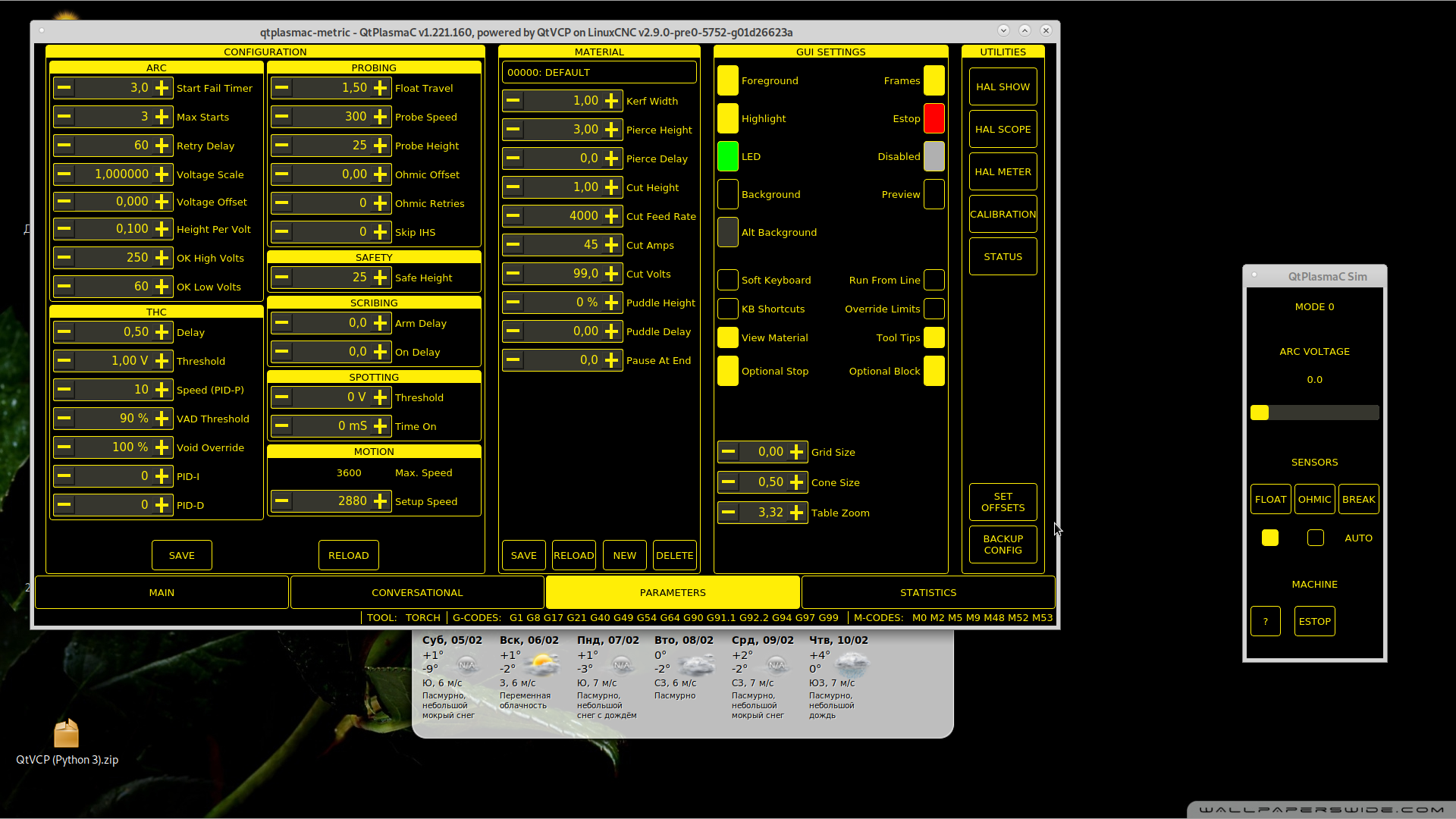

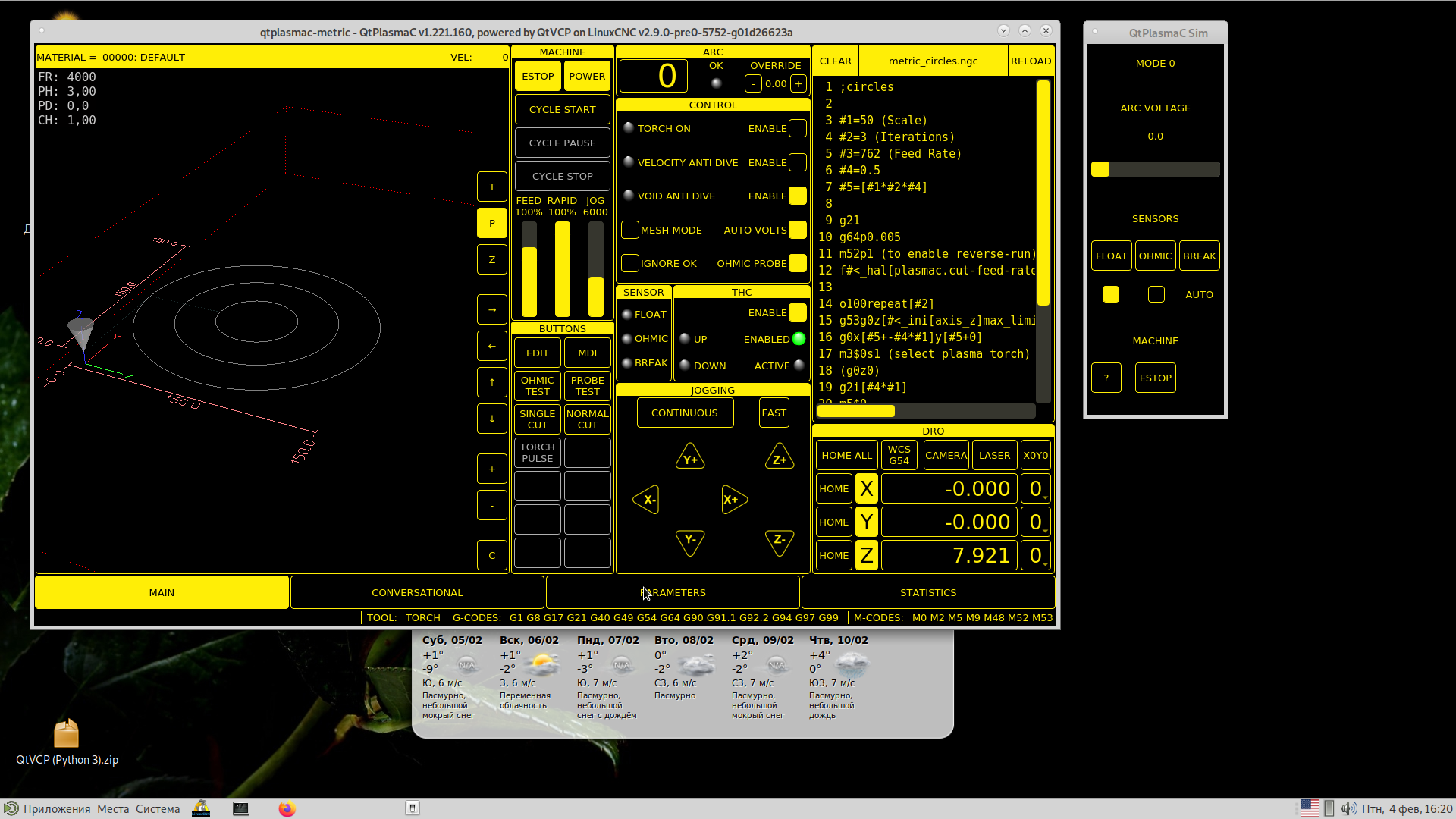

Thank you for your attention! In the designer, I adjusted the size of the Main Window and Push Buttons. The rest is in styles. Please tell me how to change the size and appearance of Jog Buttons. Thanks!

Try this:
Edit: I have added a reasonable custom stylesheet for 1680x1050 display.
/* JOG BUTTONS ------------------*/
#jog_x_plus, #jog_x_minus,
#jog_y_plus, #jog_y_minus,
#jog_z_plus, #jog_z_minus
{min-height: 60; min-width: 60; qproperty-iconSize: 60px}Edit: I have added a reasonable custom stylesheet for 1680x1050 display.
Last edit: 07 Feb 2022 18:23 by phillc54.
- phillc54
- Posts: 5711
- Thank you received: 2100
07 Feb 2022 19:29 #234314
by phillc54
Replied by phillc54 on topic [QtDragon] Plasma interface?
This is a separate post because the forum editor is a POS...
I pushed a change so that it is now possible to change the size of the user buttons as well:
/* USER BUTTONS -----------------*/
/* the next line needs to be 2 x button width plus 16 */
#main_c2 { max-width: 176px}
#file_edit, #mdi_show,
#button_1, #button_2, #button_3, #button_4,
#button_5, #button_6, #button_7, #button_8,
#button_9, #button_10, #button_11, #button_12,
#button_13, #button_14, #button_15, #button_16,
#button_17, #button_18, #button_19, #button_20
{min-width: 80; min-height: 60}
