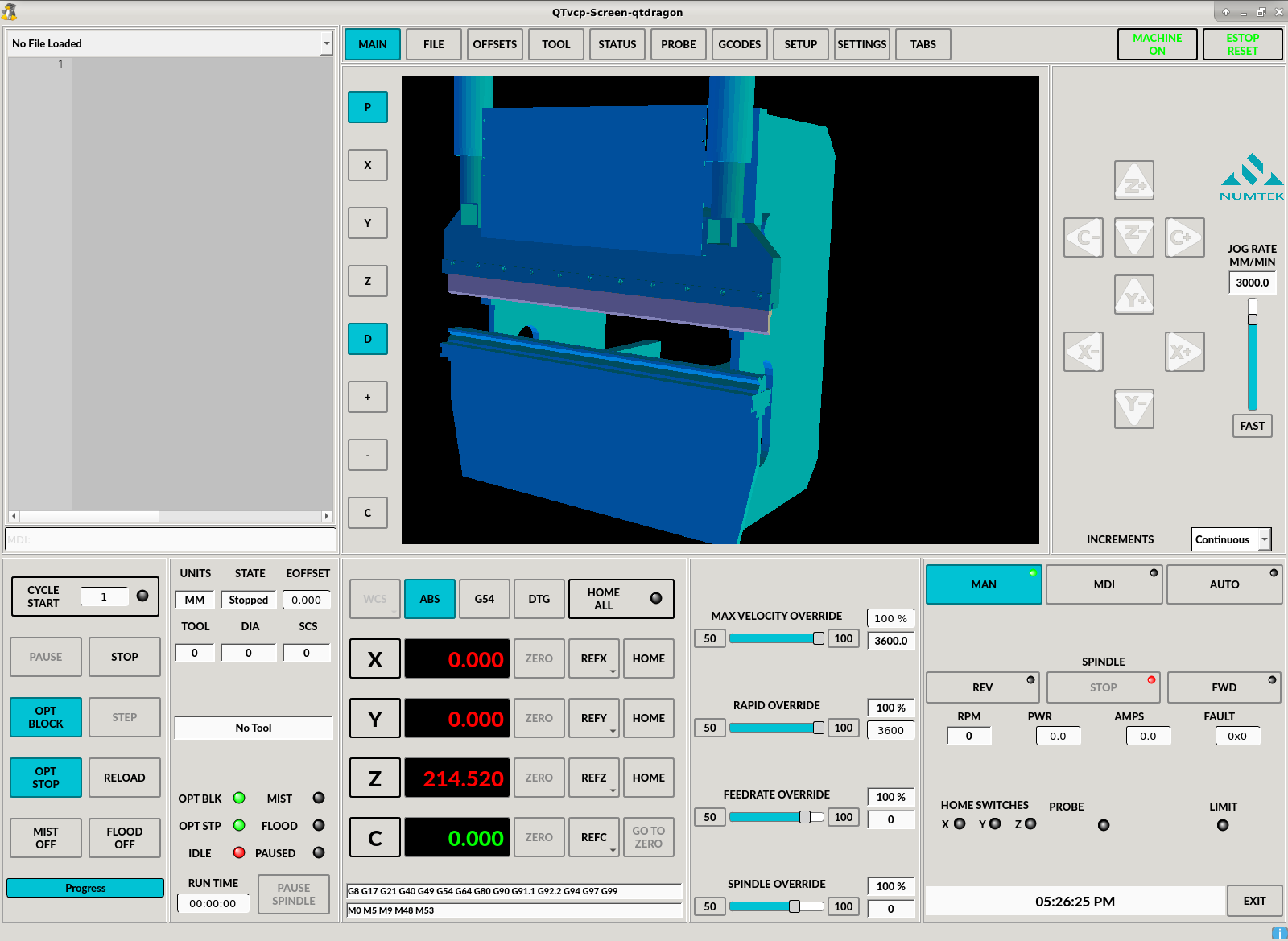

15 Mar 2022 00:32 - 15 Mar 2022 01:05 #237272 by RomeReactor
Replied by RomeReactor on topic [QtDragon] Simple vismach window
If you want it displayed as a tab of it's own in the main tab of qtdragon there would be more code changes needed.
By adding:
import press_brake as MILL
and:
machine = MILL.Window()
self.w.horizontalLayout_3.addWidget(machine)
to the handler file, and deleting GCodeGraphics from QtDragon we effectively replaced the plotter with our model:
If you come up with a nice model, please consider adding it to linuxcnc
Sure. Attached is the file for the model we're using. The original parts came from here: grabcad.com/library/press-brake-4

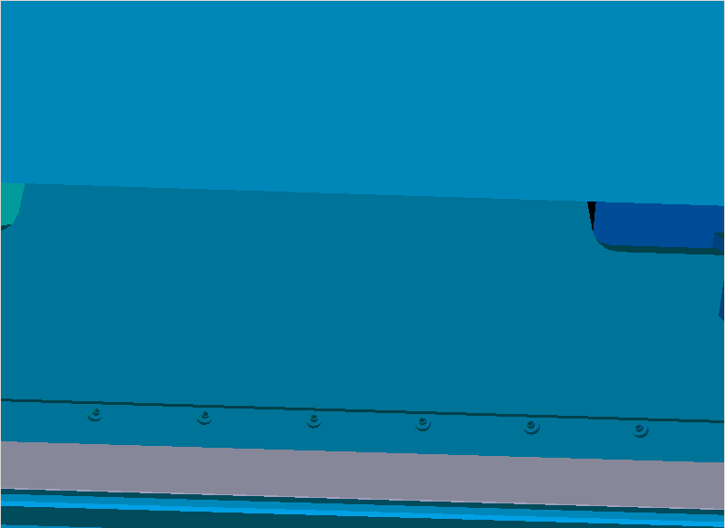

15 Mar 2022 16:07 #237339 by RomeReactor
Any ideas how to set the zoom of the space when the simulation starts, example (first image is how it starts, second how you want it to look like)
15 Mar 2022 17:08 #237347 by cmorley
Replied by cmorley on topic [QtDragon] Simple vismach window
See your other thread for the answer
