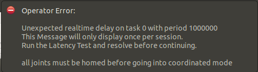

Untimely alarm information was created by yi2580

isn't there buttons to show the last 5 messages?

Replied by yi2580 on topic Untimely alarm information
It will be displayed, but it is not real-time enough. For example, there is an error message for the sixth time, but what he displays here is a secondary error message

uname -a

Replied by cmorley on topic Untimely alarm information
can you run linuxcnc from a terminal and see if more errors show in the terminal?
Or if the errors are in a different order.
Errors are also displayed in the terminal, but the prompt box here is not displayed in time. It seems that error messages are piled up, and he will have four or five message delays. Or is there an error message refresh statement
Can you give more detail?
Do all the messages in the terminal make it to the window but in a different order?
From memory the window will limit the messages to the last 5.
I guess the other question is how many error messages are you getting and trying to display?
No, the order of error reporting is correct, but it is not displayed in time. For example, it should have five errors now, but only one error is displayed
What screen are you using?
What would you like to happen?
What do you have so many errors to process?
Usually as an operator you clear errors as they come and they shouldn't come often.
Of course if your screen uses custom code you can catch them with your own code.
Also I am assuming you are not using any other program that reads linuxcnc's errors?
Having more then one program read linuxcnc errors is a no no.
OK, thank you very much for your reply. There is another question. Can there be a way to get rid of the alarm prompt in this pop-up window?
