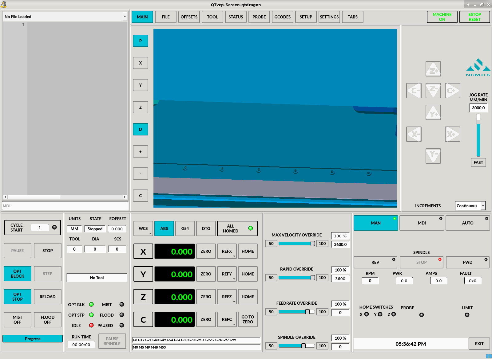

4 years 7 months ago #237275
by RomeReactor
Changing starting zoom level on Qt_Vismach was created by RomeReactor
- Posts: 6803
- Thank you received: 2181
4 years 7 months ago - 4 years 7 months ago #237284
Replied by cmorley on topic Changing starting zoom level on Qt_Vismach
try this change:
machine = MILL.Window()
self.w.horizontalLayout_3.addWidget(machine)
# set zoom between 600 to 5600
machine.glWidget.setZoom(3000)

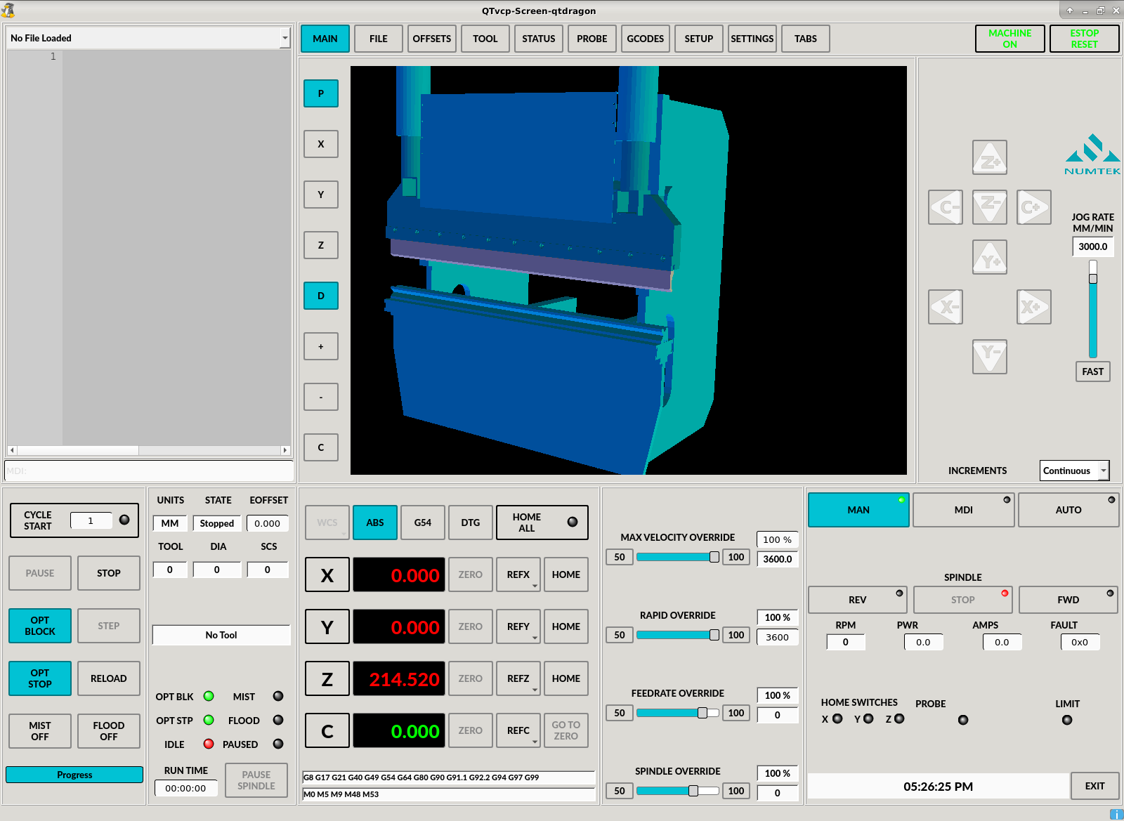

4 years 7 months ago #237371
by RomeReactor
Replied by RomeReactor on topic Changing starting zoom level on Qt_Vismach
Thanks. We also managed to change the starting zoom level by changing this in class Window(QWidget), from this:
to this:
Code:
v.distance = size * 3
Code:
v.distance = size * 6
- Posts: 6803
4 years 7 months ago #237429
Yes they in fact change the same variable.
