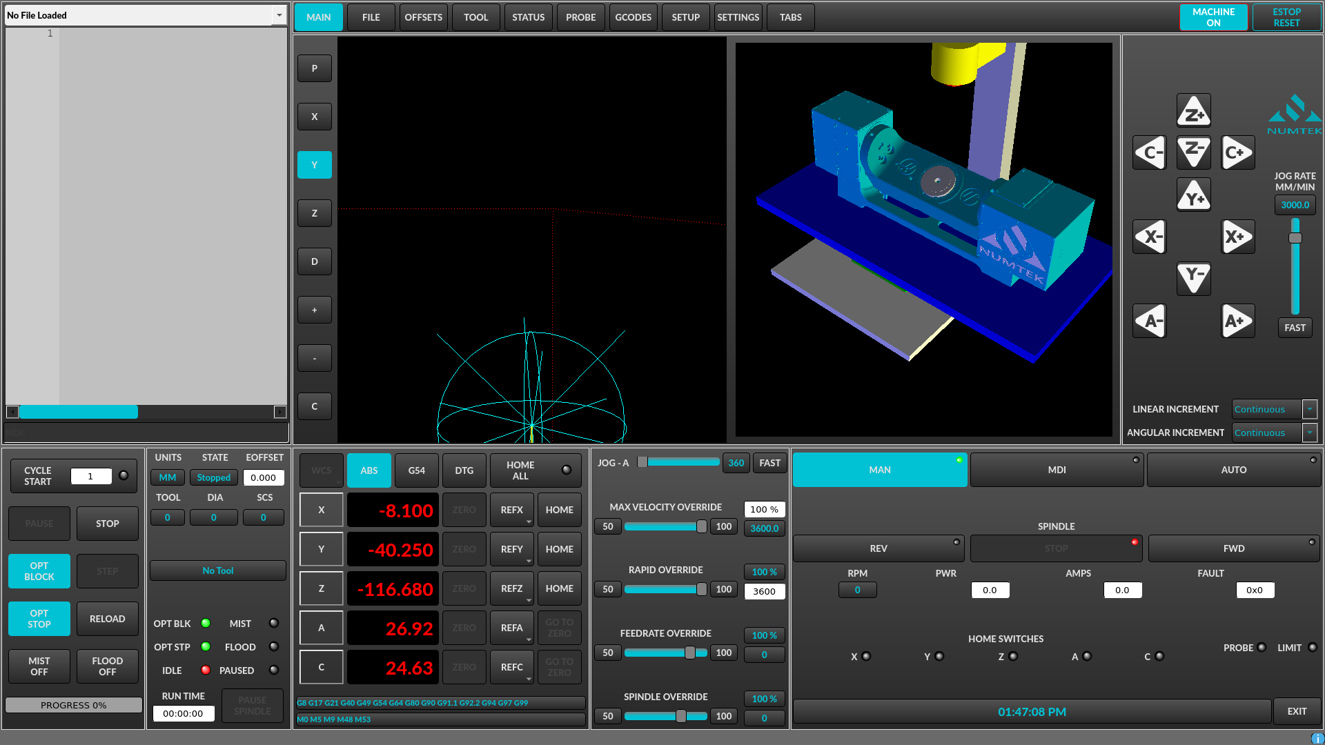

[Qt_Vismach] STL file incorrectly centered was created by RomeReactor

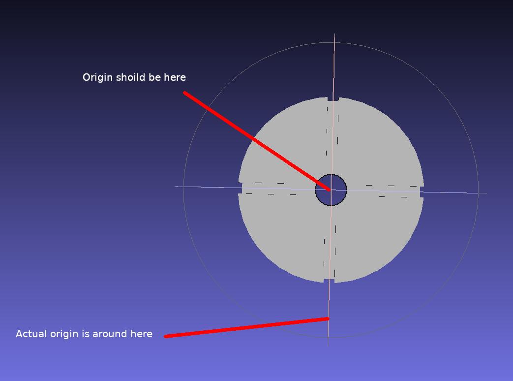

Replied by cmorley on topic [Qt_Vismach] STL file incorrectly centered
As far as I know, no the program assumes the origin is the center.
I am not very experienced with vismach though.
was your model of the chuck built with the origin in the middle?

yes, the STL model is made in SOLIDWORK and we established the origin of the piece in the center
maybe something like this (setting translate x y or z to the required offset)?
chuck = HalRotate([STL_part], None, "hal_pin_name", angle_scale, x, y, z)
chuck = Translate([chuck], x, y, z)

After thinking some more, you probably need to translate the part before adding the HAL rotate.
chuck = Translate([STL_part], x, y, z)
chuck = HalRotate([chuck], None, "hal_pin_name", angle_scale, x, y, z)

Yes, translate first, then hal_rotate.
Though it might be tidier to move the model to the right place in the CAD.

Thanks for confirming the procedure. Very nice.
