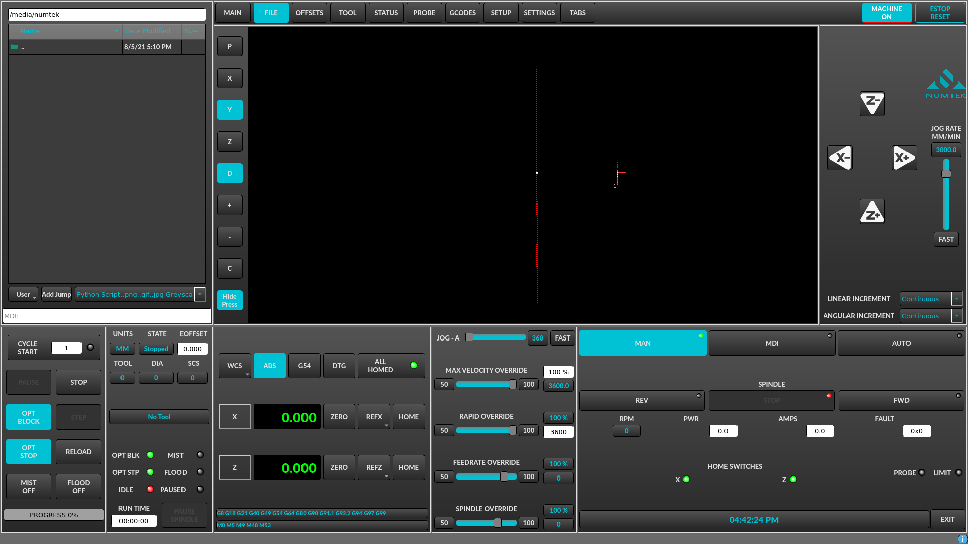

We're trying to make a lathe config with QtDragon, but whenever we load a file, at first it looks right:

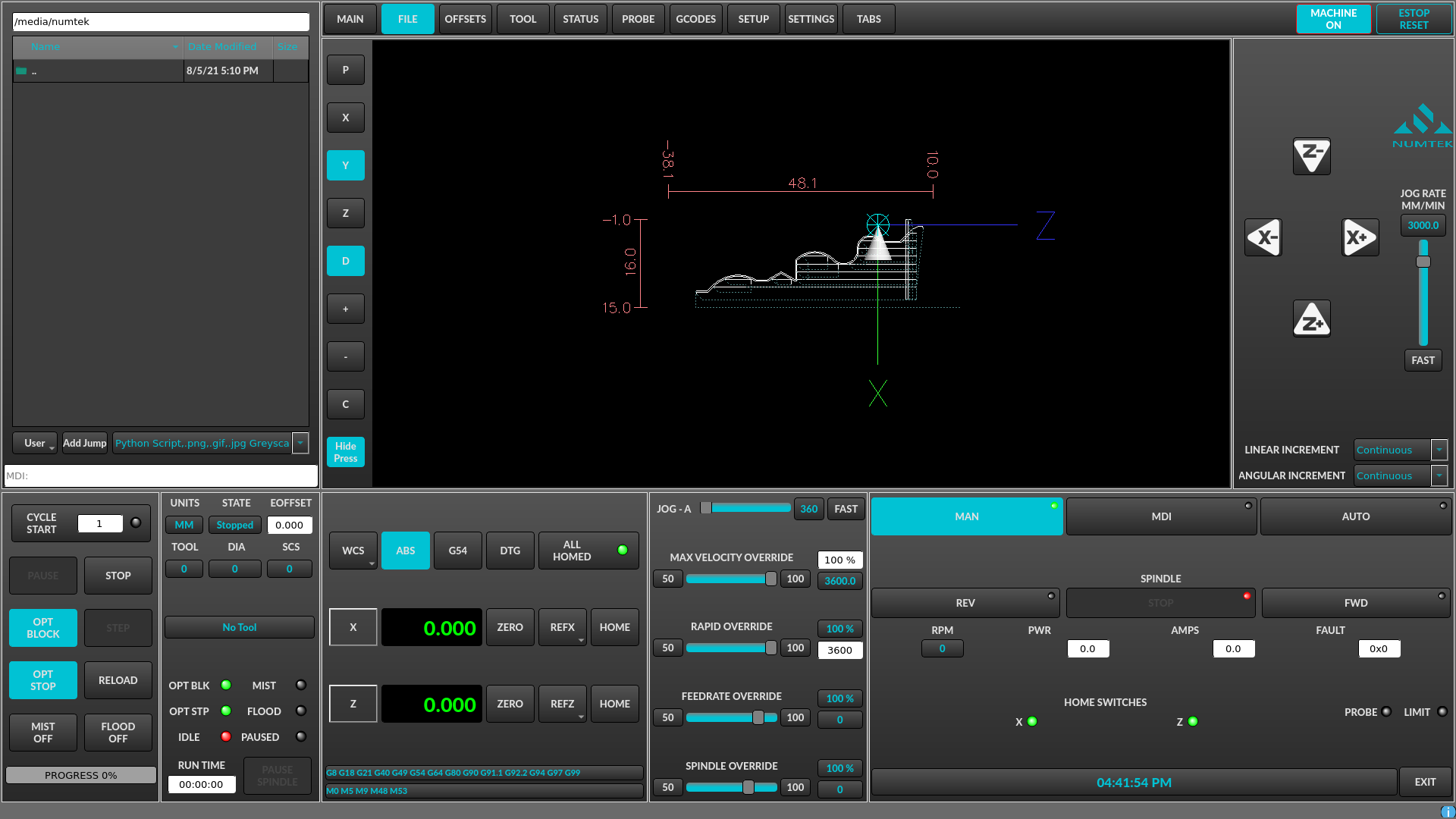

but the tool ends up farther along the y axis than the piece itself:
Attached ais the INI file. Please let us know if you need other files and/or info.
Thanks in advance.
29 Mar 2022 16:43 #238666 by andypugh
Replied by andypugh on topic [QtDragon] Lathe
Can you check your tool table to see if there is a Y offset in there?
Unlikely, but could cause this.
30 Mar 2022 00:43 #238691 by cmorley
Replied by cmorley on topic [QtDragon] Lathe
The view buttons in qtdragon have not been set to change to lathe views when the INI specifies lathe. There are probably many little paper cuts to get this to work satisfactory.
Are you saying that the Y axis is not 0 in the display?
