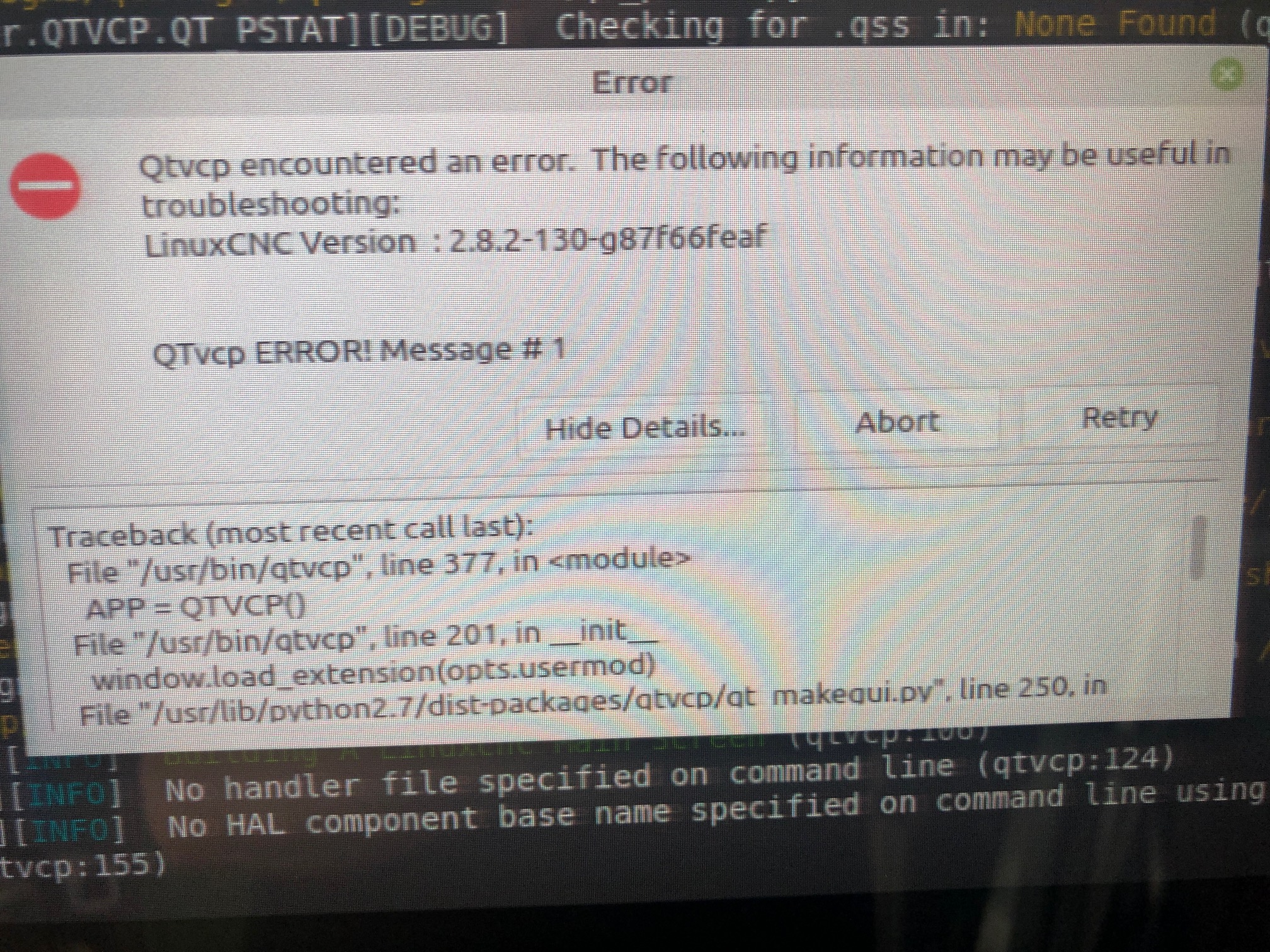

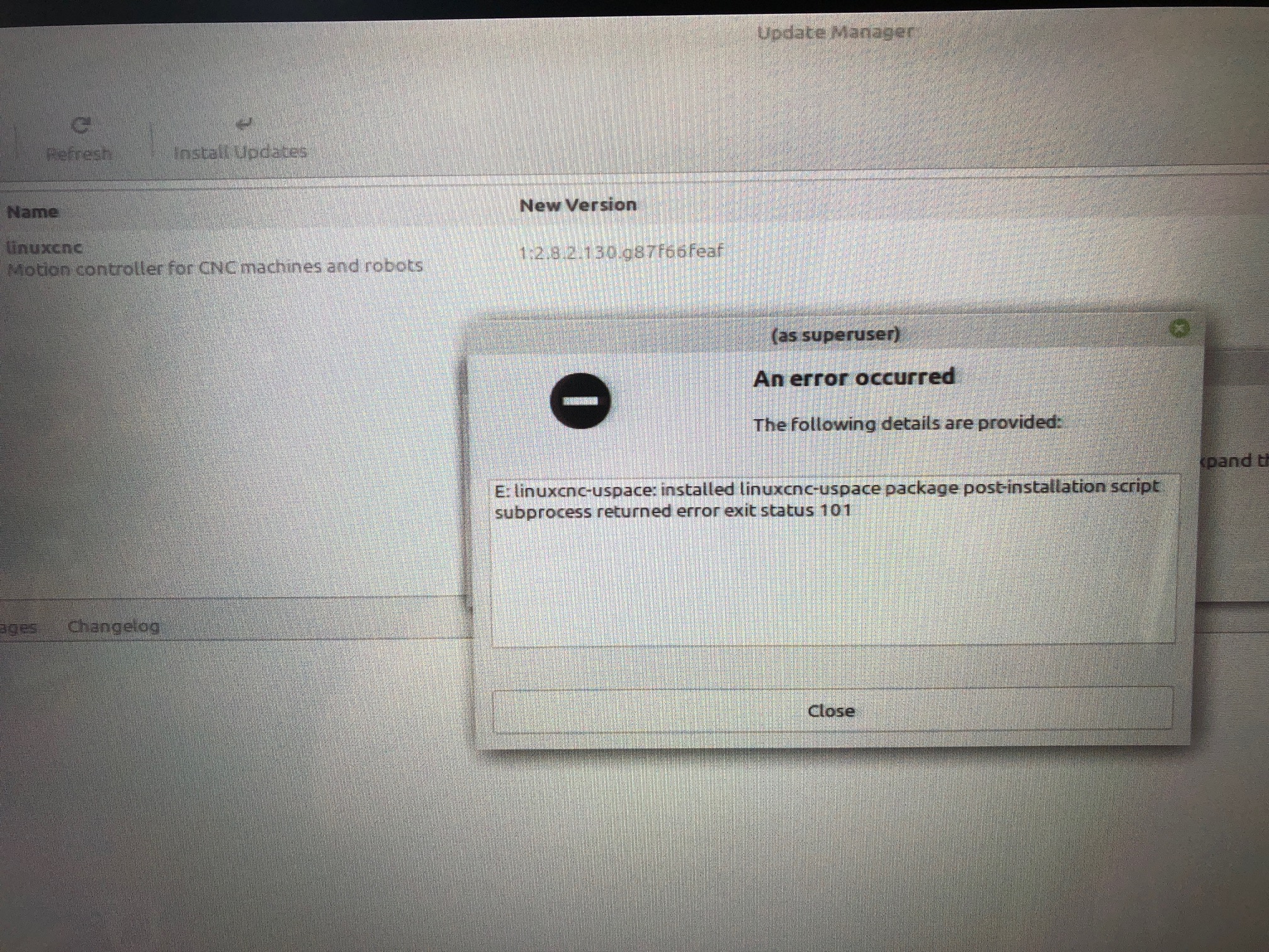

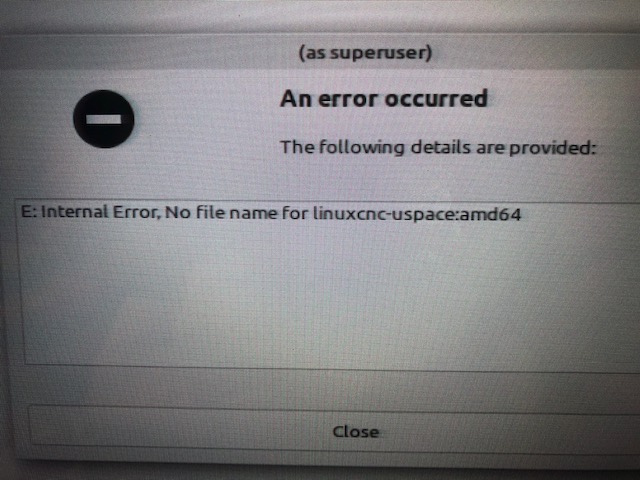

I am running 2.8.2 and using QTDragon.There was an update today that failed. Images attached. In the last two updates there has been an error in file_manager.py. The error is on line 160 and is not at a recognized indent. I moved it over one space and that corrected the problem and allowed LinuxCNC to start. The other error where the post install script failed is what I think might be causing the symptom I am having but I am not sure. At various times I cannot switch from auto back to manual. This will happen consistently after E-Stop is pressed. I am testing my M6 remap. I load a file and hit cycle start. The tool goes to the tool-setter and gets measured and just before it starts to cut the part I hit E-Stop so I can check the Z height. AT this point I can't jog because the machine is stuck in auto mode. I did try to reinstall the package but that made no difference. Any thoughts or suggestions would be appreciated.

Replied by cmorley on topic A couple of errors during update 2.8.2-130-g87f66feaf
there was a push to fix a jogging issue that had something to do with changing lnuxcnc mode.
IIRC they made it not possible to change mode (manual to MDI etc) while jogging.
I'm not sure how they decided it was jogging.
I not sure the fix was tested with anything but AXIS.
Does this sound likely?
The indent problem i can fix if it is still a problem.
The error dialog holds the most import details at the bottom - so it's not that useful unless scrolled. if you select abort it will print the error to the terminal, which is easier to see the whole thing.

I pushed a fix for the indent problem. sorry and thanks.
