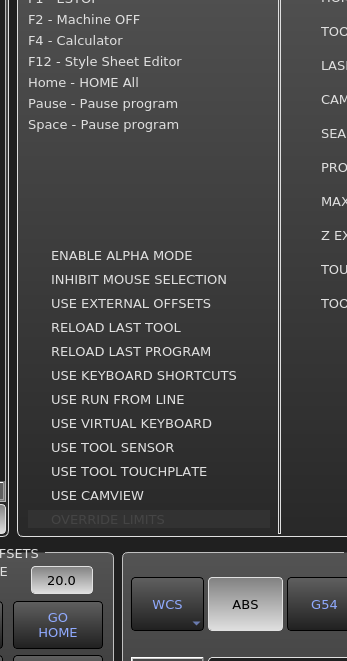

13 Jun 2022 01:47 - 13 Jun 2022 01:49 #245056
by hottabich
Replied by hottabich on topic [QTvcp.QTVCP.WIDGETS.CAMVIEW_WIDGET][ERROR] Video capture error: VideoCapture()
Maybe there is something strange going on.... See the screenshot where the checkmarks are gone.Yesterday I purged the install of LinuxCNC and did a fresh apt install linuxcnc-uspace on this production machine.Debian 10.12LinuxCNC LINUXCNC - 2.9.0-pre0-6533-g54bc57f73
Replace the argentinum.qss file.
Last edit: 13 Jun 2022 01:49 by hottabich.

17 Jun 2022 23:37 #245378
Replied by cmorley on topic [QTvcp.QTVCP.WIDGETS.CAMVIEW_WIDGET][ERROR] Video capture error: VideoCapture()
I think we may have got these fixed or definitely moving forward on them.
Thanks for the bug reports.
