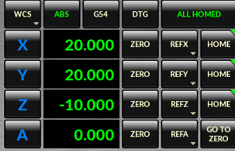

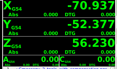

TLDR: I want gmoccapy-style DRO in QtDragon or derivatives. Possible?
I'm starting to think about switching GUI's and QtDragon is high on the list.
One of the GUI features I'm used to (in and out of LCNC) is having the WCS, Machine, and DTG DRO's all visible at the same time.
Most of the Qt-based screens have the various DRO's tabbed instead of all in one window. Better than nothing, but not ideal as far as I'm concerned.
So... is it possible to modify the axis DROs to function like the Gmoccapy style? I don't really need to know precisely how this minute, but a simple
Pics in case I wasn't clear in my explanation above.
- "not possible", or
- "possible, but insanely complicated", or
- "yup, no sweat"

Absolutely possible. Just need to make a custom designer widget. Whether it becomes a part of qtdragon is another matter.

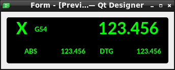

So just throwing together some existing widgets and a bit of styling, you can make this. Obviously, all functionality has to be defined in python in the handler file. Otherwise, you would have to make a full custom designer widget. (which requires a ton more programming) To make it behave like the gtk widget, where the REL, ABS and DTG DROs cycle around when you click it, you make the containing frame clickable and connect the click event to a function in the handler that reprograms everything. (DROs and labels)

Well, that's pretty slick!
I know nothing about python, so I'm unlikley to try to tackle that on top of a bunch of other things (ATC integration)
I'd be happy just to duplicate the DRO's in separate frames/windows and connect them to WCS/abs/DTG. Might look silly with three dro's for each axis but I'm more of a function over fashion kinda guy.
