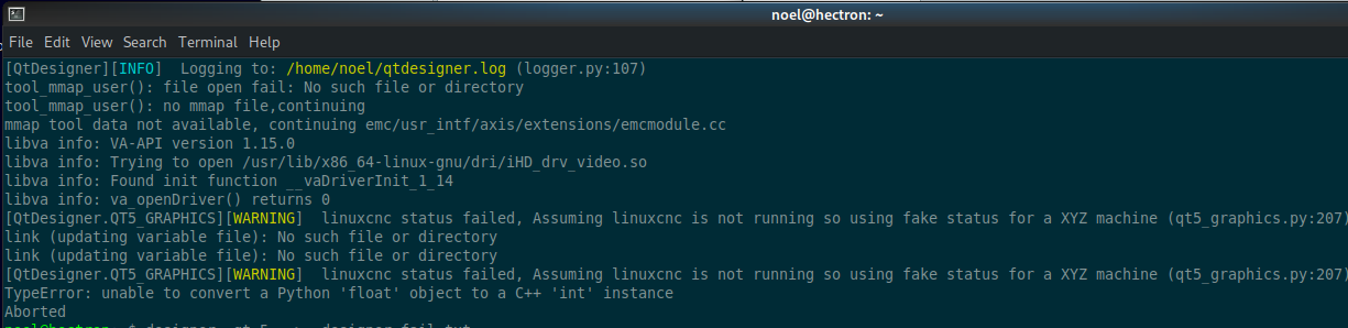

Well, apparently there were some changes in hal_glib.py that had to do with errors and status and stuff.
Since I have customized my hal_glib.py, those changed caused problems.
Got is all sorted with a few more diff's and edits.
But now I can't get qtDesigner to run.
No clue why? little help please?????
see the image attached, and the log file attached.
thanks
thanks
Last edit: 12 Sep 2022 13:35 by Roguish.

Replied by rodw on topic QtDragon, Linuxcnc 2.9pre, and Debian 12 (bookworm)
I don't know this code but I suspect you have the wrong type defined in class _GStat with your customisations
The following user(s) said Thank You: Roguish

Replied by Roguish on topic QtDragon, Linuxcnc 2.9pre, and Debian 12 (bookworm)
nah, haven't messed with anything like that.......
just realized that since i updated from debian 10 to 12, I haven't updated the qt5 designer thing.
I will try doing the full reinstall again. can't hurt...
I hope
I hope
Last edit: 12 Sep 2022 17:05 by Roguish.
Following an upgrade to bookworm today, Try installing Bookworm (Debian 12) and type
sudo apt install linuxcnc-uspace
sudo apt install linuxcnc-uspace-dev
There is a script to install qtvcp as part of linuxcnc. Try running
/usr/lib/python3/dist-packages/qtvcp/designer/install_script

Replied by cmorley on topic QtDragon, Linuxcnc 2.9pre, and Debian 12 (bookworm)
Unfortunately it's not enough to go on.
My feeling is it's a pyqt.property mismatch.
Which would dovetail with the work we were trying to do for newer pyqt libraries.

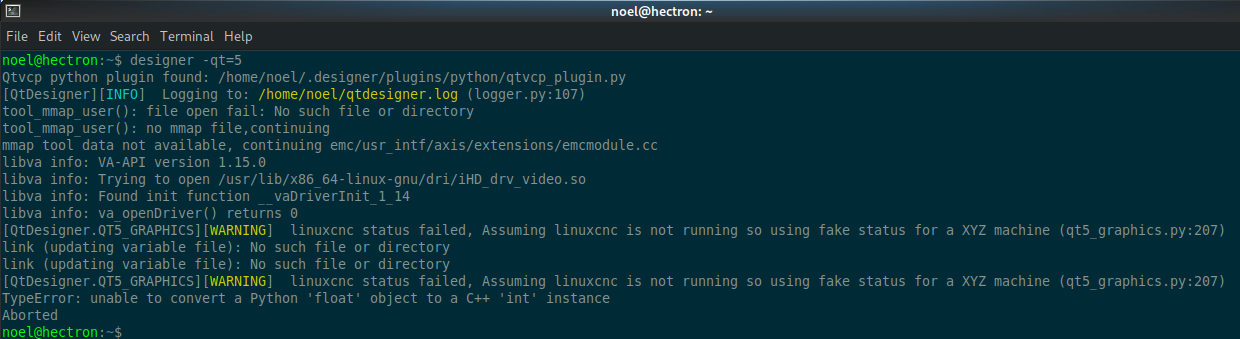

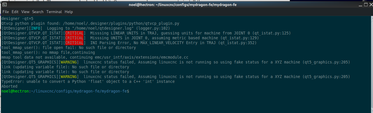

by Roguish
Chris,
you're probably right.
I ran the install script Rod suggested. Designer still not running.
Got a bit longer output. But same errors.
see the attached image file.
I figure you're working on it....have to eventually.........
let me know if I can help testing...
I currently have no systems that use the newer pyqt libraries and this problem doesn't show up for me.
Have you done custom edits to the widget too?
unfortunately it may be some time before I set up a new system.
Chris
Chris
It may be in that script but doeshelp?
sudo apt install qtbase5-dev
