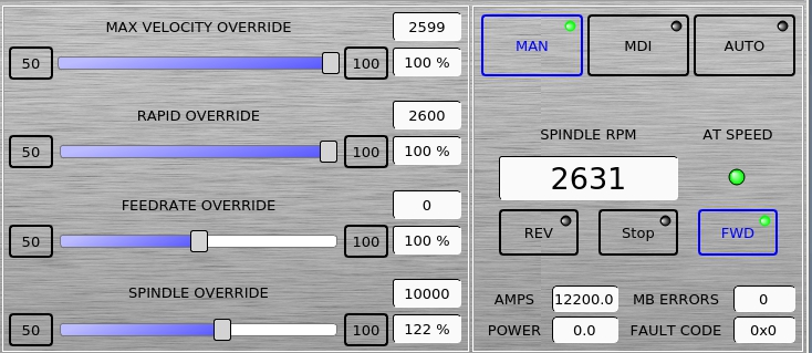

My spindle has analog input and output. So I am using the digital potmeter on my MESA card for spindle-output.
I use an analogin for feedback and scale it to show the correct value for RPM.
See the Spindle section of the hal file.
QTDragon correctly updates its display for SPINDLE RPM as it slowly increases to the demand value. The LED AT SPEED flashes until the speed is at the demand value. This all seems totally OK to me.
However: The spindle starts moving immediately. It does not wait at all until the spindle is at speed.
How can this be made to work correctly? What is the setting I need to change? I cannot find any pin or signal that controls this LED either.
The screenshot was made in manual mode for illustration, but the problem happens of course when I load a program and go into auto.
thanks!

is the signal spindle-at-speed connected to anything besides what shows in the HAL file you posted?

No, everything with spindle is in that one file

Your spindle.0.at-speed pin isn't connected to anything. As an example, this is how mine is connected. I use a 7i96 board but the concept is the same.
[/code]
Code:
net at_speed and2.0.in0 <= hm2_7i96.0.gpio.006.in
net spindle-forward spindle.0.forward => and2.0.in1
net at_speed_fwd spindle.0.at-speed <= and2.0.out
net at_speed_fwd qtdragon.hal_led_atspeed
[code]The AND component is not necessary, I use it to ensure the spindle can only go forward. If your system doesn't have an external signal that you can connect to an input pin of your mesa card, you can use the NEAR HAL component. [url=http://linuxcnc.org/docs/2.7/html/man/man9/near.9.html]NEAR[/url]

I see now that the the spindle.0.at-speed is not connected.
So, I'm setting it up now to compare the voltage that I get back from the VFD with the output voltage from the 7i76e.
I still don't understand how this QTDragon LED gets it's information.
BTW, the line: net at_speed_fwd qtdragon.hal_led_atspeed
gives an error message:
Pin 'qtdragon.hal_led_atspeed' does not exist.
What is the name of that LED?

The LED name may have changed over the various iterations. If you're using qtdragon_hd from the sim configuration that comes with qtvcp, it's name is hal_led_atspeed. If you're using qtdragon, it's name is led_at_speed.

The LED is coded to do it's own comparison of requested vrs actual spindle speed.
It doesn't use a HAL pin at all.
hmm.. I could in the future export a HAL pin based on that comparison to connect to.
