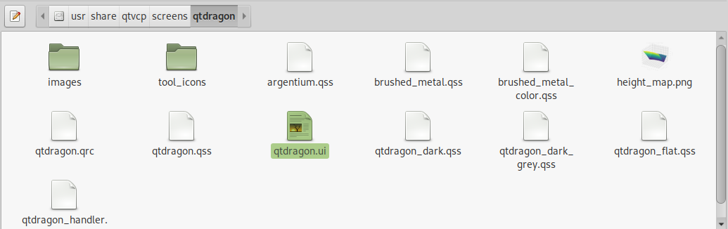

Hi, I have been trying to figure out if it's possible to disable the blur effect that comes with a dialog pops up. I glanced at the code, but with my limited qt knowledge I haven't been able to figure out either a qss property or qtdragon.pref option to disable this. Any pointers would be appreciated.

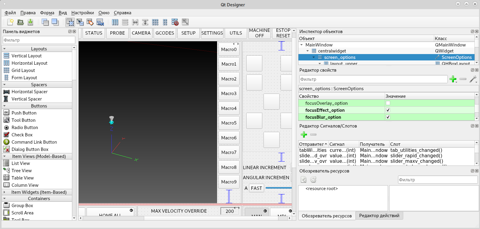

Open qtdragon.ui in designer and uncheck the two boxes as in the screenshot _ 1 or change the file to the attached one from root in mc at the address as in the screenshot _ 2.

Also adding this to the stylesheet then apply and save it will work:
Chris
#screen_options {qproperty-focusBlur_option: false;}Chris
