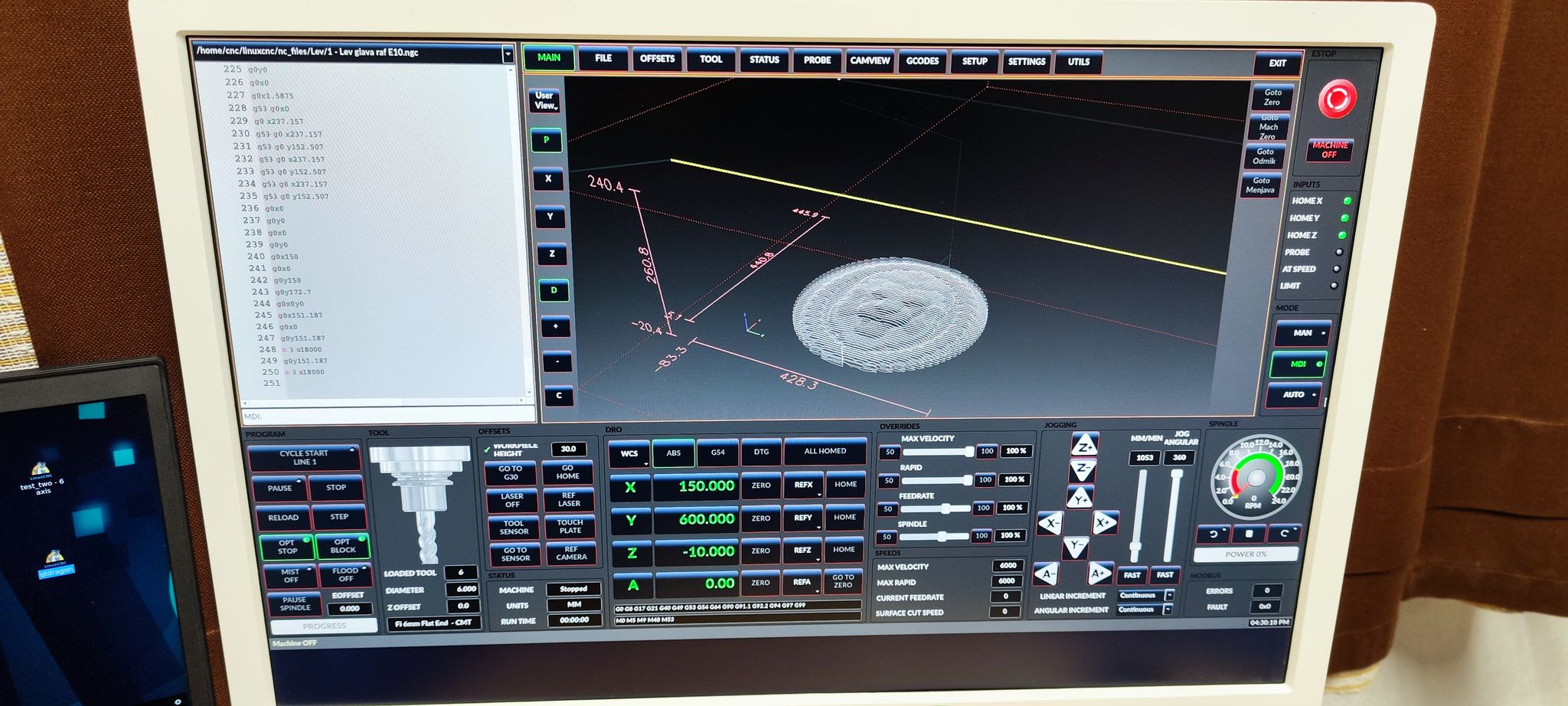

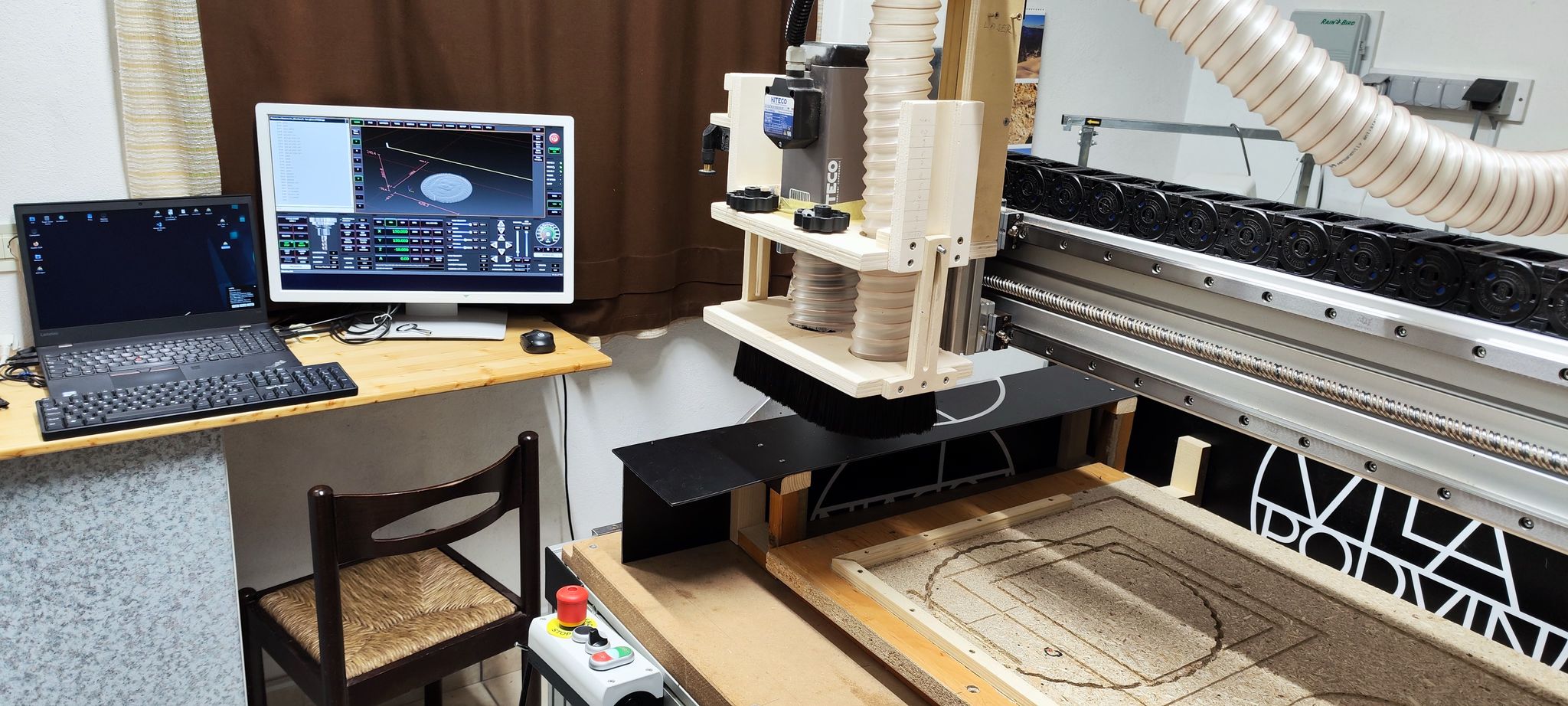

I am a beginner in CNC machining and LinuxCNC. I made my CNC router myself and therefore decided to use LinuxCNC. As a beginner with no knowledge of the Linux system, not the Python programming language, I spent a lot of time reading how-to guides, reading forums, and watching Youtube movies.

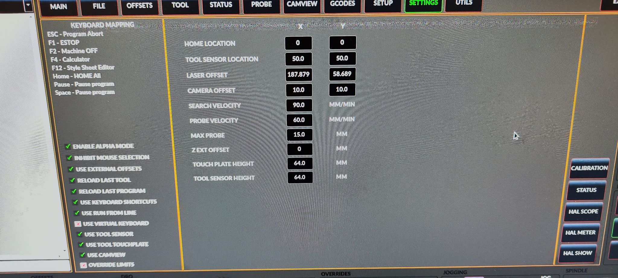

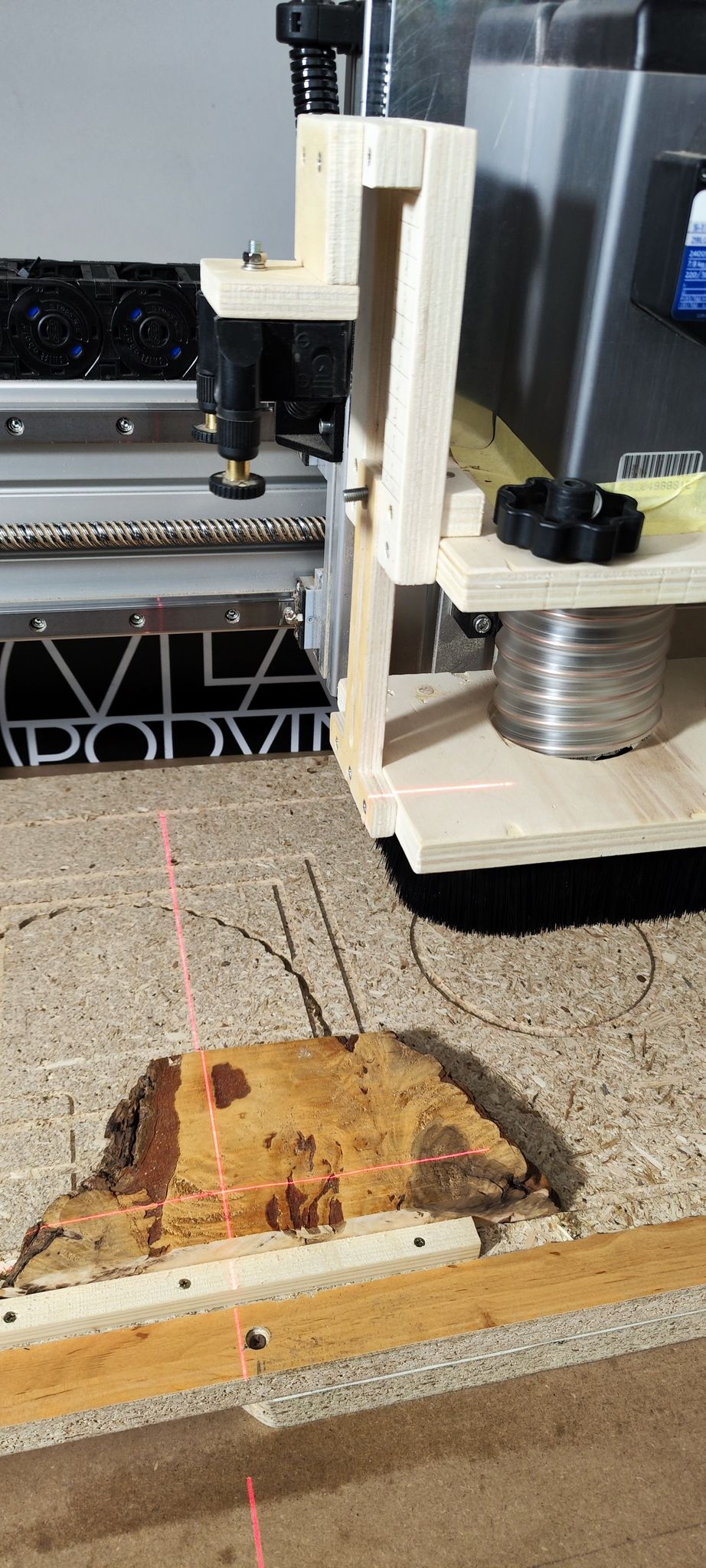

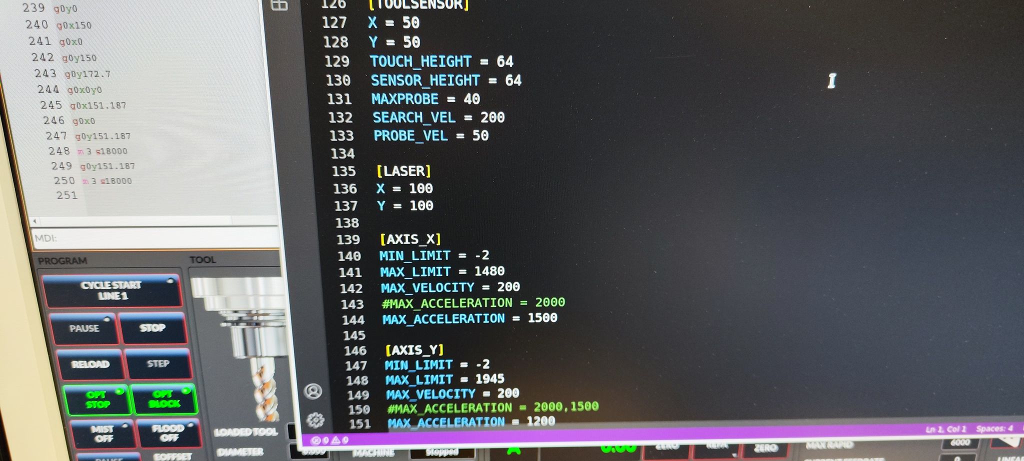

The graphical interface allows connecting a laser for easier positioning of the XY coordinates, in case the G54 coordinates are not sufficient. The instructions clearly state that in the INI file, in the Laser section, the X and Y coordinates for which the laser cross deviates from the center - the center of the tool's attachment - must be entered. Unfortunately, this does not work as expected.
The GUI has an additional SETTINGS screen, in which additional information about various settings, including LASER OFFSET, can be entered. Only if values are entered here the button REF. LASER correctly enters the new coordinates for X0 and Y0, of course for the selected user coordinates G54, G55,...
The values for XY in the settings for LASER OFFSET must be entered logically. If the measured value for X or Y of the laser is positive, then it is entered in the settings with a minus sign, and vice versa, if the measured value is negative, a positive value is entered.
I wish you successful work with LinuxCNC and the QTDragon_HD interface

The laser offset entries in the INI file were depracated quite a while ago. I checked the code in the version that comes with linuxcnc example screens and it only uses the values stored in the SETTINGS page.

These values, along with many others, are stored in the qtdragon.pref file located in the config directory. It's the same directory where your .ini and .hal files are stored. It is not overwritten when you update linuxcnc.

I've removed the references to the INI settings for probing from the docs. Thanks guys.
