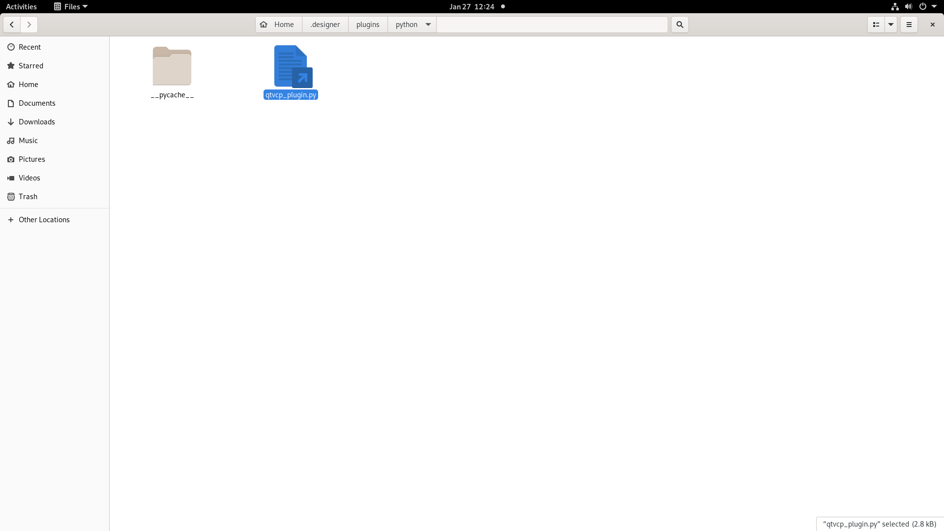

Hi Chris,
I couldn't find the qtvcp_plugin.py at:
/usr/lib/python3/dist-packages/
instead I found it here:
home/linuxcnc-dev/lib/python/qtvcp/plugins/qtvcp_plugin.py
and it(qtvcp_plugin.py) already has a shortcut at:
~/.designer/plugins/python
I don't know why it is like that, it might be because I am use RIP version
Please kindly guide me to how I can use:
/usr/lib/python3/dist-packages/qtvcp/designer/install_script
as it's new to me.
Regards
Abhishek

Replied by cmorley on topic Modifing QTVCP xml for Qtdragon_hd?
Ok sorry I assumed you were using an installed version of linuxcnc.
With RIP linuxcnc you need to run in a terminal:
. scripts/rip-environment
to set up the paths, then to run designer, enter in the same terminal:
designer
and that should run designer with the widgets.
If it does not please post what it writes in the terminal.
Chris
