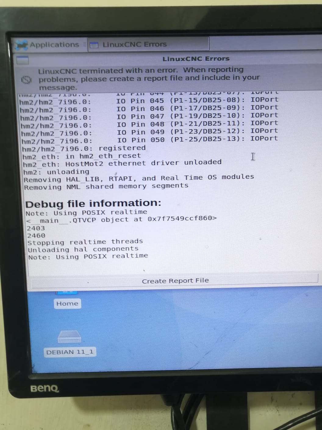

Today I did an update of qtplasmac and I have this error maybe someone has the same as me.
Spaceship ohmic hall warning file contains DOS-sty

Assuming that the rest of your error is that the hal file contains DOS-style line endings, then the solution is easy. Open the .hal file in Geany (document > set line endings) and change the line ending type to Linux and save.

Thanks for the help, now this is the new message.I don't know if it's a coincidence or not, but yesterday morning everything is normal and after updating I had problems in the afternoon with the ohmic sensor, related to height and distances, even halfway through the cut, the float switch is activated.

Really need to see the entire error message

it appears to be something with qtvcp.
Can you try changing in the [DISPLAY] section the DISPLAY = qtvcp line to DISPLAY = qtvcp -i, running it again and getting the new error report?

On your screen dump, there is a icon that says Debian 11 which is BUllseye and your kernel is 4.19 which is buster.
What version of debian are you running?
Can you share the output from
