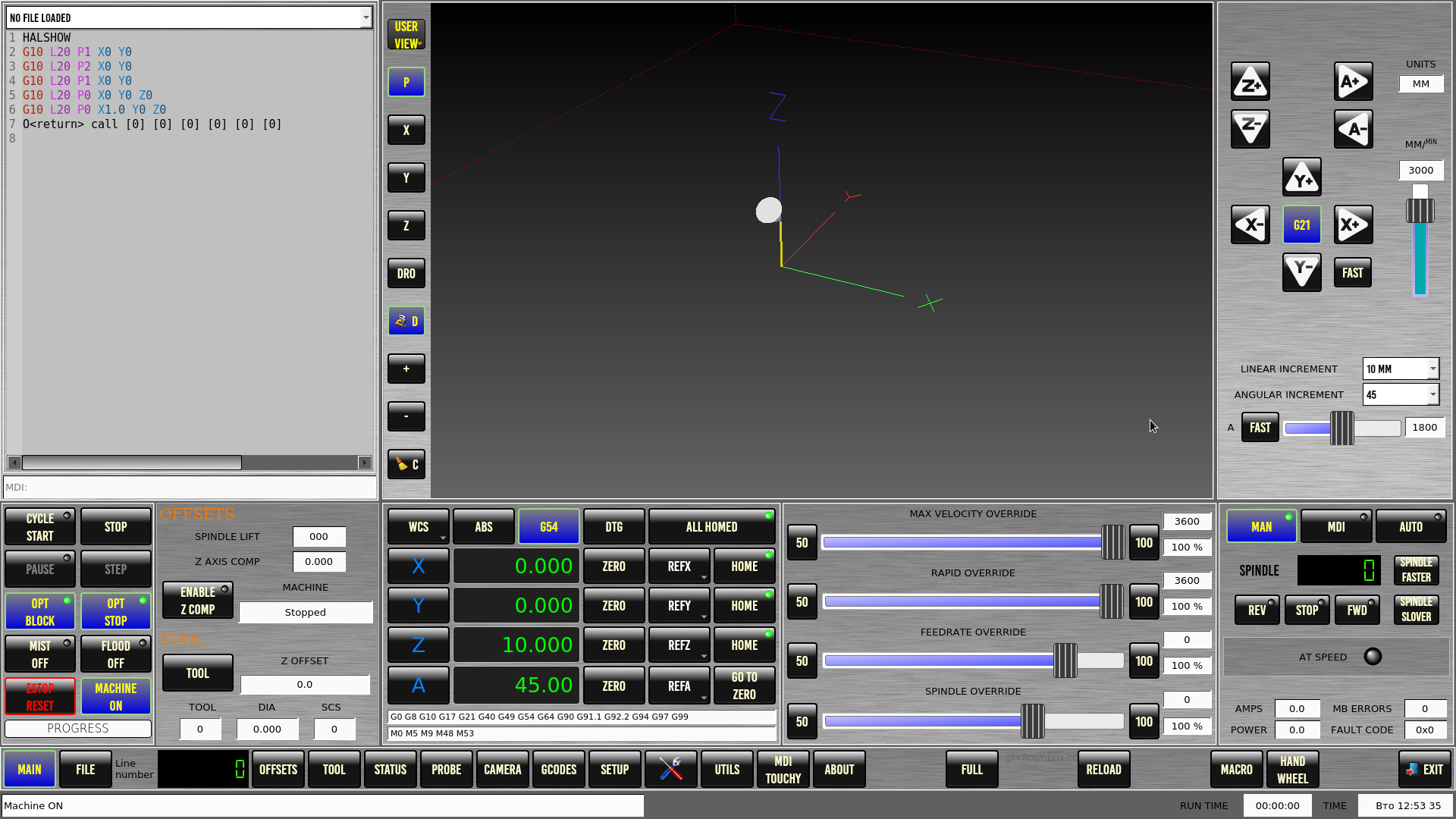

Hello,
The QTDragon HD GUI has buttons for Linear and Angular Increment. Both buttons work for me with the same error. When I click on the button, a data selection window opens, but there is no visible content and the window expands vertically over the entire screen.
Can you help me please.
I am using Debian 11 and LinuxCNC 2.9
I am attaching an INI file, a screenshot and an image of the QT settings.

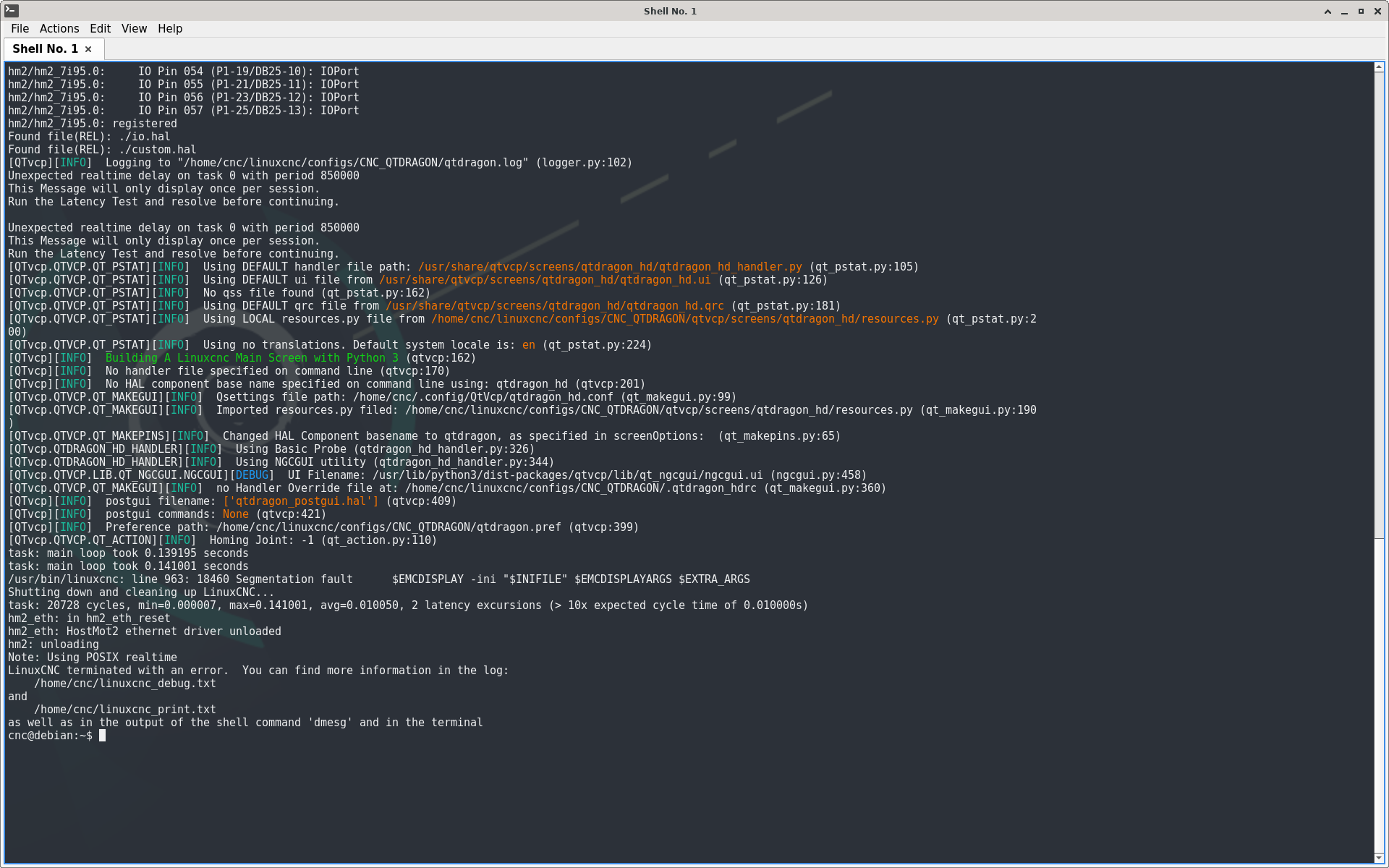

It's not obvious to me what the problem is.
Can you run linuxcnc in a terminal and post the output?
Did you modify anything with designer?
Does the simulation configuration show the same behavior?

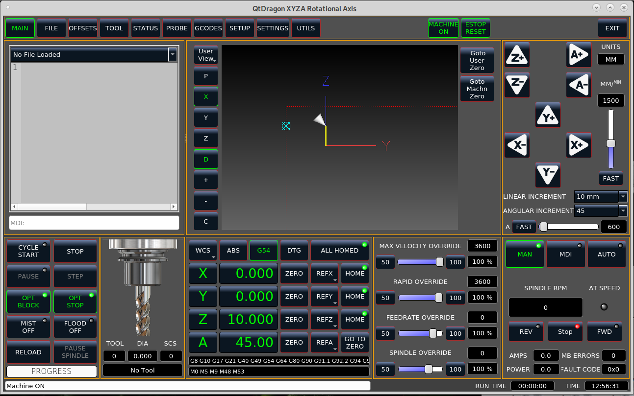

So I just pulled the latest 2.9
QTDragon HD works for me.
The woodpecker issue is still not resolved
Very odd
Very odd
Answer: see the attachments, hope this is what you need, because I'm not familiar with Linux, I'm still learning.
