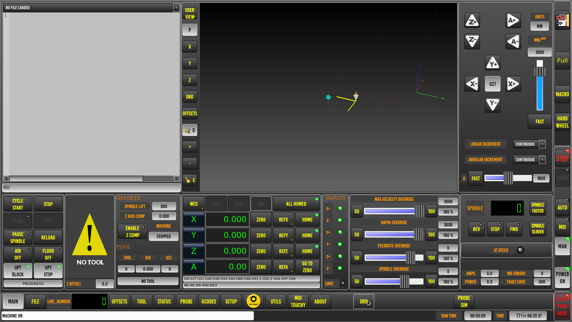

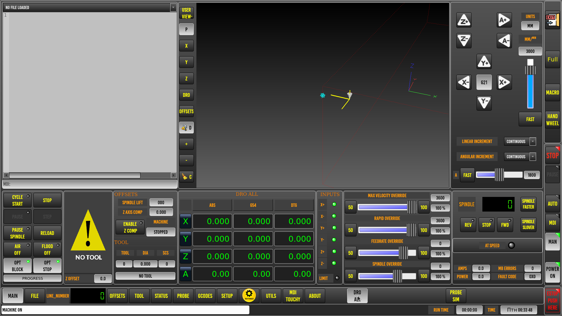

woodpecker intergration was created by cmorley

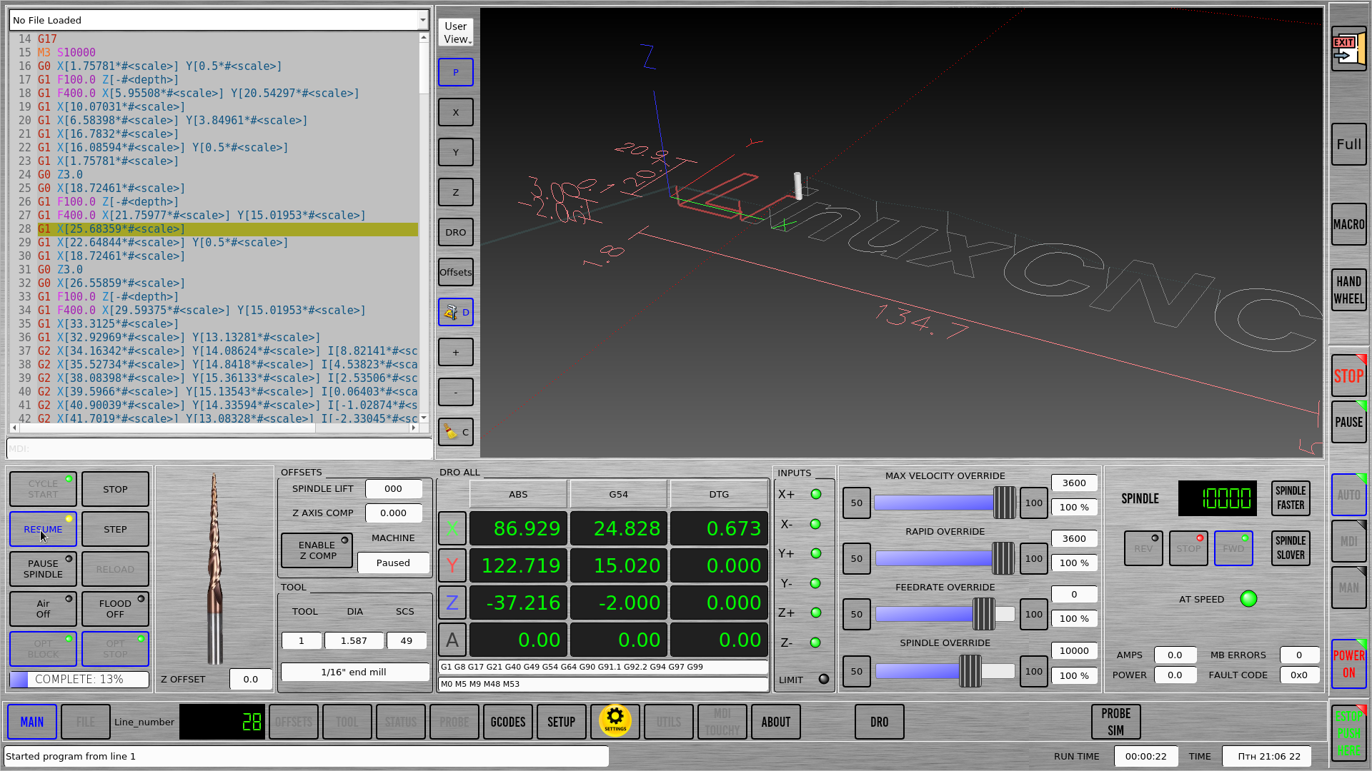

Yes ! That makes it much easier.
critiques:
- lots of labels don't seem to fit the buttons.
- what is numstr.py for?
- compensation.py is already on the system is your version different?
- are the tool icons copyrighted?
- what is woodpecker_ folder for?
- is there instructions for zlevel.py ?
Chris
critiques:
Chris

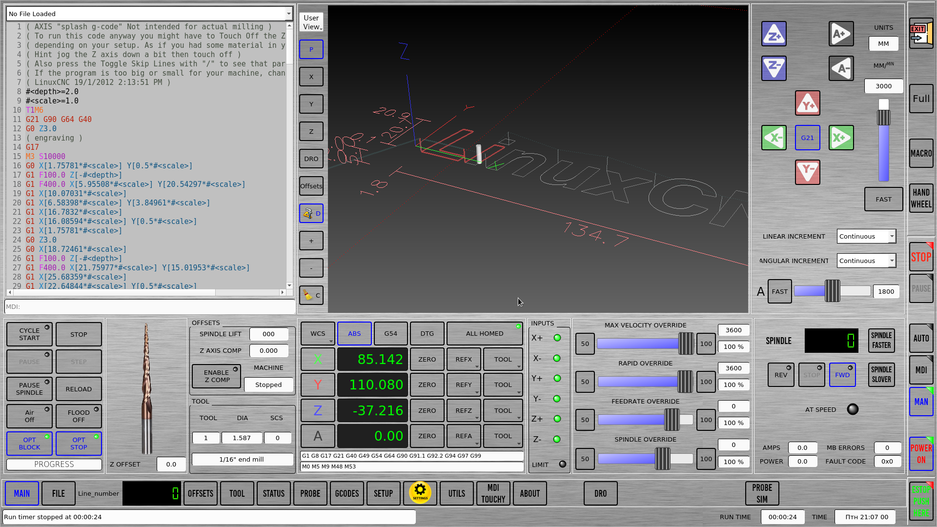

06 Feb 2023 06:24 #263799
by hottabich
- numstr.py is needed for line_number.txt, remembers the line number when the machine stops. - compensation.py works together with zlevel.py instruction in help_files button about.
- tool icons are taken from this forum, the folder can be left empty except for tool_icons.txt, let the user fill it in for himself.
- files from the 1280x1024 folder turn the interface into the appropriate format, everything else is fine how to do it right, your help is needed. Thank you for your attention!

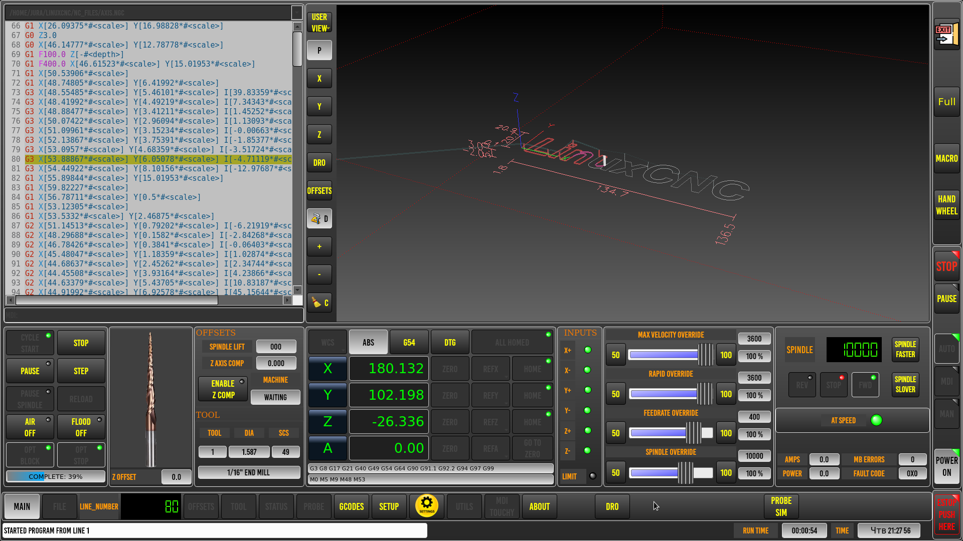

09 Feb 2023 19:40 #264161
by hottabich
Replied by hottabich on topic woodpecker intergration

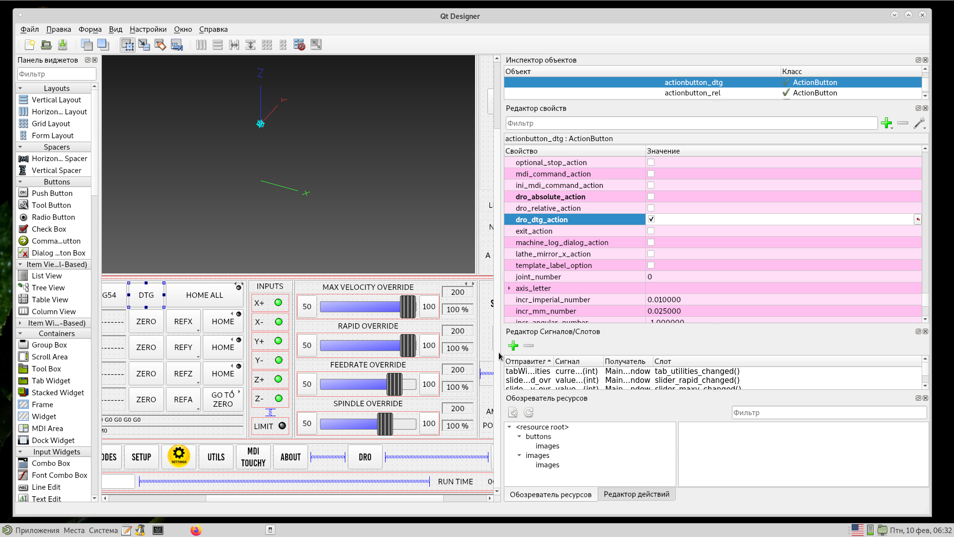

Hello! Please tell me how to make it so that when you press the Dro button, the ABS, G54, DTG buttons are turned off. When they are pressed, the work of the DRO ALL tab is broken. Thank you!
- Posts: 7367
- Thank you received: 2181
10 Feb 2023 04:02 #264199
Replied by cmorley on topic woodpecker intergration
can you not setEnabled(False) the buttons?

Sorry, but it is necessary to disable not the button itself, but its function. Thank you!
- Posts: 7367
10 Feb 2023 04:53 #264201
You want the buttons enabled but not actually do anything?
- hottabich
- Posts: 574
- Thank you received: 96
10 Feb 2023 05:20 #264204
by hottabich

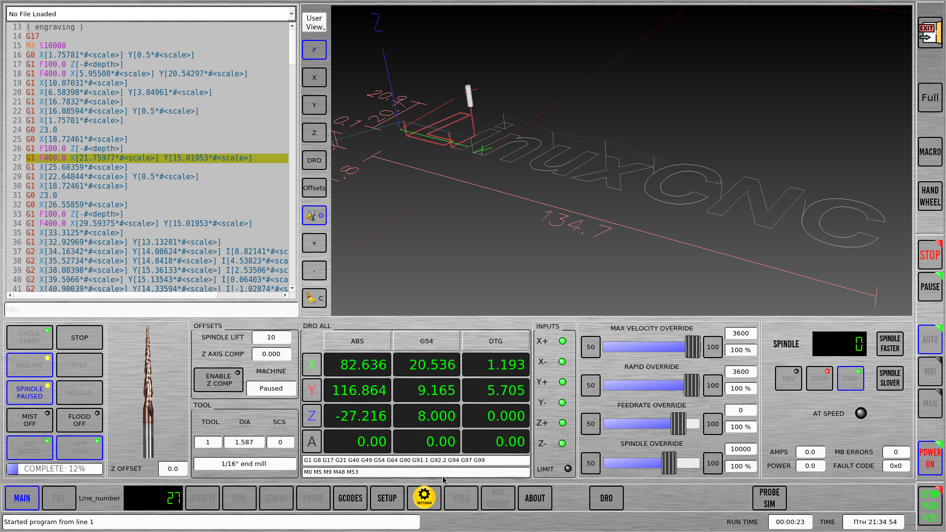

I want to get two DRO tabs to work independently.
- Posts: 7367
10 Feb 2023 05:52 #264205
Ahh I get it.
next update has DRO property added:
follow_reference_changes
set it to false in designer and it won't change.
- hottabich
- Posts: 574
10 Feb 2023 19:50 #264243
by hottabich

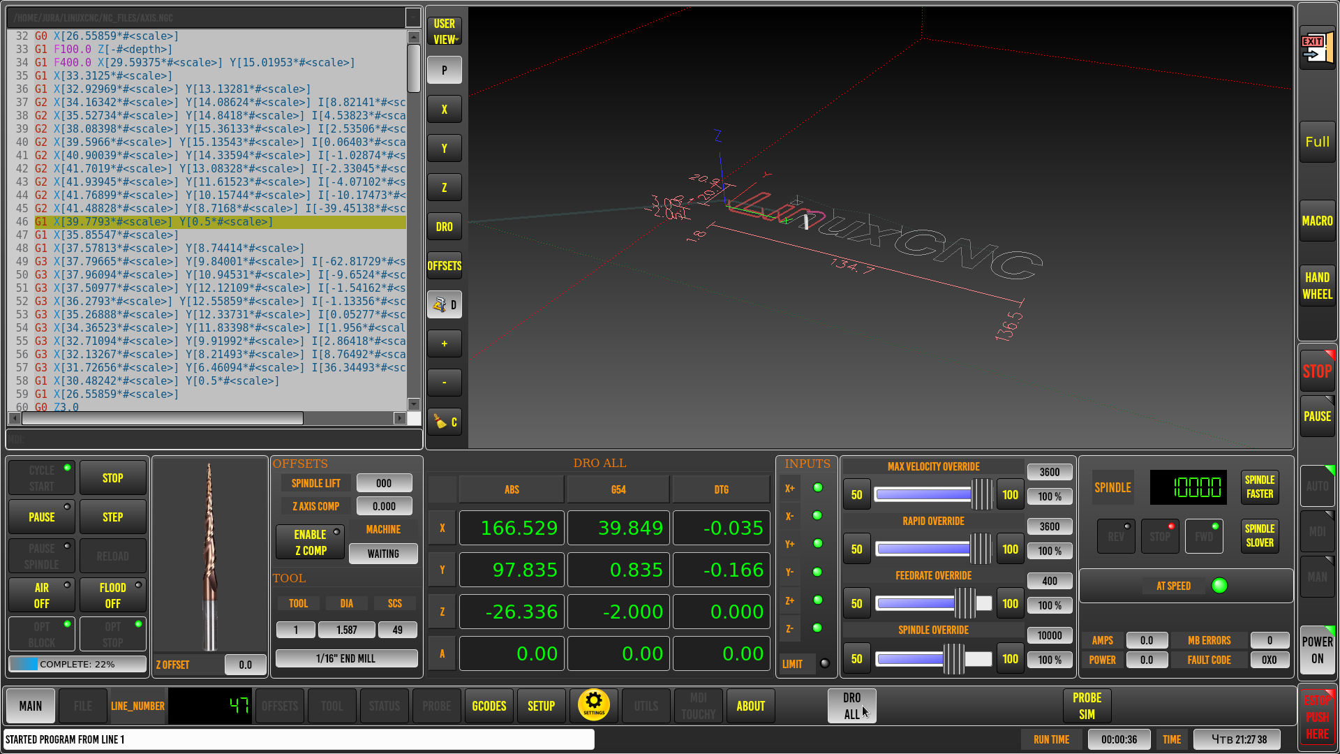

After the update it works great. Switching occurs at status AUTO. Maybe someone will fit. Thanks a lot.
