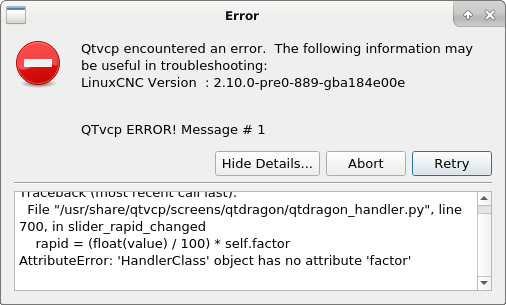

by Dragonick
QtDragon GUI QTvcp ERROR! Message # 1 was created by Dragonick

Replied by cmorley on topic QtDragon GUI QTvcp ERROR! Message # 1
Looks like you are using master not 2.9.
Can you run linuxcnc in a terminal and post any output?
posting your config files might be helpful too please.

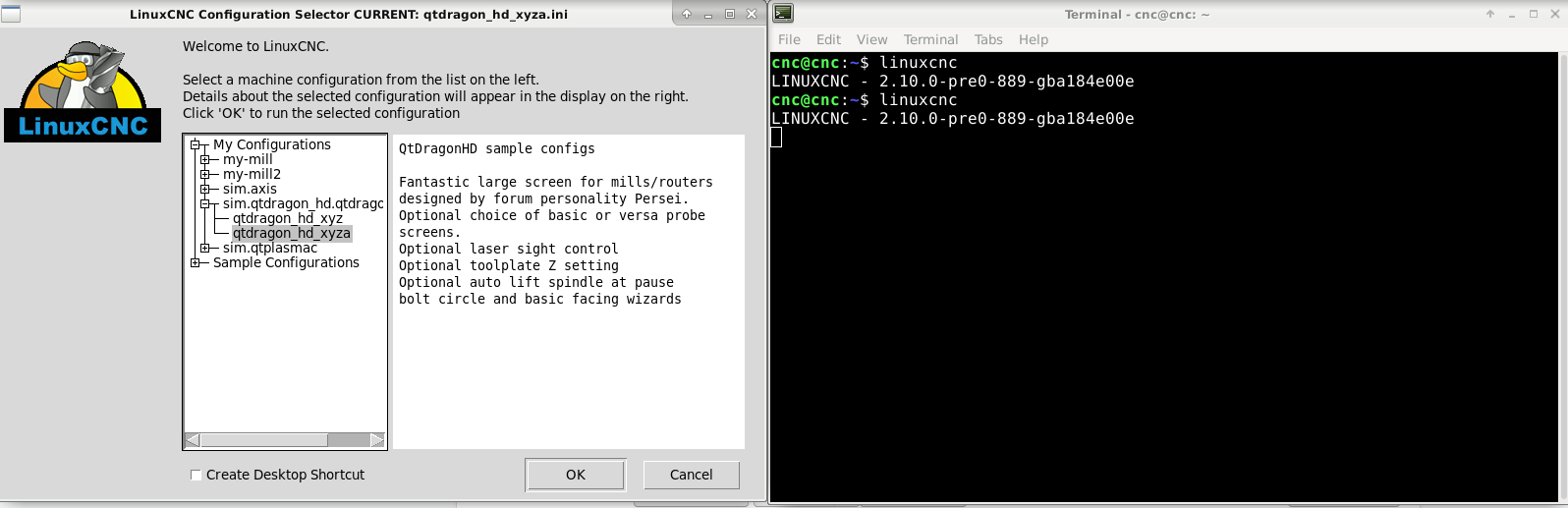

I installed 2.8.4 buster from iso. Later I upgraded to master. ( my mistake i took the example from the 2.9 update video )
then I installed Python 3.7, Qt 5 and then Install QtPyVCP. I had to manually install pip3 numpy because some error popped up.
When I open via CNC-LinuxCNC-sim.qtdragon_hd then it starts. One when I created the configuration via Stepconf and rewrote all the data as in the example:
linuxcnc.org/docs/devel/html/gui/qtdragon.html
this pops up the error seen in the first post.
Can you tell me how to post any output to you?
If I type linuxcnc in the terminal, this is what I get:

20 Feb 2023 19:28 #264892
by Dragonick
Replied by Dragonick on topic QtDragon GUI QTvcp ERROR! Message # 1

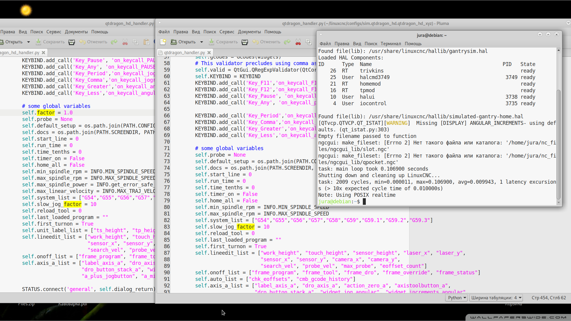

- hottabich
- Posts: 574
- Thank you received: 96
20 Feb 2023 21:28 #264906
by hottabich
Replied by hottabich on topic QtDragon GUI QTvcp ERROR! Message # 1
Look at the screenshots, maybe it will help you.
The Qtdragon error is not the real problem. It shows because linuxcnc didn't initialize properly.
