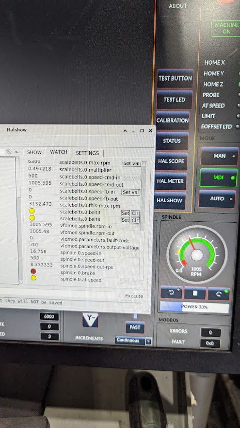

QTDRAGON: Spindle speed is incorrectly set was created by rodw
Please refer this issue: github.com/LinuxCNC/linuxcnc/issues/2447
Where a gearbox or belt drive is between the spindle motor and the spindle, the spindle RPM displays the motor speed not the spindle speed
This is because the wrong pin is sent to the GUI
The correct pin is spindle.0.speed-out (already scaled to RPM)
QTdragon uses spindle.0.speed-in which is the motor speed (in RPS), not the spindle speed.
Here is the result of a M3 S500. Spindle speed is correctly set to 500 rpm as confirmed by a digital tachometer.

24 Apr 2023 03:31 #269738
Replied by cmorley on topic QTDRAGON: Spindle speed is incorrectly set
spindle.0.speed-in should be spindle RPS, not motor speed.

Replied by rodw on topic QTDRAGON: Spindle speed is incorrectly set
Yeh, I have to review this tomorrow when at the machine. It looks like I included a feedback pin in my gearbox component 12 months ago that outputs the inverse of the gearbox scaling for this purpose that has never been connected. Hopefully it is an easy fix!
Sorry about raising the issue. I shoulda stuck to the spindleless plasma world!
