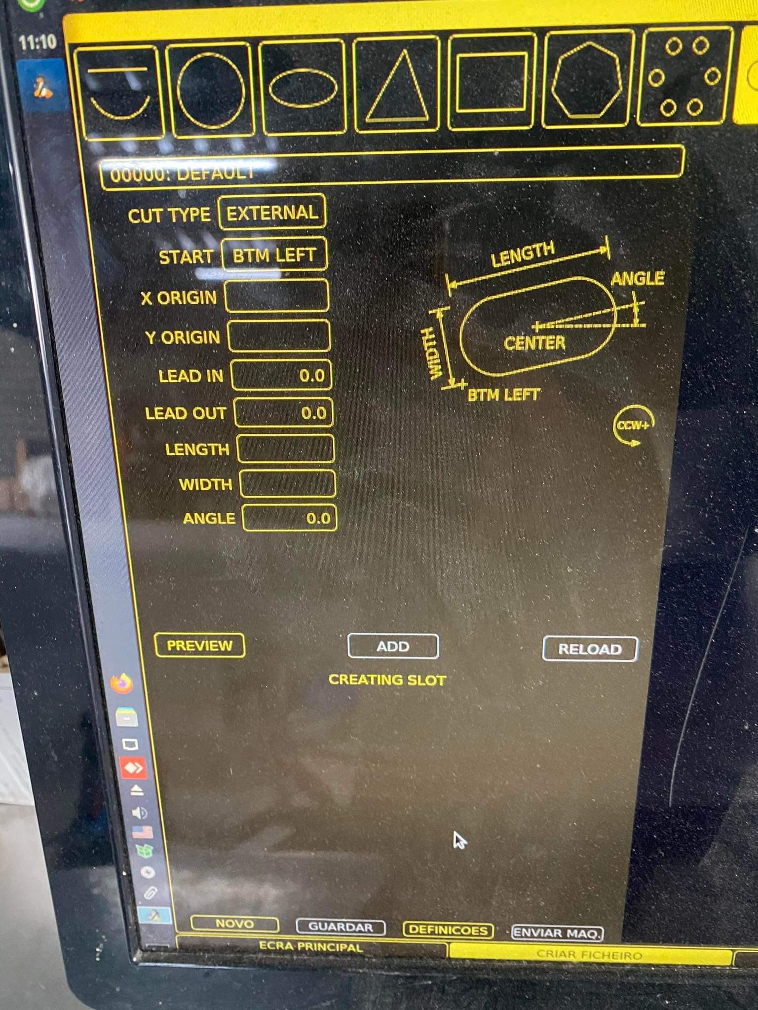

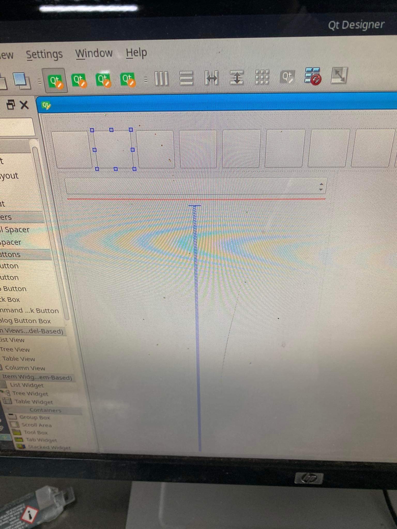

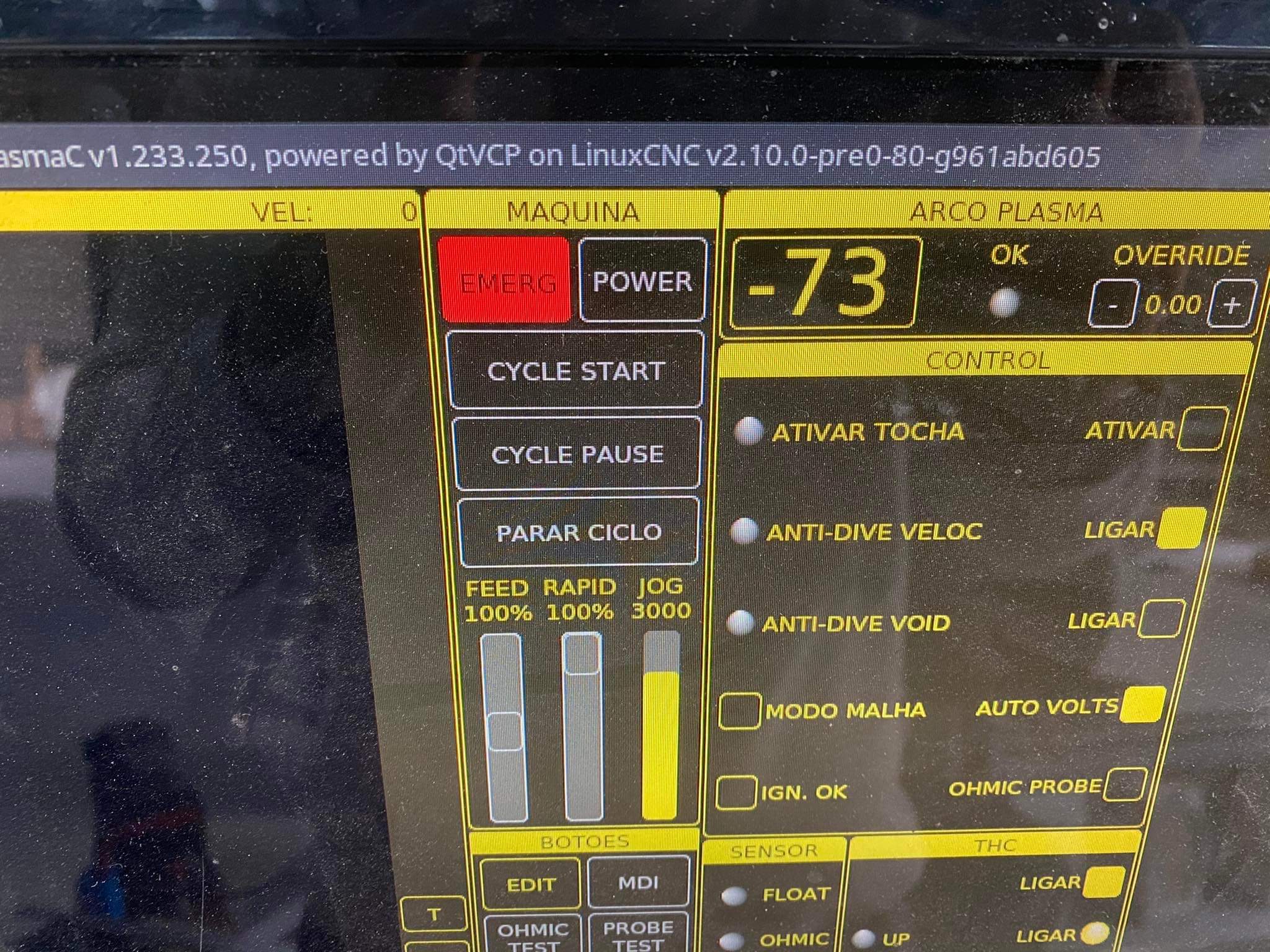

Hello point I have had success changing the main screen and some button labels on qtplasmac, but i cannot change the conversational tab because most of the buttons are not reachable.
my main goal is to translate the program, having achieved to translate the main screen and the parameters, and settings tab, but I’m having trouble with the conversational. Where are the files? The conversational tab just appears blank as there are multiple available menus here.Thank you!

The conversational widgets are hard coded in conversational.py which in a run in place build is in linuxcnc-dev/lib/python/qtvcp/lib/qtplasmac/

Yes I have seen that. but the text strings from conversational are not available there.

It’s weird because the .ui file must be getting that info like “rectangle” , “width”, “height” etc etc from somewhere but i cant seem to find it.
