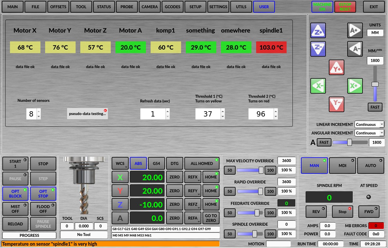

I have my own panel, is it possible to apply a separate qss theme file to it? so that it takes precedence over the main qtdragon theme to set the font size independent of the main qtdragon theme. If so, how to do it?

There is no way to add a second, separate theme file.
The trick is to reference the widget's name in an editted QSS file.
Something like this:
#label1_name, #label2_name {
font: 25pt "Lato Heavy";

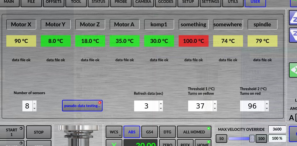

Great. The method you came up with works, albeit with a small problem.
I have an entry that in the main qss file works fine, but in the user_file.py file
only the "QLabel#labelinfo_motor_" entries work, while the "QLineEdit" fields do not want to change the font size.
I have no idea why that is.

It still didn't want to work as it should, I managed to do it a little differently, probably in the simplest way possible. In my handler file "motor_info_handler.py" I just added this entry and it works as I wanted.
self.w.setStyleSheet('''
IndicatedPushButton{
font: 10pt "Lato Heavy";
QLabel{
#labelinfo_motor_1,
#labelinfo_motor_2,
#labelinfo_motor_3,
#labelinfo_motor_4,
#labelinfo_motor_5,
#labelinfo_motor_6,
#labelinfo_motor_7,
#labelinfo_motor_8,
#lineEdit_motor_1,
#lineEdit_motor_2,
#lineEdit_motor_3,
#lineEdit_motor_4,
#lineEdit_motor_5,
#lineEdit_motor_6,
#lineEdit_motor_7,
#lineEdit_motor_8{
font: 16pt "Lato Heavy";
The downside is that it does not inherit anything from the main style, each element must be defined.
The advantage is simplicity, and you don't have to restart qtdragon after changing the style like before.
