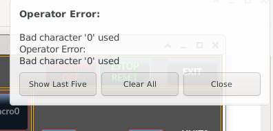

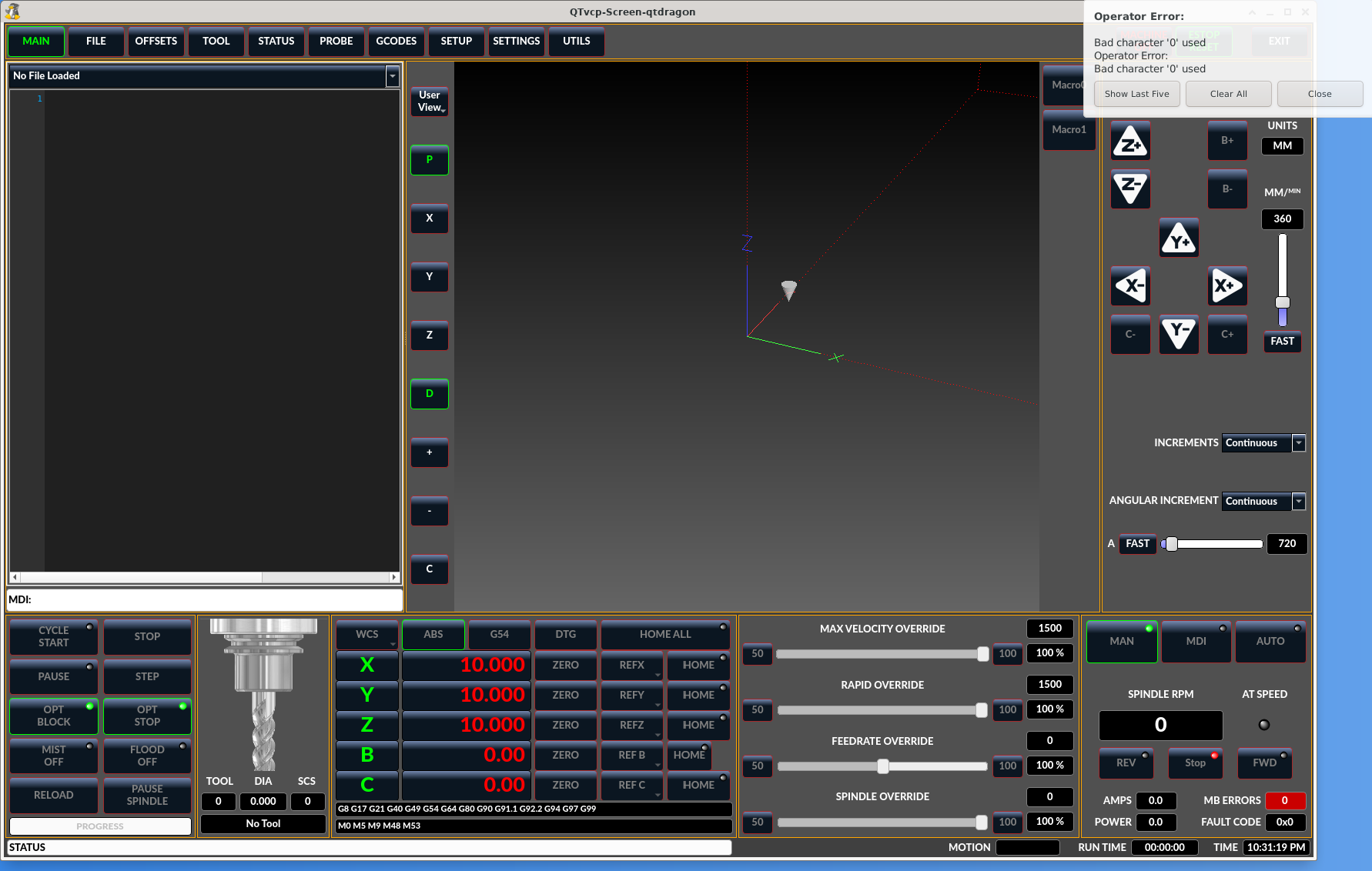

I'm having an error pop up, but if I click close, everything seems fine.
So it's a low priority... but... what the heck is it?
When I click the ESTOP - Set button, or the ESTOP - Rest button, or the Machine On button (but not the Machine Off button, ie, I'm turning it from On to off) I get a small modal window message: Operator Error, Bad Character 0 used. There are three button options: Show Last Five, Clear, and Close. If I Close or Clear the message box closes, and if I'd clicked Clear then the next time the message box appears, there's only one "bad character 0" line.
I'm on LinuxCNC ver: 2.9.0~pre1.1076.gcb0aa52ce, & Debian 12

Is this a sample config or your own ?
Do you have an 'on_abort' file in the config folder. it would be called in those button situations - maybe there is an O instead of a zero somewhere.
reading the terminal text after running from a terminal may give a clue.

It is my own.
I do have an "on_abort.ngc" file, copied from the QTDragon install page, and located in the configuration subdirectory nc_subroutines.
Though that error appears, the machine so far seems to be operating (ie, it's jogging), but I'm still trying to set up and use the probe routines.

Quick update, I found the text for "bad characters" leads to the .po file /src/po/pt_BR.po
This tells us I'm creating the error in the [RS274NGC] section, as src\emc\rs274ngc\interp_read.cc is attempting to read that block in the .ini file.
First question: why does this line read:
Because the error "Bad character '0' used" seems to kinda point the 0 on that line.
In the .ini file. it's clearly a 0 (zero) not a O (letter o). (I even re-typed it by hand to be sure there wasn't some kind of invisible ASCII character in there, no luck.)
Second question: on the website linuxcnc.org/docs/devel/html/gui/qtdragon.html
the first line of the Subroutine_path = ends in a semicolon (
, should it end in a colon? (
like the next line?
And also, the default path for remap_lib seems to have changed: it no longer includes ngcgui_lib.
Sadly, changing/fixing/or breaking those lines in subroutine_path do not change the error message behavior.
I couldn't attach my on_abort or preferences file to the previous post, so I've attached them to this one.
Also, I made changes to the .ini to try and fix this, but since they don't fix it, I'm attaching the updated .ini file as well.
ON_ABORT_COMMAND=0 <on_abort> callBecause the error "Bad character '0' used" seems to kinda point the 0 on that line.

Doh!
So it is supposed to be an O (as in OMG) and not a 0 (as in, I'm a zero)... I clearly got it confused.
I've changed that around, and now that error message is gone.
Sorry for the text wasted.
