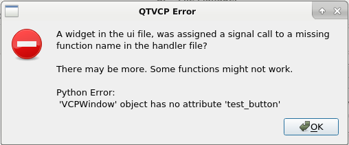

I am starting a custom Qtvcp screen from scratch and I need help with connecting to a slot created in the .ui file. I followed the directions in the in the linuxcnc tutorial:
linuxcnc.org/docs/devel/html/gui/qtvcp.html
I created a push button and connected the clicked signal to the main page slot, test_button(). In the handler file I created a function, def test_button(self): in the HandlerClass():
Obviously I need help fixing the problem, but can some help explain how these files are even connected. I have a class (HandlerClass) in the handler.py file and I don't even know what program is creating an object from this class. I can only guess it is from the .hal file but I don't know where. And since the QT screens are built from the QMainWidget class, I don't know how a function in the HandlerClass would ever find a slot called test_button() coming from a .ui file. I hope that makes sense.

You have tabs mixed with spaces. Python is very picky about this.
It made the test_button function be outside the handler file context so it wasn't seen.
I removed the tabs and change them to spaces - works now.
When doing python work I configure my editor to make the tab key add 4 spaces rather then one tab.
Qtvcp imports the handler file into the window object then loads the ui file which tries to connect the signals.

I gave up on connecting signals in the ui file. Whenever you move a widget around, the connection is lost and you have to redefine it. So now I just use a seperate connections class that defines all the signal/slot connections. The handler imports the connections class and creates an object when it's ready for the connections to be made. You could also just include it in the handler, but having a separate module makes it ..... modular.

Thanks for the help. You are absolutely right about Python being picky and I have been learning all the rules. It ended up being a signal that was hidden or not connected to anything but it was still being created. Either way I finally found it.
