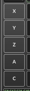

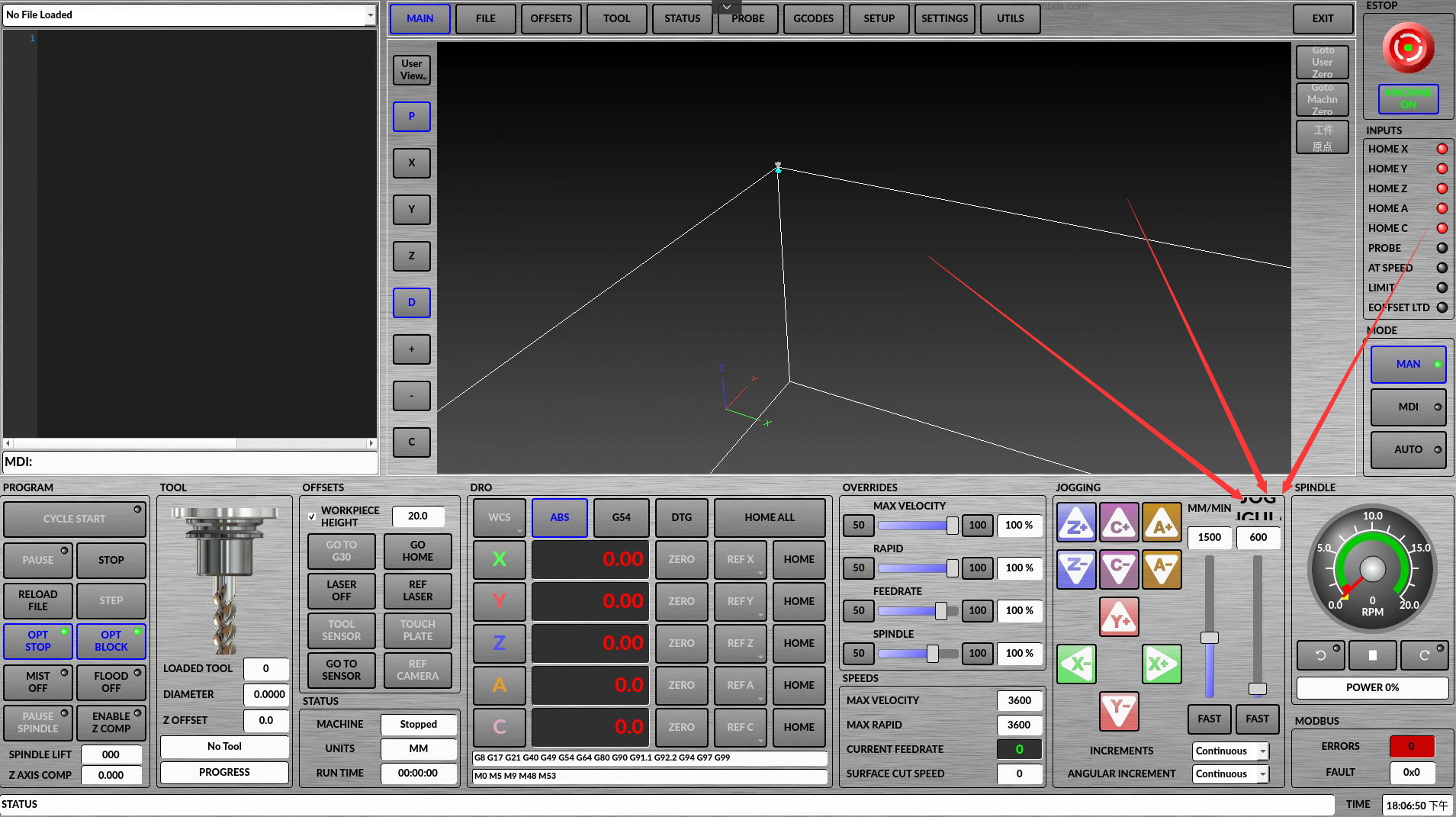

The back two borders do not coordinate with the front
Edit dark_ Grey.qsschange to
perfect
There is also this error in dark.qss and metal.qss
This method is limited to repairing dark_grey.qss
Edit dark_ Grey.qss

brushed_metal_color.qss is common to qtdragon and qtdragon_hd, in qrdragon the inscription is short and in one line, that's why it looks like this. I will make corrections during the next qtdragon update..
