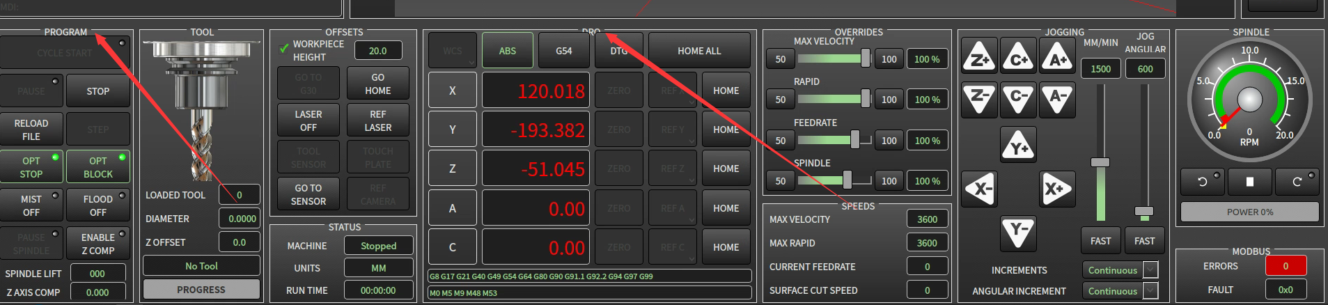

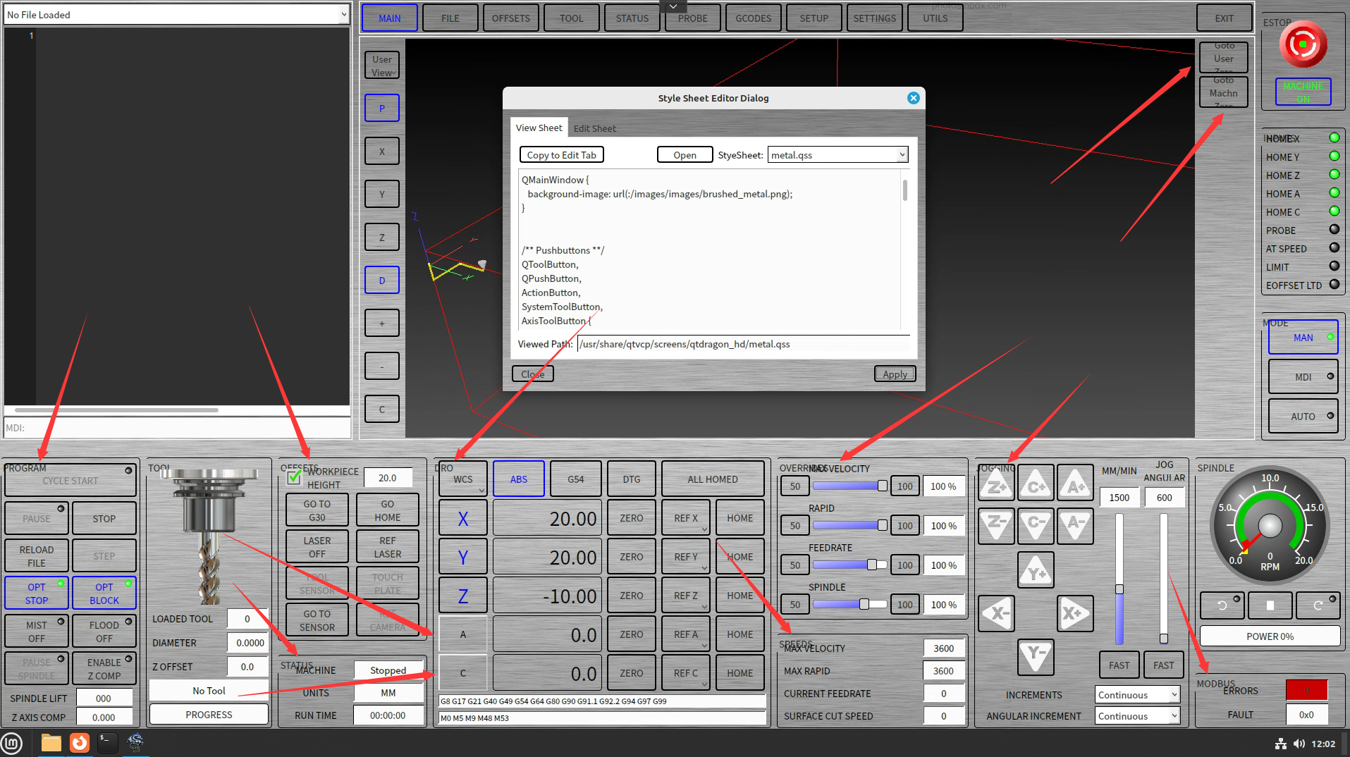

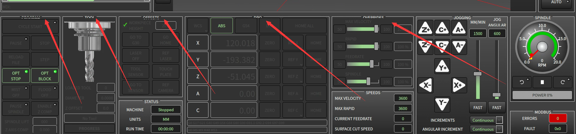

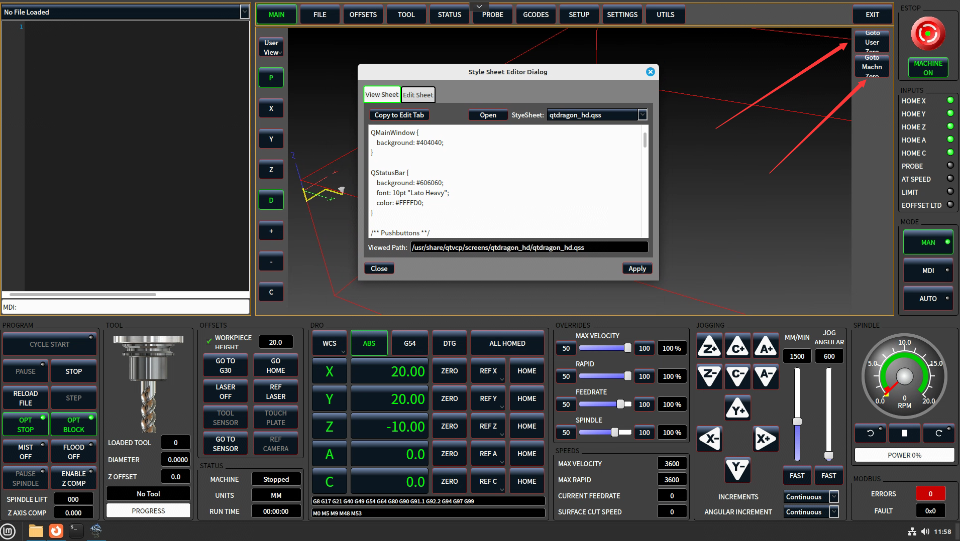

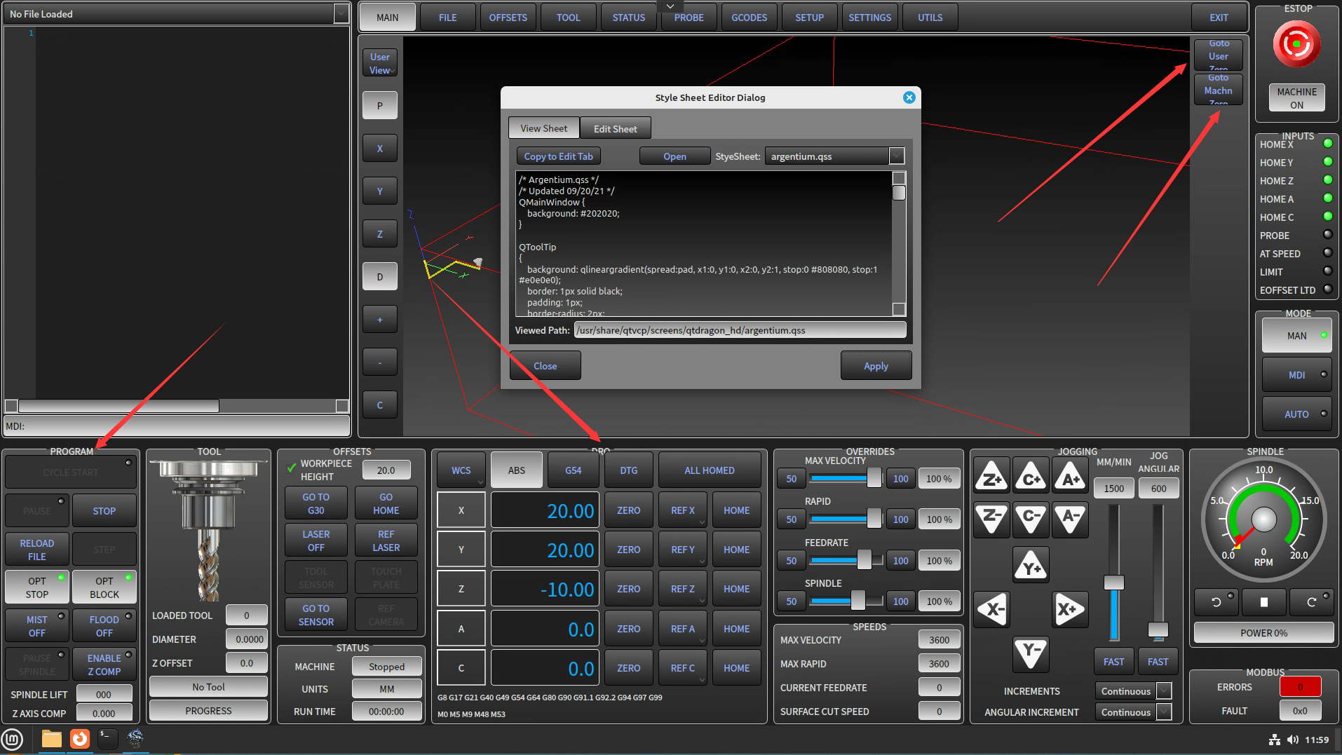

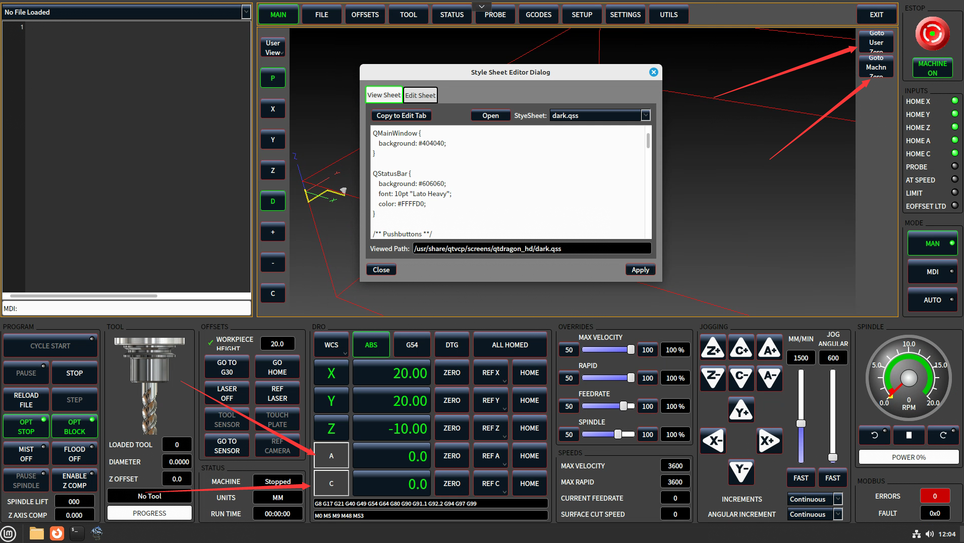

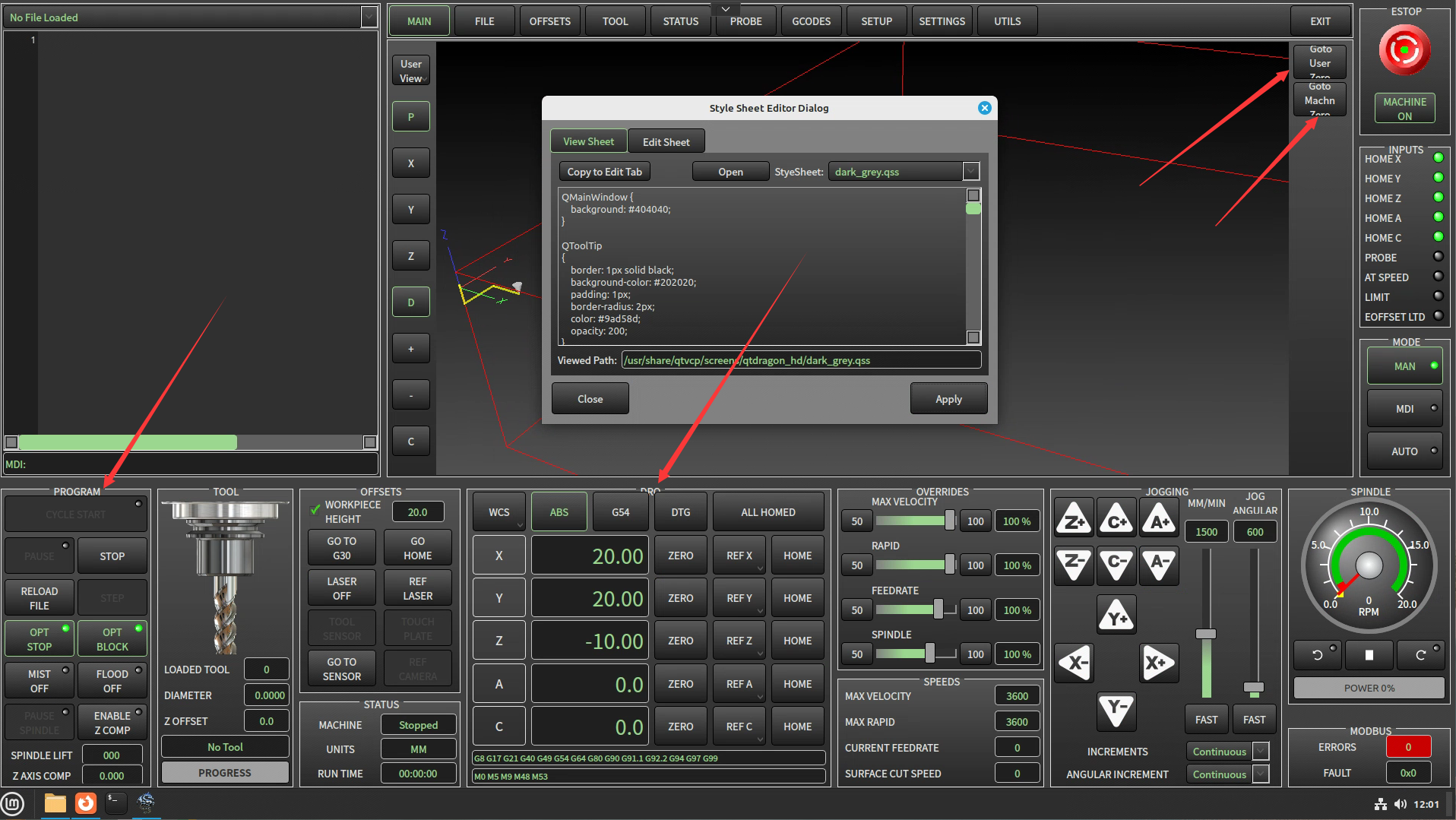

qtdragon_hd Some qss labels are misplaced and the display is incomplete.
My operating system: lmde6
Linuxcnc version: 2.9.0-26-ge51d14e42
Also, how do I make it fully display on a 1080p screen? Now the bottom is blocked by the panel.
Affected are
qtdragon_hd.qss
argentium.qss
brushed_metal_color.qss
dark_grey.qss
metal.qss
dark.qss
Affected are
qtdragon_hd.qss
argentium.qss
dark_grey.qss
metal.qss
dark.qss

This is not convenient

Add -f to enable 1080p full screenadding -f to the qtdragon loading line in the INI may help.
DISPLAY = qtvcp -f qtdragon_hd
There are two phenomena when turning on the power and turning off the power.

Changing the theme doesn’t change anything, it’s still misalignedJust a stab in the dark, but try changing the desktop theme from the preferences menu.

qtdragon_hd has static dimensions and needs 1080px in height.
When it comes to macro buttons, you can reduce the font, change the text that should be displayed in the ini file, or change the size of the button in qtdesigner, or use the qtdragon_hd.ui file, which I just modified to make the macro buttons larger, and the bottom bar has also been improved.
Two themes have also been improved.
