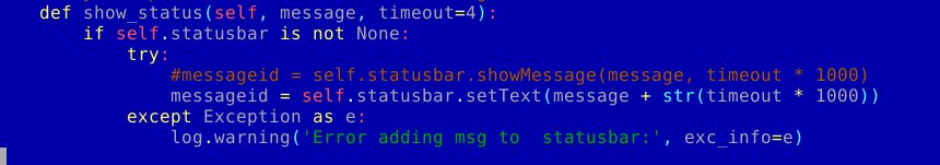

2023-10-26 02:21:42,446 - QTvcp.QTVCP.LIB.NOTIFY - WARNING - Error adding msg to statusbar:
File "/usr/lib/python3/dist-packages/qtvcp/lib/notify.py", line 271, in show_status
messageid = self.statusbar.showMessage(message, timeout * 1000)
AttributeError: 'QLineEdit' object has no attribute 'showMessage'

Some things were changed in master that seems to make qtdragon susceptible to race conditions on startup. Some discussion:
github.com/LinuxCNC/linuxcnc/issues/2700
and here:
forum.linuxcnc.org/qtvcp/44747-error-in-...setview-py?start=220
Can you run linuxcnc from a terminal and post the output (when it has failed) ?

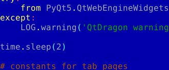

Could you try editing the handler file?
In the qtdragon_hd_handler.py file, usually located in /usr/share/qtvcp/screens/qtdragon_hd/. Add "time.sleep(2)" entry,
just like in the screenshot.
Another error I see is in the /usr/lib/python3/dist-packages/qtvcp/lib/notify.py file. I don't know if other gui's also use the notify.py file. In qtragon_hd the status bar is now the same as in qtdragon, it is of the "QLineEdit" type, therefore showMessage causes an error. After modifying the line as in the screenshot, it works properly.
Chris, can you verify this?

Oh, it seems adding this delay code really works.
I have tried several times and there were no more errors reported.

FWIW, QtPlasmaC uses the statusbar. I can check later to see if your changes affect us, and what we would need to change if it does.
Replied by snowgoer540 on topic QTdragon HD with MDI issue

I thought of this:
def show_status(self, message, timeout=4):
if self.statusbar is not None:
try:
except:
try:
messageid = self.statusbar.setText(message)
except Exception as e:
log.verbose('Error adding msg to statusbar:', exc_info=e)
