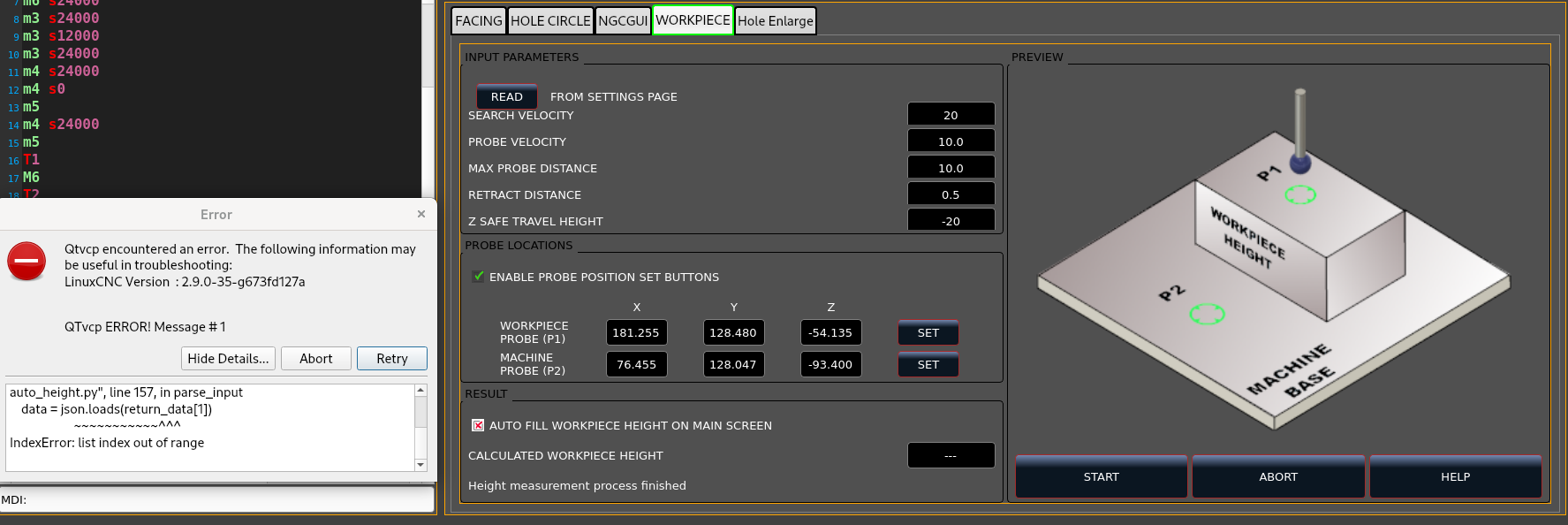

Hello all,
I am trying to use the probing system to set my workpiece height from table (Utils -> Workpiece).
It start as it should by going at the workpiece probing location, do a first "rapid" probe and then back off and do the second "slow" probe.
And as soon as the second probe is trigger, I got a crash :
File "/usr/lib/python3/dist-packages/qtvcp/lib/auto_height/auto_height.py", line 128, in read_stdout
self.parse_input(line)
File "/usr/lib/python3/dist-packages/qtvcp/lib/auto_height/auto_height.py", line 157, in parse_input
data = json.loads(return_data[1])
IndexError: list index out of range
Am I doing something wrong ?
Thank you.

Replied by cmorley on topic QtDragon_hd - Workpiece probe error
You are not doing anything wrong. I'm sorry it's a bug.
What version of linuxcnc are you using?
Chris
Chris
I have pushed the fix to the 2.9 repo.
I think you are using the official Debian package?
unfortunately I have no idea when that will be updated.
linuxcnc has officially released 2.9.1.
forum.linuxcnc.org/29-forum-announcement...was-no-2-9-0-release
Which might be better in the long run.
Chris
I have but I'm not sure when it will be released next.
github.com/LinuxCNC/linuxcnc/commit/5fa8...0ef86b0ea74227362841
compiling source always allows you the latest code, but eventually the buildbot will catch up.

Just got it from the buildbot2, now it's working.I have but I'm not sure when it will be released next.
I don't understand why I always need to download *.deb file manually and install them. Buildbot2 does not work from synaptic package manager.. But that's out of the scope of this post.
Thank you for the fix.
