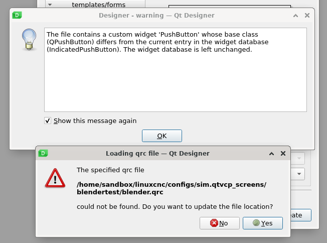

Could use a little help here - trying to get Qt designer working on a VM to do a little GUI work.
- Setup Deb 12.2 on a VM.
- Installed LCNC from the script in the user manual.
- sudo apt update/upgrade
- Followed Qt Designer installation in user manual, including symbolic link to qtvcp_plugin.py.
- Qt Designer loads ok, LCNC widgets show up in the tools.
- qtvcp copy
- copied "tester" and "blender" to configs/sim.qtvcp.screens
- start Qt Designer from terminal and choose brendertest.ui
- Error message pops up (screenshot attached)
- Select "No" and Qt Designer aborts
- Select "Yes", then select blendertest.qrc and Qt Designer immediately aborts
sandbox@sandbox:~$ designer -qt=5
Qtvcp python plugin found: /home/sandbox/.designer/plugins/python/qtvcp_plugin.py
[DEFAULT][INFO] Logging to: /home/sandbox/default.log (logger.py:107)
tool_mmap_user(): tool mmap not available
poll(): continuing without tool mmap data
link (updating variable file): No such file or directory
[DEFAULT.QTVCP.WIDGETS.OVERLAY_WIDGET][DEBUG] last removed: <qtvcp.widgets.screen_options.ScreenOptions object at 0x7f9a0161e050> NEW:<qtvcp.widgets.screen_options.ScreenOptions object at 0x7f9a0161e050> (overlay_widget.py:69)
File "/usr/lib/python3/dist-packages/qtvcp/widgets/simple_widgets.py", line 649, in paintEvent
self.paintIndicator()
File "/usr/lib/python3/dist-packages/qtvcp/widgets/simple_widgets.py", line 669, in paintIndicator
gradient = QtGui.QLinearGradient(top_right- QtCore.QPoint(size, 0), top_right)
TypeError: arguments did not match any overloaded call:
QPoint(): too many arguments
QPoint(xpos: int, ypos: int): argument 1 has unexpected type 'float'
QPoint(a0: QPoint): argument 1 has unexpected type 'float'
Aborted
sandbox@sandbox:~$ ^C

Replied by cmorley on topic QtDesigner errors after install
If you are using the official Debian version of linuxcnc - it is very far behind in bug fixes.
I think you should switch to linuxcnc's buildbot version of 2.9.
I believe all these bugs are fixed.
