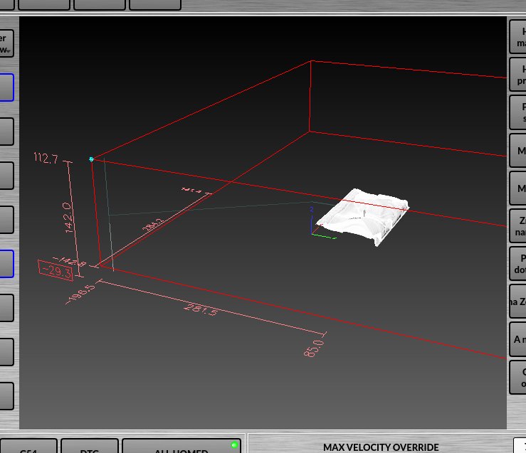

28 Jan 2024 22:43 #291845
by MarkoPolo
Replied by MarkoPolo on topic Manual tool measurement procedure
The tool measurement procedure works as I wanted,
but the dimensions are displayed in the preview window (as in the screenshot).
containing movements from the tool measurement procedure. Whether it is possible
displaying the dimensions of the workpiece itself?
Marek
Marek
