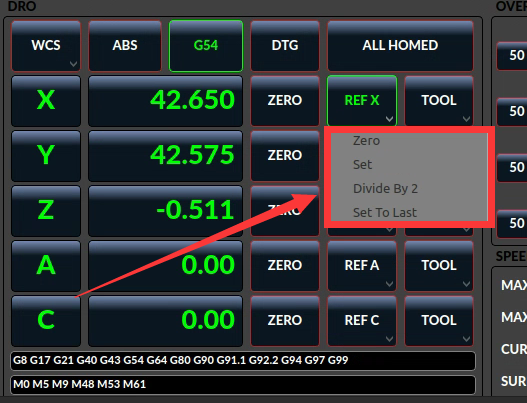

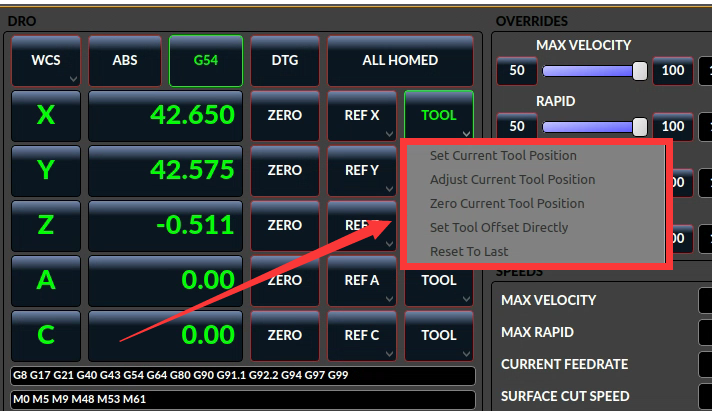

Does anyone know where these two texts were modified?

Does anyone know where these two texts were modified? was created by onceloved

You can use 'grep' in the linuxcnc source folder like this example to find certain places in code:
This command will give you the location:
This command
user@Computer:~/linuxcnc-dev$ grep -rnw ./ -e 'Adjust Current Tool Position'./docs/src/gui/qtdragon.adoc:1142:* Adjust Current Tool Position
./lib/python/qtvcp/widgets/offset_tool_button.py:54: Button = QAction(QIcon('exit24.png'), 'Adjust Current Tool Position', self)

/usr/lib/python3/dist-packages/qtvcp/widgets/axis_tool_button.py

Thank you. I want to copy the axis_tool_button.py and offset_tool_button.py files to the local configuration. How can I make the modified files take effect? I don’t want to mess with the system files.

Thank you. I have found it and am trying to modify it....

Qtvcp has no built in way to allow users to load local replacement widgets.
In the longer run, we should put effort into internationalization I suppose.
