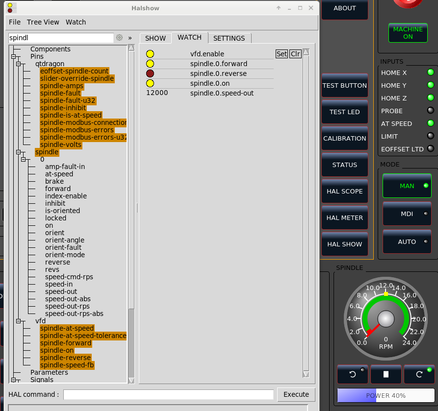

Start the spindle manually in qtdragon, then using halmeter can you check:
vfd.enable is true
spindle.0.forward or spindle.0.reverse is true
spindle.0.on is true
spindle.0.speed-out is getting a command number
Also do you still have the gmoccapy HAL code? are you using the same hardware? A reference to the vdf HAL code might help me.

So this afternoon i moved all the qtdragon to the postgui_halfile.
and i got the power bar to work.
every thing works as it should. when i run a file linuxCNC waits for the spindle to come to speed. i just dont have any indication of the actual speed.
