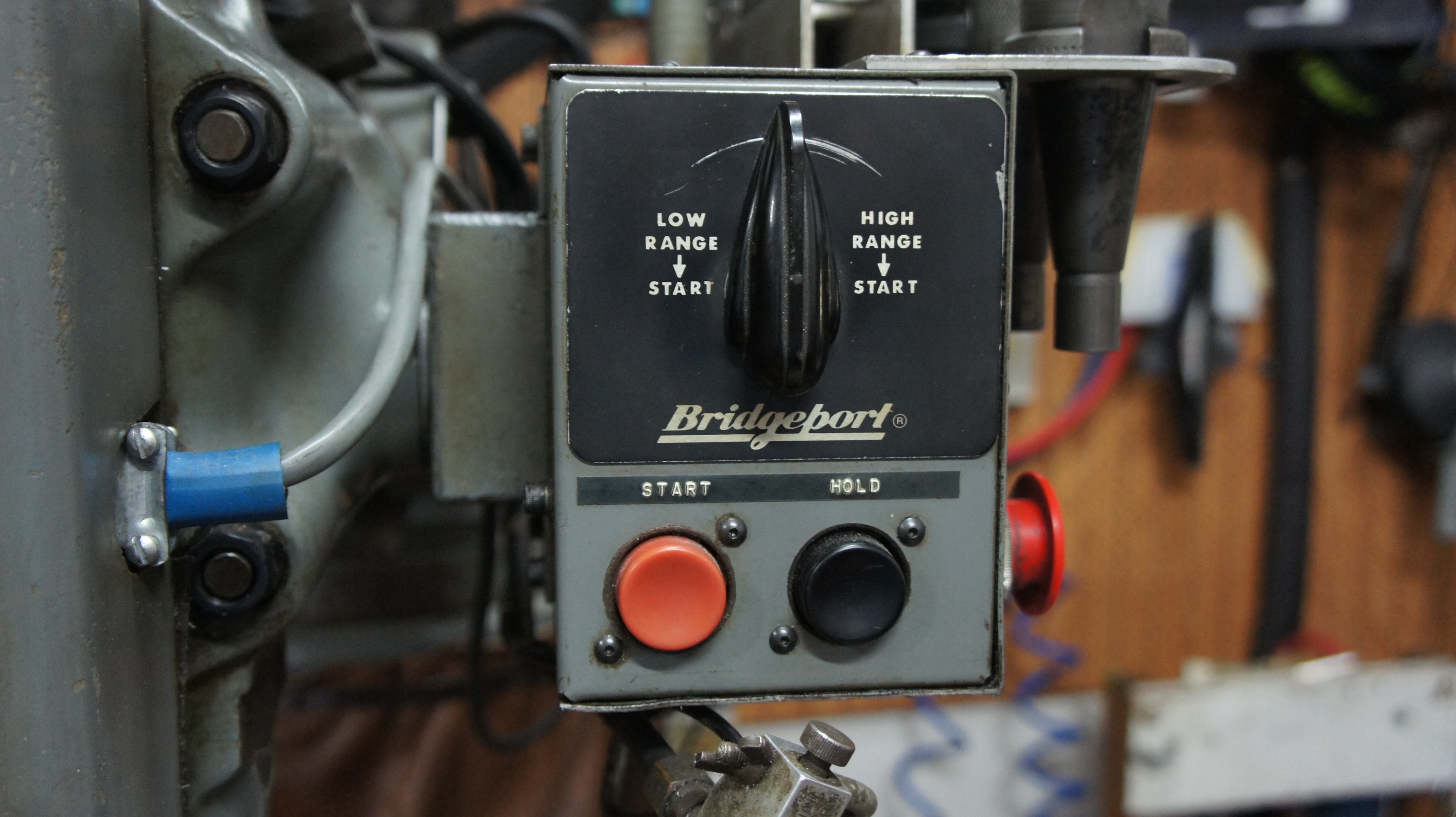

My Bridgeport conversion has this control.
Originally, turn the oblong black knob left or right to get clockwise and counterclockwise spindle rotation. The red button stopped a running program. The black button would pause/step a program.
I've wired these to my Mesa board so that:
But, it's working. Turn the knob and the spindle runs, and the correct button lights up in qtdragon_hd. Move the knob to center and it keeps running though. If I stop it via the UI, it will stop even if the knob is still set to run.
- red button triggers hm2_7i96s.0.gpio.001.in_not
- black button triggers hm2_7i96s.0.gpio.002.in_not
- knob left triggers [HMOT](CARD0).inm.00.input-03.
- knob right triggers [HMOT](CARD0).inm.00.input-04
- knob center triggers nothing
Not sure why there are two pins from the Mesa giving the same value, but. . .

How do you want the spindle switch to work with GUI controls? Most of the controls work by 'last comnand wins'. As they are supposed to be momentary signals.

"Last wins" is kinda where I have to go. The knob triggers on the rising edge. If I leave it on forward or reverse, I can then use the GUI buttons to turn it off. In fact, moving the knob back to center does nothing. The only way to turn the spindle off is with the GUI button. Maybe I need to AND the NOTs of forward and reverse together, and have that trigger off? Would I be able to start it from the GUI then?

Is there an electrical connection for the center knob?
probably not but then you could connect this to HALUI spindle off.
Or yes add logic to the fwd/rev inputs. You could use a mux or ladder logic or probably other HAL logic to set halui spindle stop if both fwd and rev are off. You should be able to turn off from the screen too - just the knob would indicate wrong.
properly planned external button control is something i should work on for qtdragon.

Adding the external button control to qtdragon MAY be simpler, or it MAY make the overall system more complicated. I think this can already be accomplished with halui.
Please, check my math here.
I have the inputs for forward and reverse tied to halui.spindle.0.forward, and halui.spindle.0.reverse. Halui repsonds to these pins on the RISING edge. The implication is that once turned on to either side, halui doesn't respond to the pin again.
Halui responds to that rising edge by setting halui.spindle.0.runs_forward and halui.spindle.0.runs_backward. I feed these into a mux4, which selects one of four given outputs based on the TRUE, FALSE combo. This value is tied to an mb2 component that pipes it to the VFD.
Given that, I need to update my HAL file with
loadrt and2 count=(1 + whatever was already there)
addf and2.N servo-thread
# --- SPINDLE-MANUAL-STOP ---
net spindle-manual-ccw-stop and2.1.in0 <= [HMOT](CARD0).inm.00.input-03-not
net spindle-manual-cw-stop and2.1.in1 <= [HMOT](CARD0).inm.00.input-04
net spindle-manual-stop and2.1.out => halui.spindle.0.stop
Considering that halui only responds on the rising edge, if I'm on either the forward or reverse setting, one of the and inputs will be false and the output will be false. When I move the knob back to center, the two nots will drive the and's output high, a rising edge, that will trigger halui to turn off both its runs_forward and runs_backward outputs.
From what I can see, qtdragon's forward and reverse buttons monitor runs_forward and runs_backward in order to highlight the buttons. By only responding to rising edges, halui makes it possible to have full control from either manual or gui interface.

Got it to work. In my main HAL file I have
# --- SPINDLE-MANUAL-CCW ---
net spindle-manual-ccw <= [HMOT](CARD0).inm.00.input-03
# --- SPINDLE-MANUAL-CW ---
net spindle-manual-cw <= [HMOT](CARD0).inm.00.input-04
net spindle-manual-cw halui.spindle.0.forward
net spindle-manual-ccw halui.spindle.0.reverse
net spindle-manual-stop halui.spindle.0.stop
I'm pretty sure that was there from the original configuration. In my custom_postgui.hal, I have
loadrt mux4 count=1
loadrt and2 count=5
# --- spindle control box setup ---
addf mux4.0 servo-thread
#use mux to send one of four values to vfd
#stop
setp mux4.0.in0 5
#forward
setp mux4.0.in1 1
#reverse
setp mux4.0.in2 2
#fault reset
setp mux4.0.in3 7
net spindle_forward_button halui.spindle.0.runs-forward => mux4.0.sel0
net spindle_rev_button halui.spindle.0.runs-backward => mux4.0.sel1
addf and2.4 servo-thread
net spindle_manual_ccw_stop and2.4.in0 <= [HMOT](CARD0).inm.00.input-03-not
net spindle_manual_cw_stop and2.4.in1 <= [HMOT](CARD0).inm.00.input-04-not
net spindle-manual-stop <= and2.4.out
I'll post a video of it working "real soon now".
