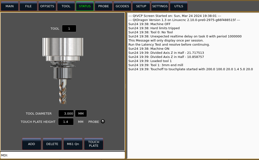

Hi all
I am running QTDragon on the latest buildbot ( LINUXCNC - 2.10.0-pre0-2975-g66f488515f ) & my toll touch plate (probe ) screen has stopped working.
This was previously working flawlessly & as far as I can tell noting has changed.
I load a tool & click on the probe button, the dialogue comes up & I click yes to probe but there is no motion from any of the axis.
There is also no error message that I can find & the probe light (& input ) toggle correctly.
Attached is a screen shot of the status screen & also the pertinent config files.
Does anyone have any idea why this is not working now & how do I go about trouble shooting this.
Alex

I think this is a case of different paths when using RIP vrs installed versions.
Probing works for me in my RIP dev version.
If you can try changing qt_pstat.py, aprox line 66
to:
I bet that would fix it.
# specific library paths
self.TOUCHOFF_SUBPROGRAM = os.path.abspath(os.path.join(
self.BASEDIR, 'lib/python/qtvcp/lib/touchoff_subprogram.py')) # specific library paths
self.LIBDIR, 'touchoff_subprogram.py'))I bet that would fix it.

Yes That fixed the problem.
