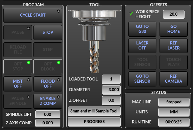

Hello everyone:
I got a problem when a use Qtdragon:
I used a button to start program on my panel, the configuration like bellow:
net program-run [HMOT](CARD0).gpio.014.in => halui.program.run
The program can start normally, but the "RUN TIME" timer don't running
if I push "CYCLE START" button on screen to start program, both program and timer running well
can i fix that?

Replied by cmorley on topic Qtdragon "RUN TIME" timer problem
I have no immediate solution for you.
There are a few possibilities that come to mind but would take code changes in Qtdragon.

The latest version of qtdragon uses the HAL TIME component to track program runtime. To use it in the current version, you would need code changes like Chris said. However, it you want to try the new version at github.com/persei802/QtDragon_hd you have to make a small change to the qtdragon_postgui.hal file. Find the lines with net run-start and net run-pause and change them to:This sample config does not use halui, but to enable it make sure you have the line HALUI = halui in the [HAL] section of the ini file.
Also, the latest qtdragon version is not supported on this forum so if you decide you want to try it, please direct any issues to the the github repo.
Jim
net run-start halui.program.is-running => time.0.start
net run-pause halui.program.is-paused => time.0.pauseAlso, the latest qtdragon version is not supported on this forum so if you decide you want to try it, please direct any issues to the the github repo.
