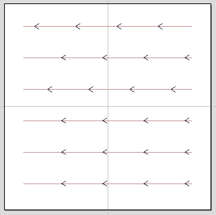

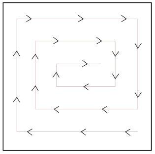

It took a little of extra time to get things working like I wanted. I've now got a side to side climb only facing routine, along with an always climb milling path moving inward.

- copy the new images to linuxcnc-dev/share/qtvcp/images/gcode_utility/
- mkdir <CONFIGDIR>/qtvcp/lib/gcode_utility/ and copy face.py and face.ui
- adjust qtdragon_hd_handler.py as appropriate
