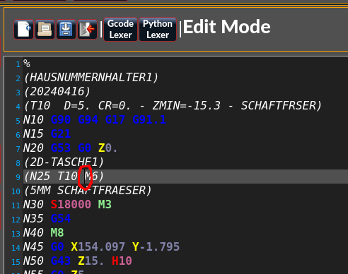

19 Apr 2024 13:35 #298654
by CADdy
changing color from cursor in g-code editor was created by CADdy
- Posts: 7368
- Thank you received: 2181
19 Apr 2024 17:33 #298680
Replied by cmorley on topic changing color from cursor in g-code editor
It is possible but is not so easy.
I will try to post a solution tomorrow and make it easier in the future.
Are you using linuxcnc 2.9?

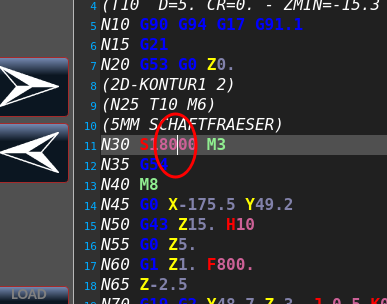

20 Apr 2024 08:20 #298726
Try this.
Save the file here on your system: YOURCONFIGFOLDER/qtvcp/screens/qtdragon_hd/qtdragon_hd_handler.py
Then the cursor should change color.
If there is an error you can delete the file and Qtdragon will start normally.
The following user(s) said Thank You: CADdy

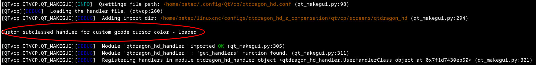

20 Apr 2024 16:41 #298750
by CADdy
Replied by CADdy on topic changing color from cursor in g-code editor
- CADdy
- Posts: 80
- Thank you received: 6
20 Apr 2024 17:17 #298752
by CADdy
One more question: The existing file is 71 kb in size (I renamed it), the new file from you is much smaller. Does the missing content not matter?
Peter
Peter
