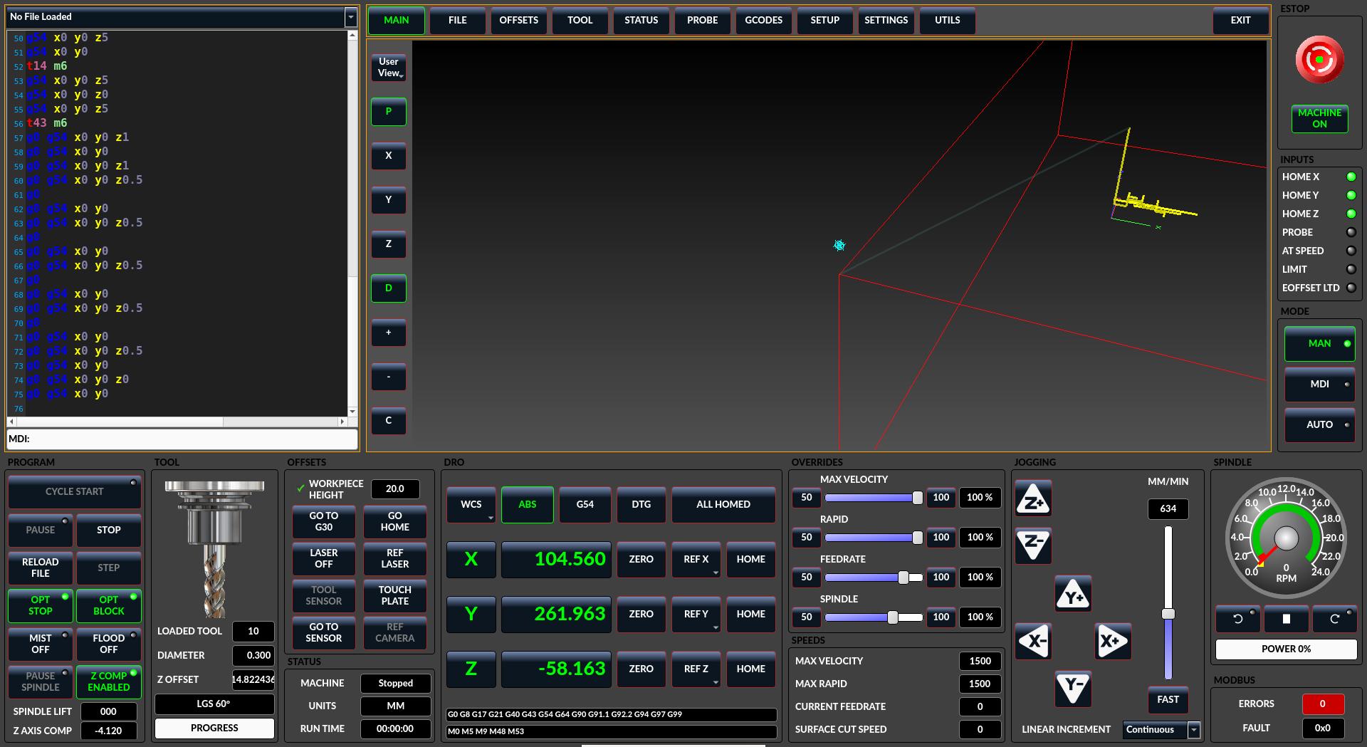

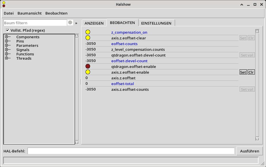

26 Apr 2024 11:33 #299124
by KlausB
Replied by KlausB on topic z_level_compensation
You are great - Thanks a lot.
I don't get the error any more.
The calculated offset is shown in the GUI (QtDragon_hd), depending on the position of the spindel.
But there mus be a nother mistake in my HAL file perhaps, because the offset has no affect to my Z-axis yet.
There is a indicator "EOFFSET LTD" should it be enabled?
I made two Screenshots, perhaps you have an idea whats wrong in my config.
- Posts: 7368
- Thank you received: 2182
27 Apr 2024 01:17 - 27 Apr 2024 01:18 #299169
Replied by cmorley on topic z_level_compensation
I am sorry for all the trouble - there is another bug.
I think I have it fixed - maybe you could test for me.
Put this file in YOUR_CONFIGURATION_FOLDER/qtvcp/screen/qtdragon_hd/
name the file qtdragon_hd_handler.py
If there is a problem your can remove the file and qtdragon_hd will load the default screen again.
Please stick with it - we will get this working.
Chris
Chris

29 Apr 2024 13:22 #299331
by KlausB
Hello Chris,
As announced, I tested the modified module today. The Z-axis is now moving. So far, I haven’t noticed any incompatibilities that might be due to a version conflict. Will you coordinate with Bill regarding the change? Will the modifications will be incorporated into a future update?
Thank you very much for your support and the work on this fantastic project.
Klaus
Klaus
