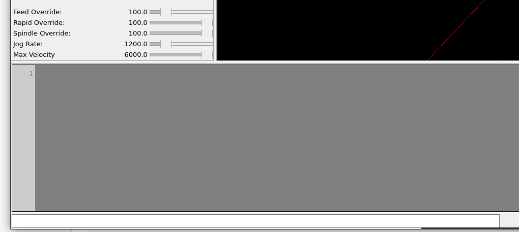

15 May 2024 02:11 #300660
by hachi
Replied by hachi on topic I want to use QTAxis, is it meant to be used?
- hachi
- Posts: 31
- Thank you received: 3

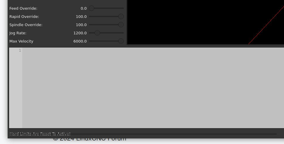

16 May 2024 10:38 #300760
by hachi
Ah, it's a progress bar that is somehow covering messages, I wonder if that's supposed to render under for some reason.
- hachi
- Posts: 31
16 May 2024 10:50 #300761
by hachi
For future readers, a fix for this is qtaxis_handler.py in make_progressbar change addWidget to addPermanentWidget, which will move the progress bar off of the text section of the status bar, and permanently install it in the right side.Ah, it's a progress bar that is somehow covering messages, I wonder if that's supposed to render under for some reason.

16 May 2024 23:35 #300799
Replied by cmorley on topic I want to use QTAxis, is it meant to be used?
The temporary status messages are supposed to override the progressbar.
This was to let the status message have the most length possible.
I don't think it render properly on all systems.
You are missing two signals to make the progress bar work.
one from gcode_editor to self.percentCompleted
one from gcode_graphics to self.percentLoaded
These are added in designer and if you move the wrong things they get disconnected.
I see they are missing from the the 2.9 version too.
I like your changes and will incorporate them shortly.

17 May 2024 20:29 - 19 May 2024 04:32 #300885
by hachi
Thank you for fixing the progress bar.
Can you check on your machine if the progress bar is full width of your screen, because on mine no matter what size I make the window and in all the themes I've tried it only takes up 50% of the width of the status bar.
If that is the case, I would suggest switching it to addPermanentWidget because you won't get any extra space for the progress bar normally, but you can make it so both the status bar text and the progress bar are visible at the same time then.
Or maybe there's something missing in the .qss to define the width of the bar. I dunno.
Thank you for merging my splitter changes.
I've also created github.com/LinuxCNC/linuxcnc/pull/2981 for you, to clean up some print calls in qtaxis_handler.py
Never mind that, you took care of it in master.
