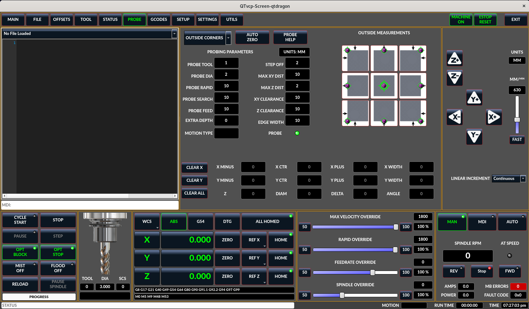

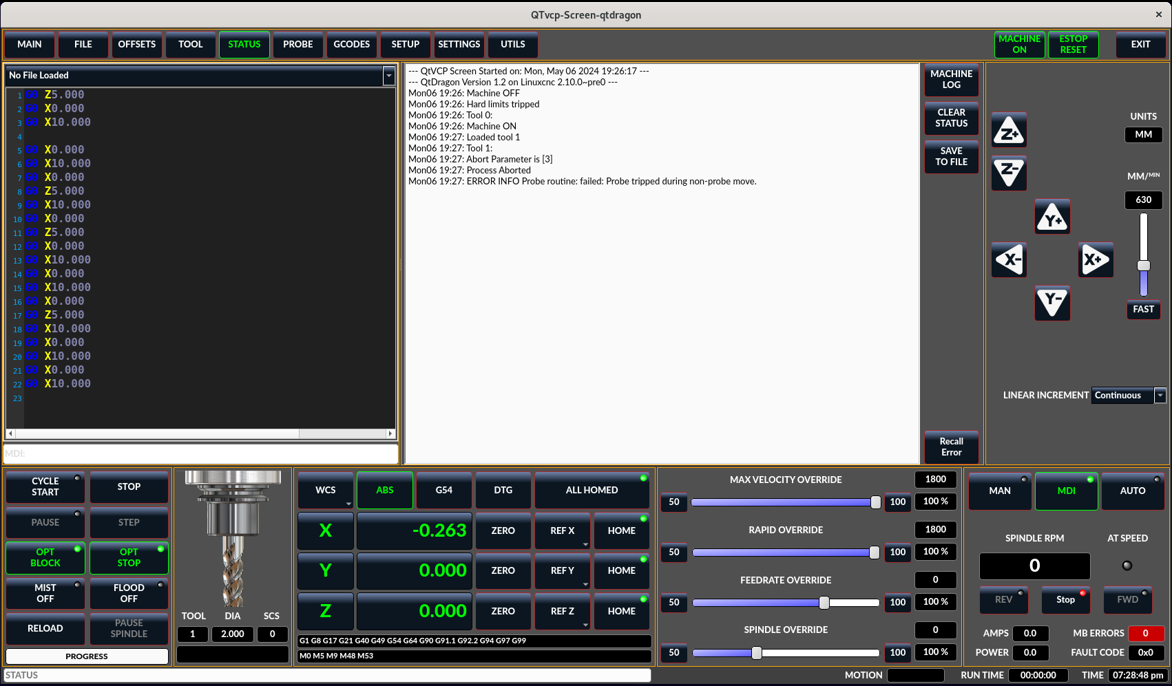

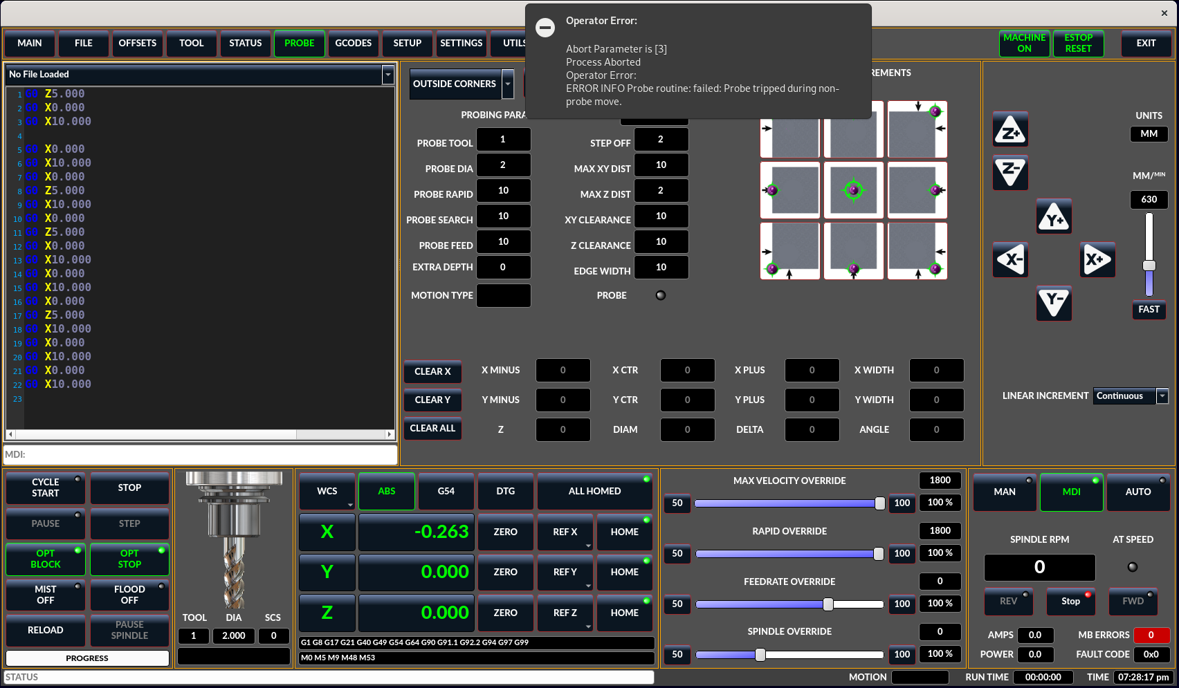

Hello everyone,I'm experiencing a persistent issue with either BasicProbe or VersaProbe when running probe routines. Here’s a detailed description of the problem and what I've tried so far:Error Message:
- "ERROR INFO: Probe routine failed - Probe tripped during non-probe move."
- The issue arises when I activate a probe routine. Initially, the axis starts moving as expected. However, as soon as the probe is activated, the routine stops and throws the error message noted above.
- Added debounce to the probe input — no change.
- Increased debounce time to 1 second (1S) — still facing the same issue.
- The motors are moving in the opposite direction to what is expected when the probe routines are running.
- Posts: 7368
- Thank you received: 2181
06 May 2024 20:46 #299988
Replied by cmorley on topic Qtdragon ERROR INFO Probe routine: failed: Probe tripped during non-probe move.
See the label 'motion type' in the probe tab?
See if it says 'Probe' when the probe trips.
If it says 'feed' then it's not expecting a probe trip.

Replied by MKNI on topic Qtdragon ERROR INFO Probe routine: failed: Probe tripped during non-probe move.
Thanks cmorley, that was the problem. in combination with my feed being too slow, so it made timeout before ever going into probing.
