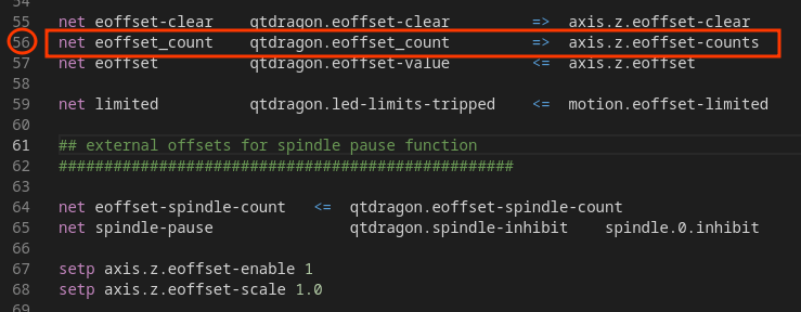

QtDragon_hd failed to start due to an error in qtdragon_hd_postgui.hal
- CADdy
- Posts: 80
- Thank you received: 6
07 Jun 2024 14:52 - 07 Jun 2024 14:56 #302557
by CADdy
QtDragon_hd failed to start due to an error in qtdragon_hd_postgui.hal was created by CADdy

Replied by Aciera on topic QtDragon_hd failed to start due to an error in qtdragon_hd_postgui.hal
You have 'qtdragon.eoffset_count' instead of 'qtdragon.eoffset-count'.
Note the underscore _ instead of the required hyphen -

Replied by CADdy on topic QtDragon_hd failed to start due to an error in qtdragon_hd_postgui.hal
oh sh...t, you are right!
I need new glasses, thanks a lot!
Peter
